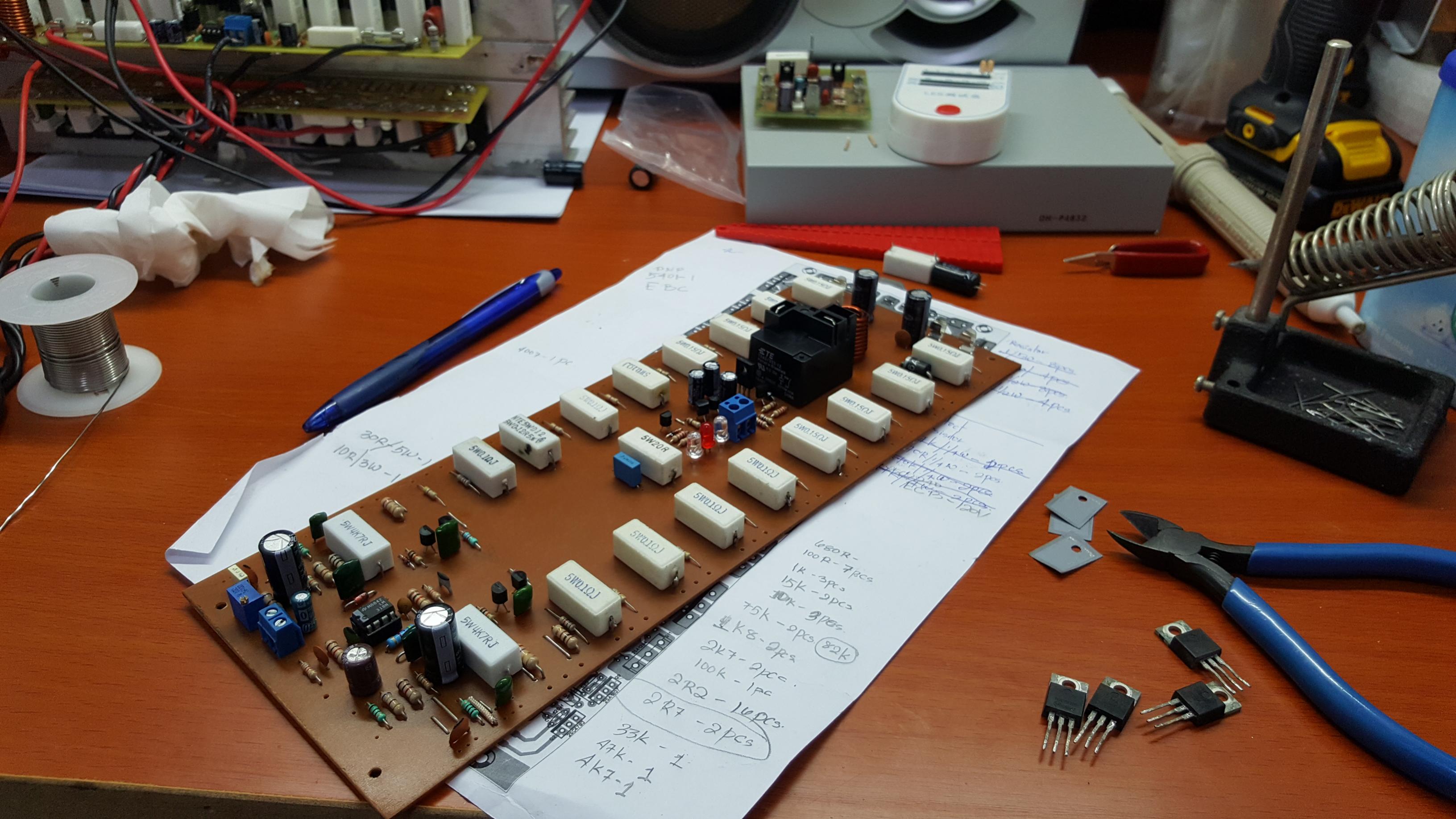

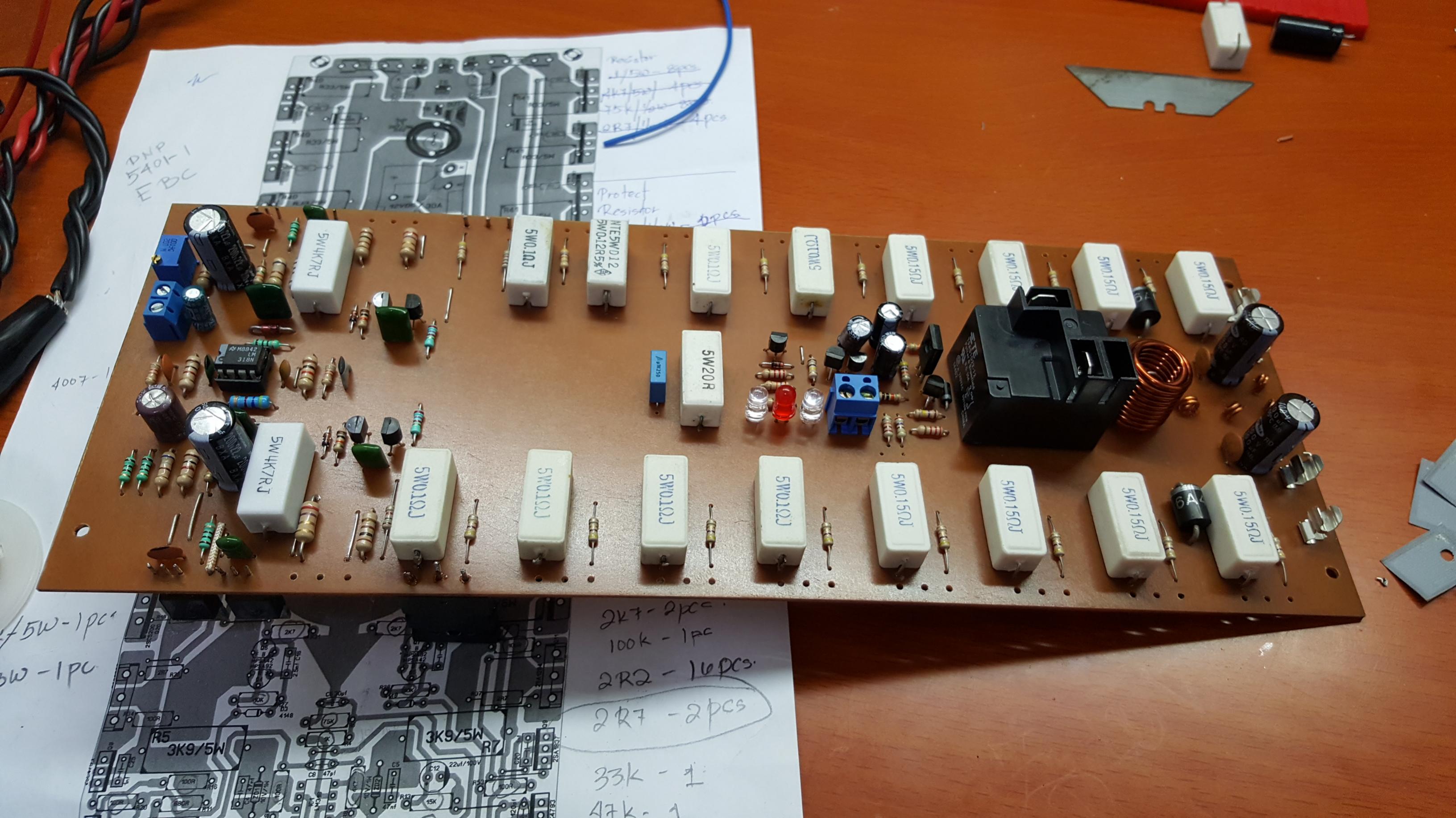

Hi Chris,
Thanks a lot for the quick response, I made this amp in my own design base on the orig. schematic on the service manual (attached pic.).
The amp. is singing with the light bulb tricks installed but when I plug direct it blows out the output.
I understand the I need to get the proper biasing on this to stabilize the amp. Since the manual did not show the closer resistor value (for R22 & R24) as a starting point then it's a bit tricky to guess.
Hope someone can give a hints the closer resistor value, TIA..

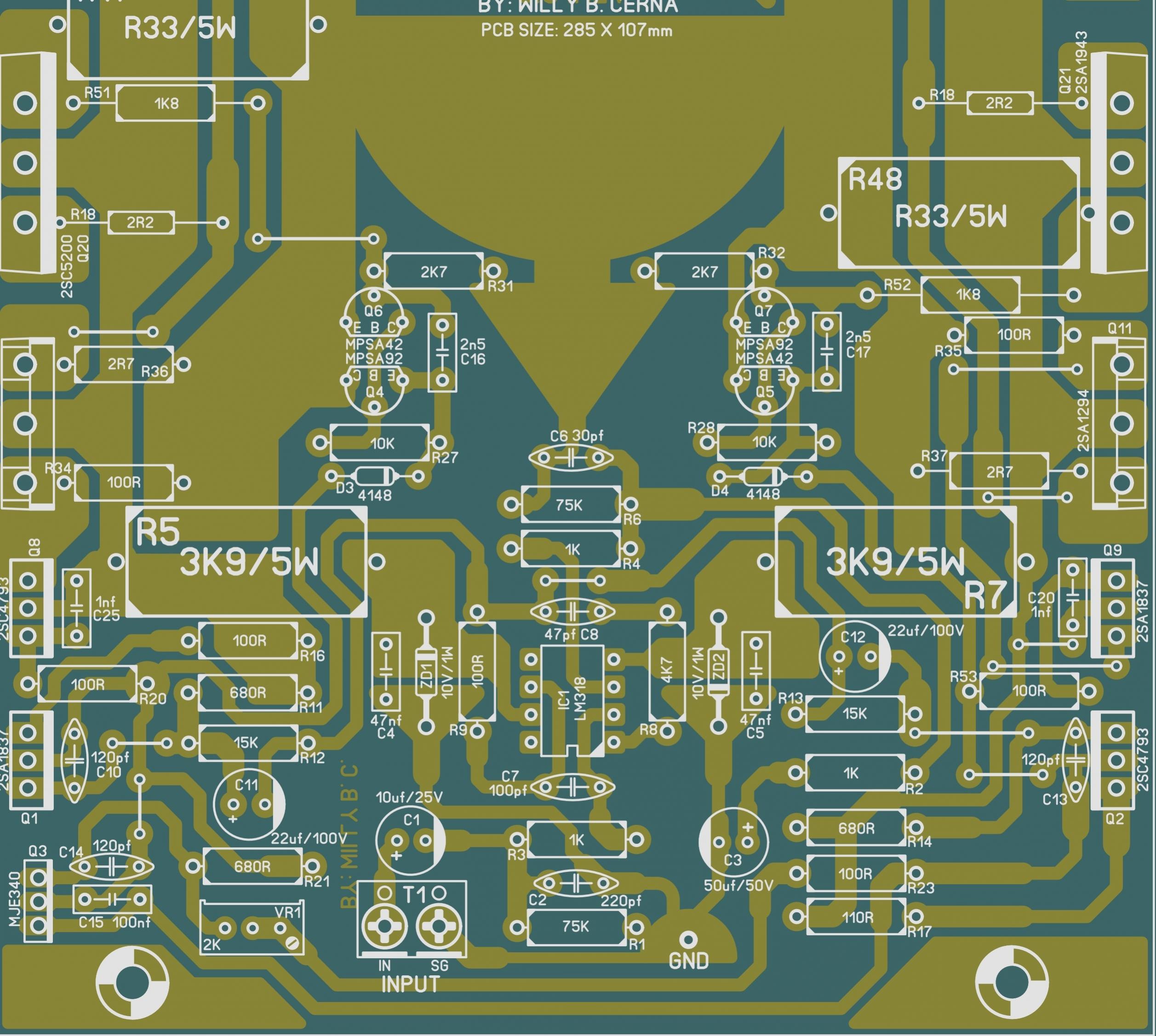

Hi I admire your project, however it needs to have HOMETAXIAL output devices in the output stages to work as designed. The output parts were TO3 2N3773 / 2N6609. I think that you used newer parts and the Ft are not below 3-4 mHz. Today's devices are 20 mHz and the layout and compensation must be part of your new design.
The AMPLIFIER is unstable and high freq oscillation is destroying the parts when high power is applied.
The adjustments for DC OFFSET or LM318 for +/- 100mv, no signal
Look @ VAS emitter resistors 100 ohm and 110 ohm. The 110 ohm is fugged with 1-3k for the adjustment
The BIAS of 340mv is the Vbe stage and I don't remember this resistor range. It should be 500 ohm range?

Hi Duke,
Many thanks for a very useful and important info.
I got now the exact resistor value to make it almost +/- 36mV on pin #6 of LM318 (0V was the target as per manual).
Problem solve!😉😉 and the amp. is now singing nicely and Happy..

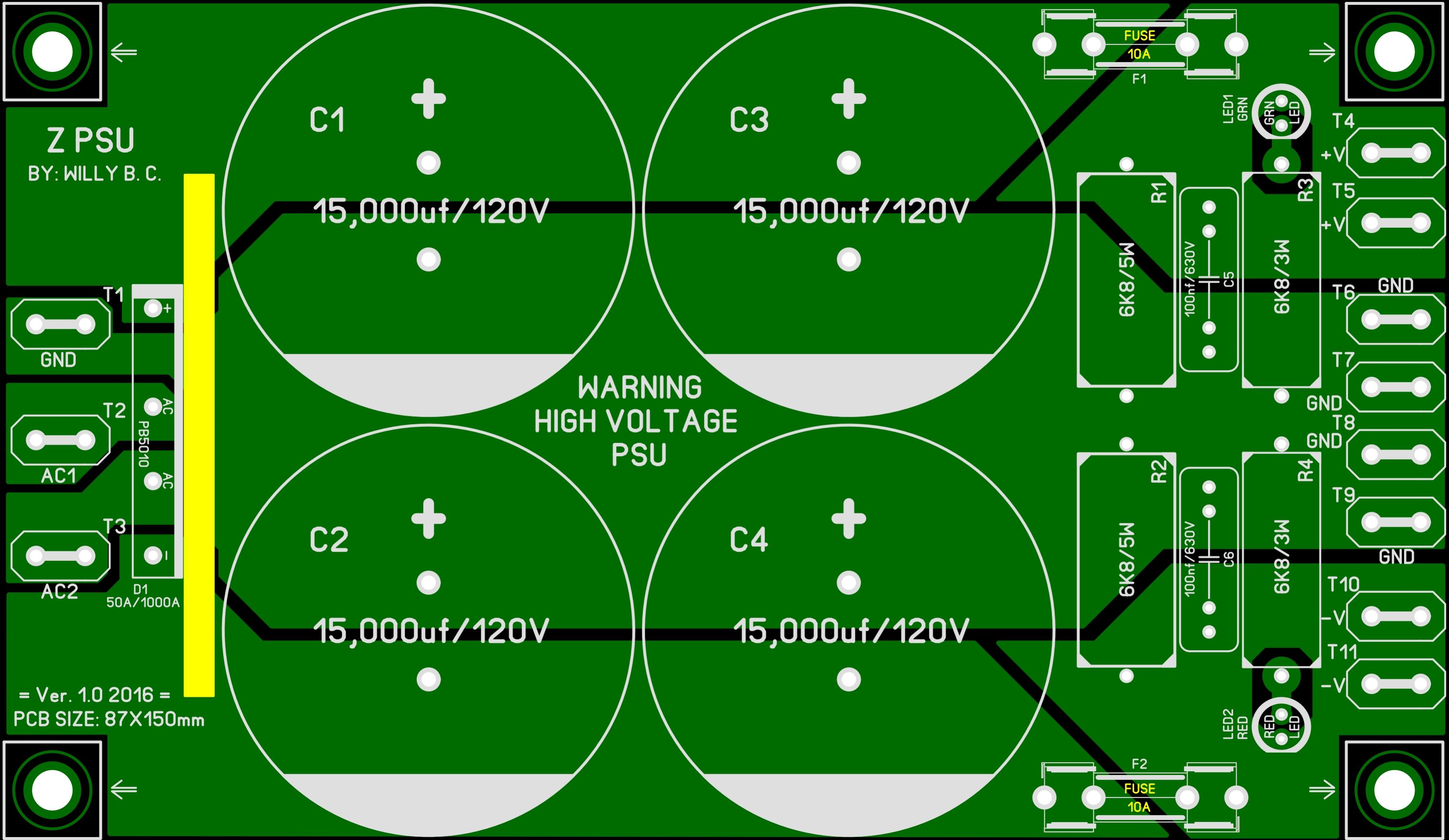

wiljj78, that looks like a nice project, worthy of its own thread. Now let us see the power supply 🙂

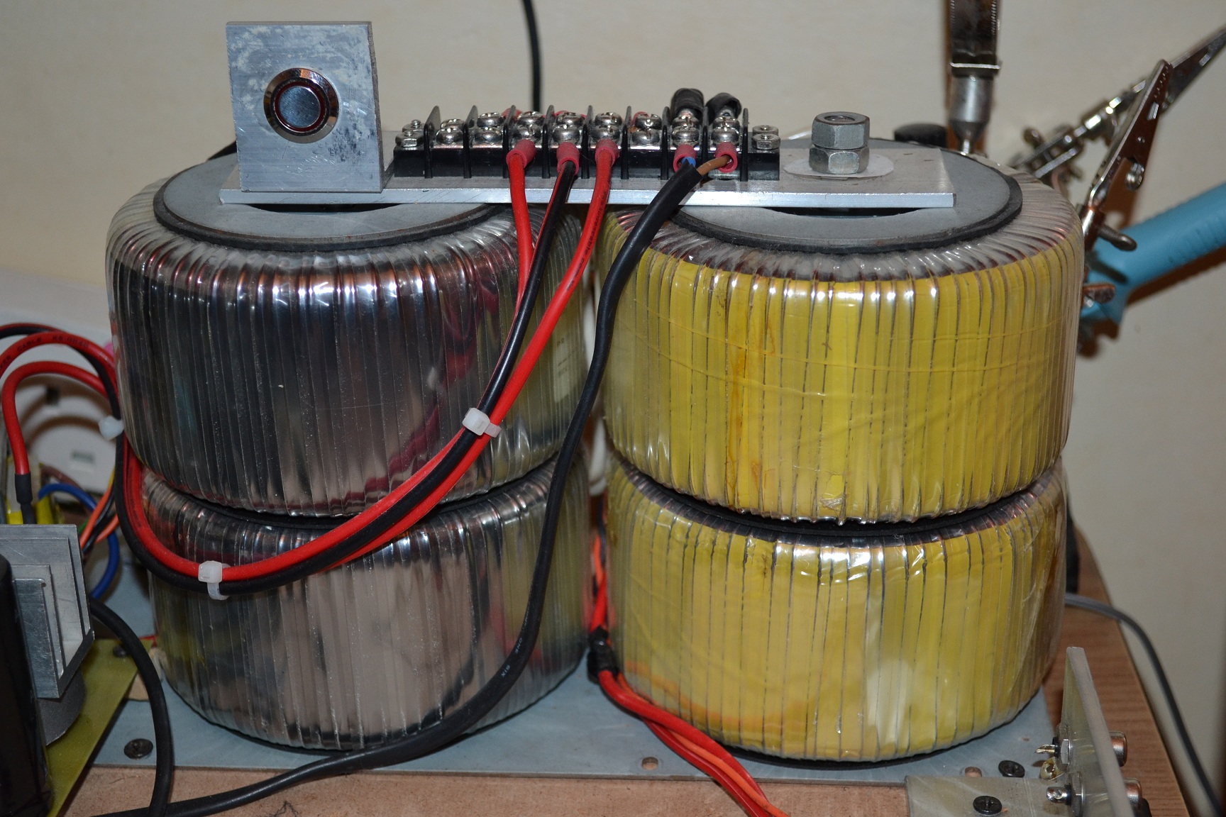

Hi wiljj78
Your mounting of the toroid's may lead to a problem. The INSULATION under the hex nut could fail if it is Teflon. Teflon cold flows and gets thinner with time as it loaded. This will make a SHORTED TURN and blow the primary fuse. Make sure that will not happen, use a thick fiber washer.
Duke🙂
Duke🙂

Hi Duke,
You are absolutely right and I really appreciate your precaution/comments to avoid issues, i knew the torroid picture is a mind catcher the way how its being mounted and i only used the photo for torroid reference of my current PSU on my workbench.
Infact it gives me a lot of trouble, good experience and knowledge to avoid those in future..but light bulb tricks helps me a lot to correct my mistake and solve this issue.

Hi Chris,
Thanks a lot.. another useful tips for me.
Today i need to do some more test on the amp.. trying to play oround with it late last night till i finally set the offset and bias.
before i made the layout board i simulated the schematic using Mutlisim 14 and it gives me about 0.001 THD but offcoarse it is not 100% accurate compare to real world.
Soon will try to hook that amp on my scope and will see how this amp perform..
