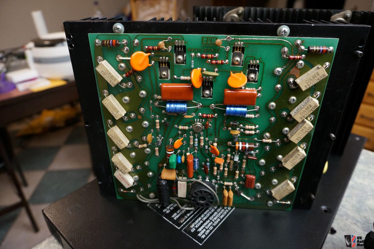

I have included pictures of the output transistors for each amp module in my post. The amp in question has Motorola transistors (BGW part numbers sj7394/sj7407) BUT, 2 NPNs must have been replaced at some point with RCA types. From what you say, given this mismatch I certainly must in fact replace the outputs, but I will not need to worry about frequency compensation as my amp was not built with Homotaxials?
I can go ahead and replace with modern matched equivalents?
As far as I can tell I could replace with 2n3773 and 2n6609 or more modern MJ21195G and MJ21196G?
J.
I can’t get the pics to load, so I haven’t been able to see. If the “mismatched” RCA’s are on the driver position, it won’t hurt anything. Drivers don’t need to be the amp as the outputs - it’s just easier to make them the same if you are replacing them. All outputs in a parallel bank need to be the same type, that’s all. That and both + and - output banks need to be all epitaxial or all hometaxial. A speed mismatch could be a problem.
If using modern types, use 21193/4, 21195/6, or 15024/15025. If you run 3773/6609 or 15003/4, you will be running them slightly beyond their Vceo rating. Not that it can’t be done, but you must pre-screen them. Manufacturers did in the old days. Original Motorola/ON 6609’s are no more. I have limited old stock, reserved for when an exact replacement is desired. I’ve also used MOSPEC 2N6609’s and had no problems with them. But I’ve only used them up to +/-60 volt rails - I have no experience pushing them to +/-84 like I have original Moto’s. They measure exactly like an MJ15004. And so do the last batch of 1990 date code Moto 6609’s (which measure a LOT different from 1980 Moto 6609’s). I suspect they are all the same part.
It is a myth that frequency compensation needs adjustment when you replace outputs with faster ones. Loop stability is generally better when the non-dominant poles are pushed higher in frequency, which is what faster outputs do. It’s going the other way (outputs too slow) when you risk loop stability problems. You can develop local instabilities if you use very fast outputs (ie, 30 MHz, with a layout suitable for 4 MHz devices) but those are almost always cured by adding (or increasing) the base stopper resistors or better supply decoupling. You can’t buy a 30 MHz TO-3 anymore anyway. At least not real one - if you get a fake you’ll get a 2N3055 die which isn’t very fast.

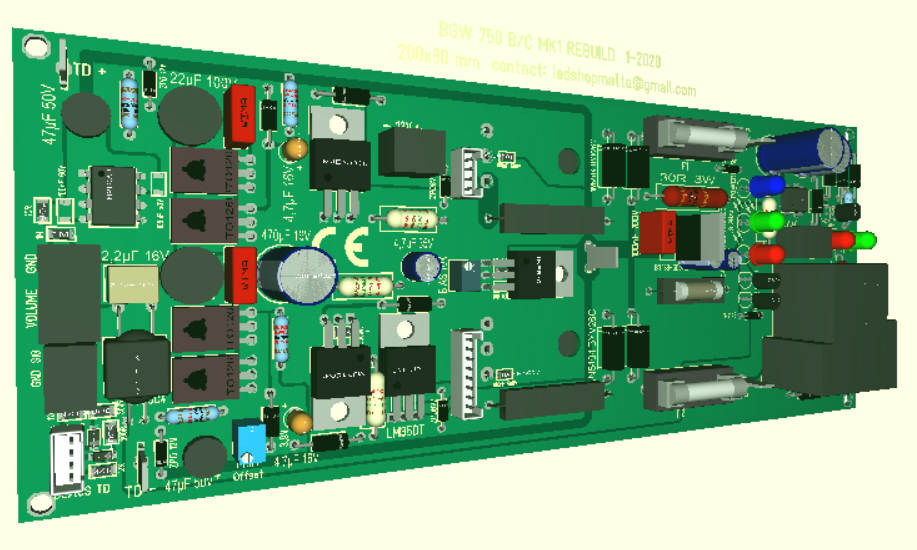

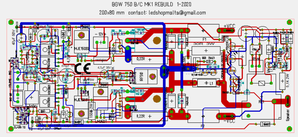

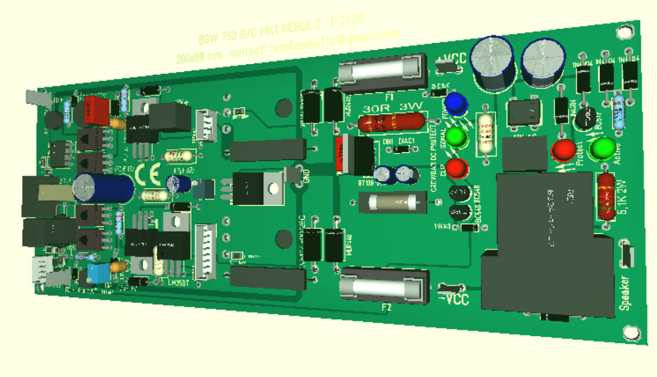

For my DSP Board I need for 8 Channel 8 x 750B output Module, its not available to buy
In this case I have copy 750B output Module with small improvements
I have design PCB, 200mm x 80mm, all in one (TRIAC Crowbar DC Protect - Clip Limiter - DISPLAY - Relais Turn ON Delay / OFF )
scalable output power from 50 to 2000W, most of the semiconductor are SMD
Big output power have more output Devices and PCB is larger
If somebody like it to build contact me
BGW 750 B/C MK1 rebuild 200 x 80 mm - Switching Power Mosfet Output Devices
The Output stage using UNIFET Mosfets FDA69N25 v/s TO3 BJTs in Original design
2 pair UNIFET Mosfets FDA69N25 250V - 69A - 480W
rugged, cheap, reliable
Price: EUR 3,29 pcs.
and can do same Job, with huge improvement clarity in Sound (Mid and Highs)
v/s 6 pair RCA/2SJ MJ15024/25 TO3 BJT in 750 B/C
Price: EUR 6,33 pcs.
I want try to add soon Class TD, development help is welcome
also I share my Gerber PCB Files for all who are interested.
In todays time to order PCB from Factory (pcbway.com or jlcpcb.com)
cost 5 USD from China + shipping cost
