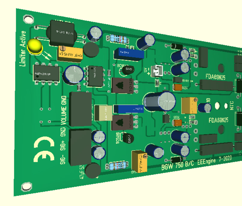

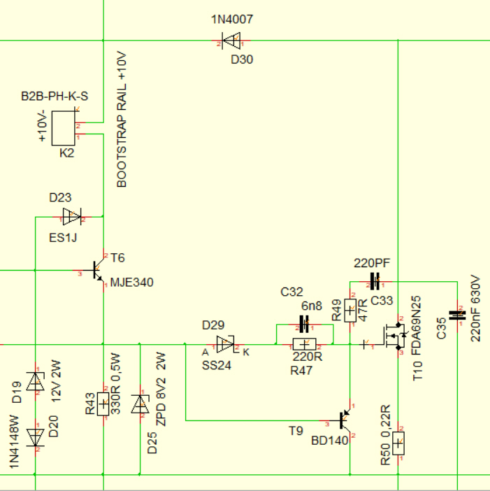

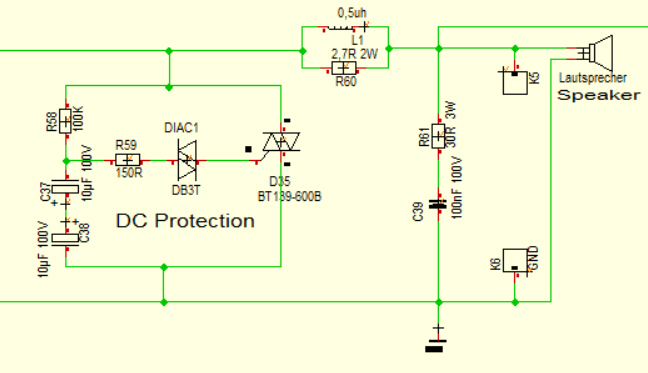

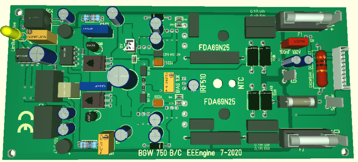

We had same Problem in Club installation trough the heat,
transsistor have end of live.
Replace Transistors, LM318 and amp will working again years of trouble free
Habe a look: BGW 750 B redesign 80x180 same circuit with LM318
but with improvements
XLR Differential Input with Clip Limiter
Short Circuit protection,
Cascoded Second stage
Turn on Delay / OFF without Relay - no turn on/off thumps
topology comes from Class D UcD circuit
DC Protection (Triac Crowbar)
Switching Rails Class EEEngine prepared

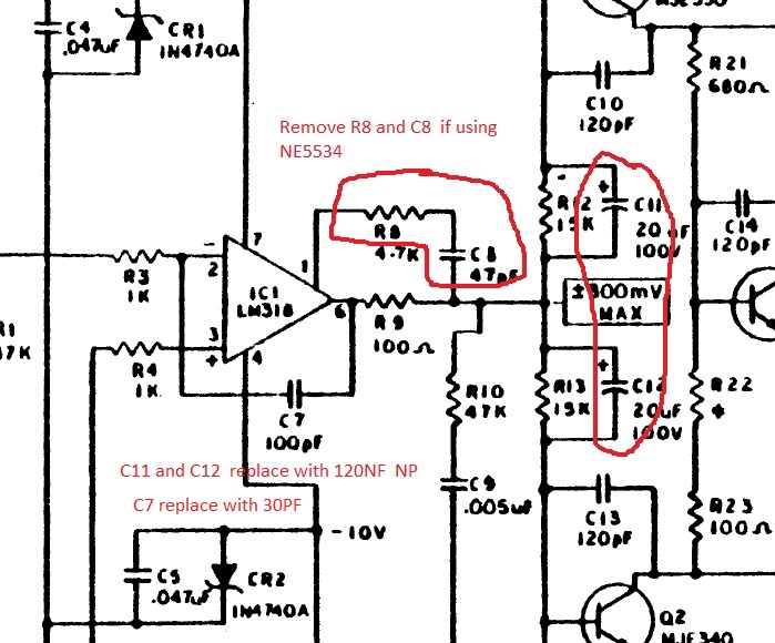

replace LM318,
1 x BGW Model 750B
1 x BGW Model 100
LM318 failed after many years trouble free working

1.
2 pcs. big long blue Capacitor 20uf you can replace with 120nf
replace C7 from 100pf to 30pf
improvement in sound, you will fet clarity in mid / highs
2. replace all MJE transistor and LM318
ypu can also substitute LM318 with NE5534a add 10PF parallel look picture
but you need to remove from Pin1 LM318 overcompensation resistor and capacitor
look attachment BGW 750B schematic
3. you cant do more to get clarity, because output devices are to slow.
with modern todays devices you will get High End amplifier but be careful because they are very fast, you need to compensate to avoid oscillation
I have redesigned BGW 750B
Quasi complementary output stage using FDA69N25 Mosfets
and add Triac Crowbar DC Protect
2 pair FDA69N25 Mosfets sufficient v/s previous 6 pair TO3 Bjts
Sound is incredible in Full range v/s old slow Bjts from the 70s

Hello Nmos,
you mean add in parallel 2 non-polarized 100nf capacitor on the 2 20uf capacitor.
my new output transistors will be MJ15024 / 25, I ordered them.
replace C7 from 100pf to 30pf :what does this bring? sorry I am not an electronics engineer ?
Best regards, Phil
Best regards, Phil
you had to redo all the printed circuit to use this type of transistors,
if it works even better, congratulations.
Phil
Yes I did it already at 1st Covid-19 Lockdown March to May 2020
look #347 previous page
Now we have 3th Covid-19 Lockdown + work ban up to 22th January 2021
only stay home
also Class D Ucd Pro is finished 1500W @ 4 Ohm
BGW 750B redesign I did for fun,
because we can use experience and parts from Class D to improve
Step down Buck converter / Class TD is possibile with750B circuit
