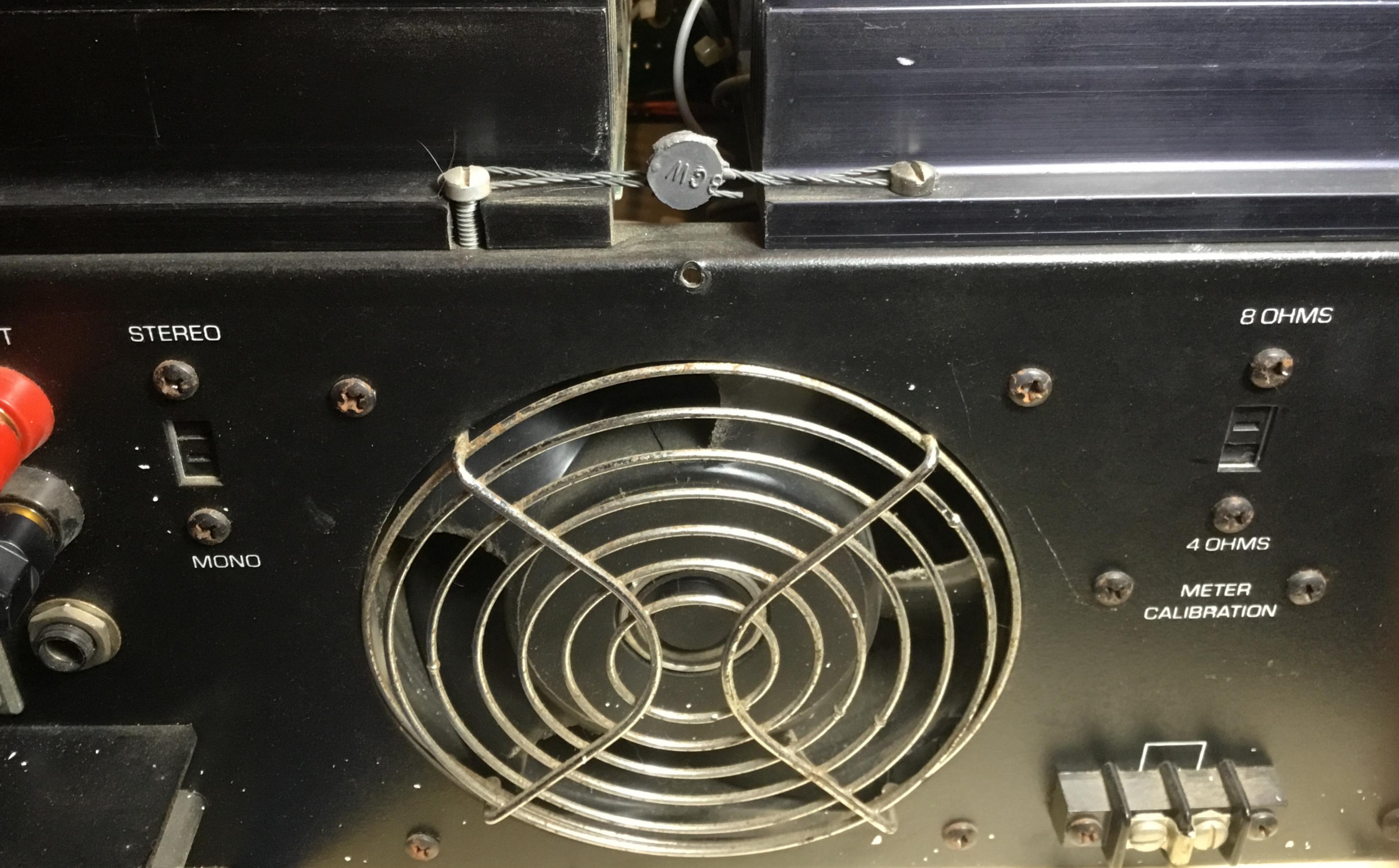

with what did you clean your facade so well not to erase the inscriptions, because mine is a little scratched and black has faded over the years. for the cover of the transistors I will be able to repaint it in black because no problem.

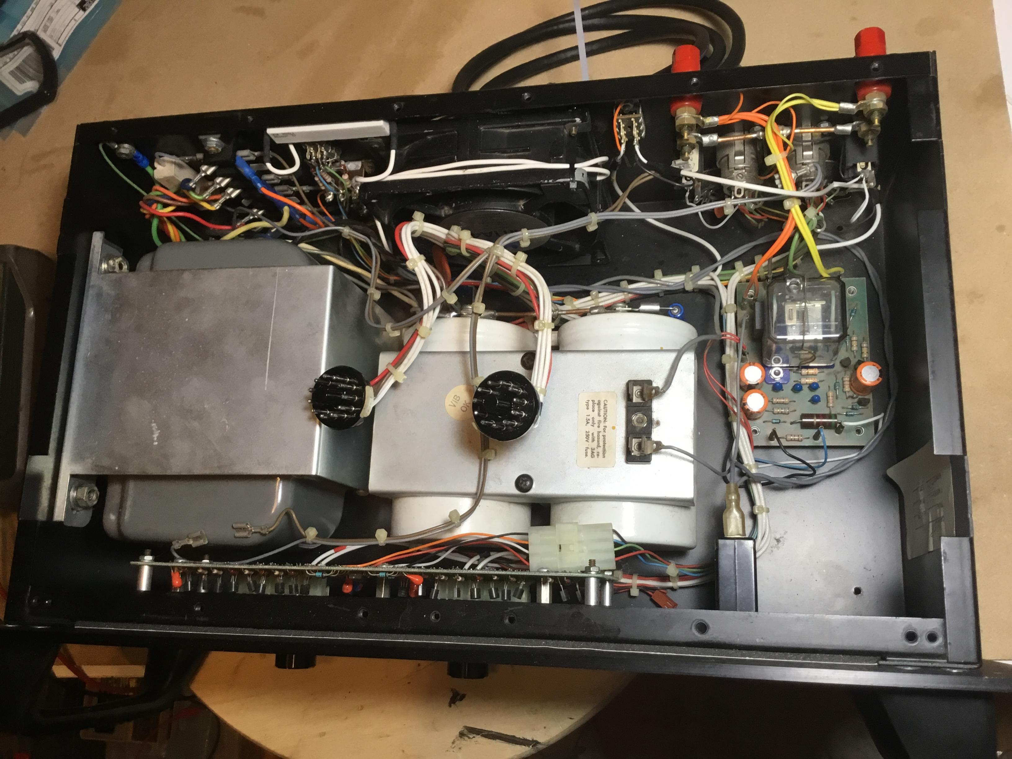

I put a PC fan which consumes 80ma, do you think that I can take the power supply on the 15VDC with a resistive bridge or a regulator without this risking anything? because there is no real information on the characteristics of the outputs of the power supply transformer on the secondary ?
the only thing I see is that it is written 1.5A for 240VAC on the fuse placed on the plate of the supply capacitors. this is the only info I have.
Phil
I used something called a "Magic Eraser" to clean the faceplate, Im not sure if that product is available outside of Canada or not.
Explore Magic Erasers Cleaning Products | Mr Clean(R)
I cleaned the two potentiometers while I was in there. Due to there orientation, the removal of the faceplate was needed to have good access to the undersides of the pots. Removing the faceplate is no fun at all let me tell you. I would be happy to outline the procedure should you wish to do that.
I also removed the Lexan cover over the meter assembly and cleaned both sides with a car polish.

Judging by the size of the wire alone, I would imagine that the 1.5 amp fused 12vac secondary winding is capable of far more than what the fuse is rated at.
Besides powering the protection circuit board, it provides power for the power-on LED indicator for the BGW "C" models using the same brown terminals found on the clip indicators. You may be able to use that to power the DC fan.

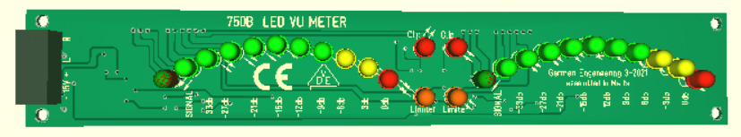

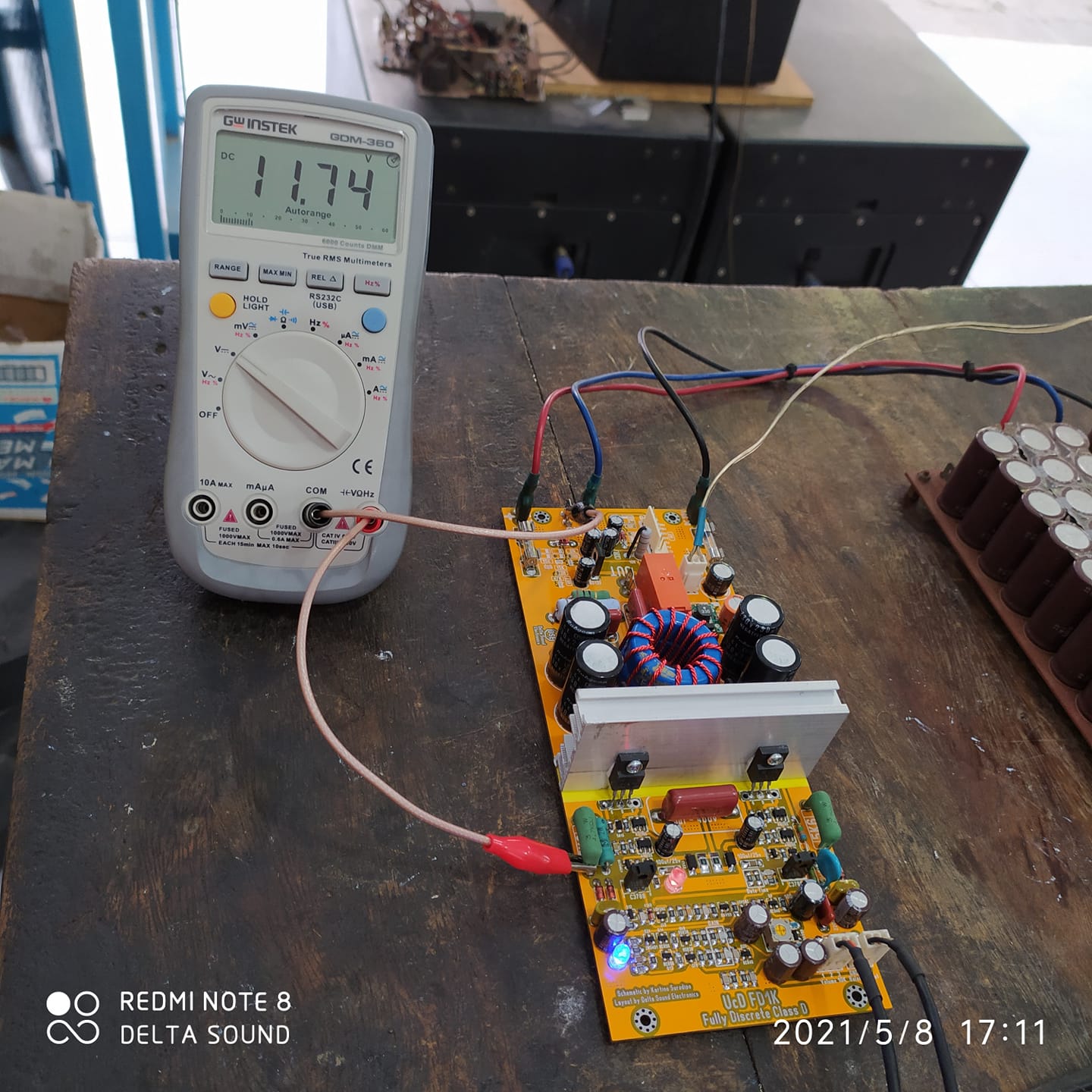

its a great amp design,
have using in my apartment 750B with Infinity kappa and Infinity studio monitor, ypu can feel bass eahrtquake in your bathroom
have rebuild during Covid-19 lockdown 750B VU Meter for Class D
Nice LED boards, are they available for purchase?Gratulation and enjoy

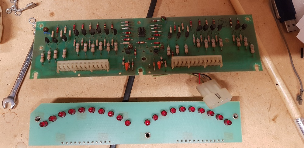

hello Nmos,
as always you realize great CI. is it the same format that can replace the original on the map without having to change anything or are there any connections or other things to do to place it in place of the original one, because the meter view map is in 2 rooms connected by pine trees.
Phil

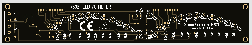

Its Original LED 750B circuit and it will work with all BGW 750 amplifiers, but PCB Board is not plug and play, connectors and size are different.
Original LED 750B is designed to add for DISCRET Class D 1000W 4 Ohm
