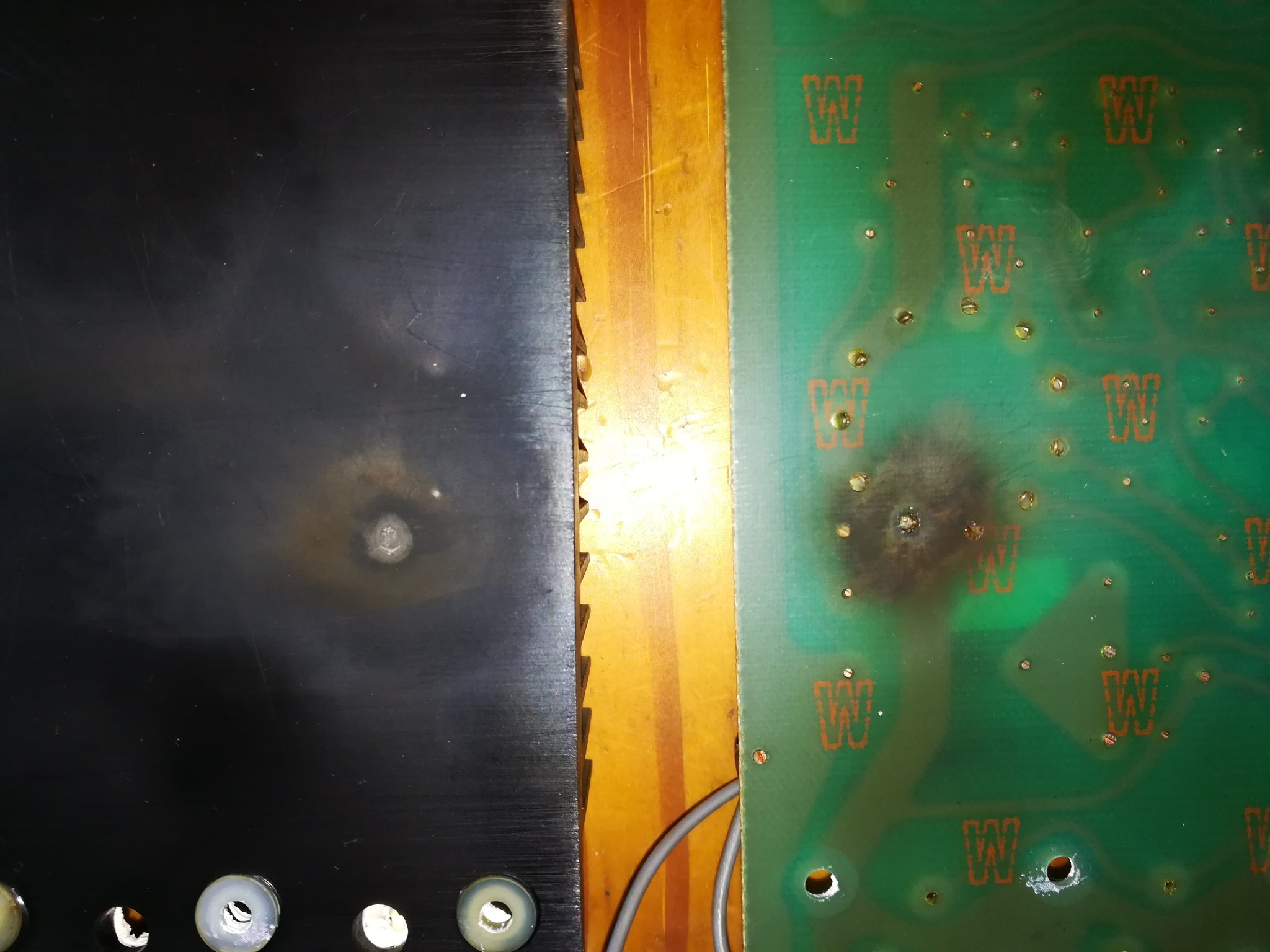

Bonjour,
Quelqu'un a déjà eu ce problème ?
court-circuit entre le refroidisseur et le connecteur.
le +78volts a touché le radiateur.
If it’s just a power rail that shorted it usually won’t do anything to the amplifier portion. It will blow fuses, occasionally the rectifier. Pull it and check it first. Not good for the capacitors but one good spark wont destroy them either. With weird circuits (this isnt one) loss of a rail can upset the front end and damage components due to reverse biasing the B-E junctions, but I’ve never heard of it taking out an output stage. The op amp’s shunt regulators act as clamps that prevent that sort of thing from happening here. Rework the affected solder joint, Put in some insulation material so board flex won’t do it again, and fire it up on a dim bulb. If it comes right up you don’t even need to dig any further.
What to use? A piece of that reddish high temperature cardboard that’s usually used to prevent that sort of thing. I usually have some that’s been salvaged out of something. Any kind of plastic that will remain solid (and not get gooey) at 100C, several layers of kapton tape, even a thin piece of plexiglass. There is usually something around that can be used.
I'll bet somebody pushed too hard on that connector while it was powered up or shortly after turn off. The board is only spaced off of the heatsink by the thickness of those nylon shoulder bushings, not much. Maybe that lead wasn't trim short enough is another possibility. Once you get things sorted out and working if you get a bunch of strange problems that don't make any sense try cleaning and reseating those 11-pin connectors. Been there, done that. Nice amps when correct.
Craig
Good morning,
so short circuit is not a problem.
The power supply is correct (+78v -78v).
many sjxxxx transistors are short circuited on the left channel.
I'll have to check everything.
the right channel was OK but I damaged it while measuring it.
I would like to know if it is possible to operate a channel with a single pair of final transistors?
so as not to break several transistors during testing and adjustments.
If the amplifier was run very hot, or the outputs are over-tightened, it will compress the nylon shoulder washers. I have seen people do this. Replace the washers in that case. Also, if the solder joints on the connector have excess blobs, they could contact the heat sink. You could put some insulation behind the connector.
I think the plug was pushed on with the capacitors charged, perhaps even running (very poor practice!). The anodized heat sink generally doesn't short with light contact, but I would never bet on it.
Use a variac to ramp up the power for testing. You must replace all the outputs even when only one shorts. The drivers and other transistors are soldered from the top and you should be testing all for leakage and gain match before assembling it. Build it properly and bring it up on a variac.
I have had amplifiers come in where the idiot service person just removed the shorted outputs and called the amp repaired. Please just do it right. It is a nice amp.
Yes, any dead output transistor means replace them all. In the affected channel. But it can be RUN on a single pair of expendable outputs (plus drivers), at highish impedance (say 20 ohm) to clear all other problems before committing a good matched set to it. That is one good use for the “survivors”. Good practice is to replace the drivers too, as they could have been overstressed when one of the outputs shorted. And it’s anybodys guess how much overstress they saw.
The channel that just saw the arc to heat sink is probably fine, if it was working before and otherwise undamaged. Just put in SOMETHING to insulate it - and if shoulder washers got squashed they are another risk item that must be addressed.

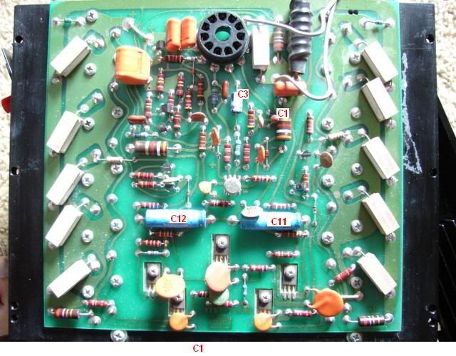

Hi bonesbiggis,
Bypass caps won't help you one bit. They were a fad. What they will do is mess up the PCB, and the next good tech will probably remove them.
The characteristics of the electrolytic capacitor will swamp out whatever you place across it. In a power supply they perform a different function and can help, but not always.
