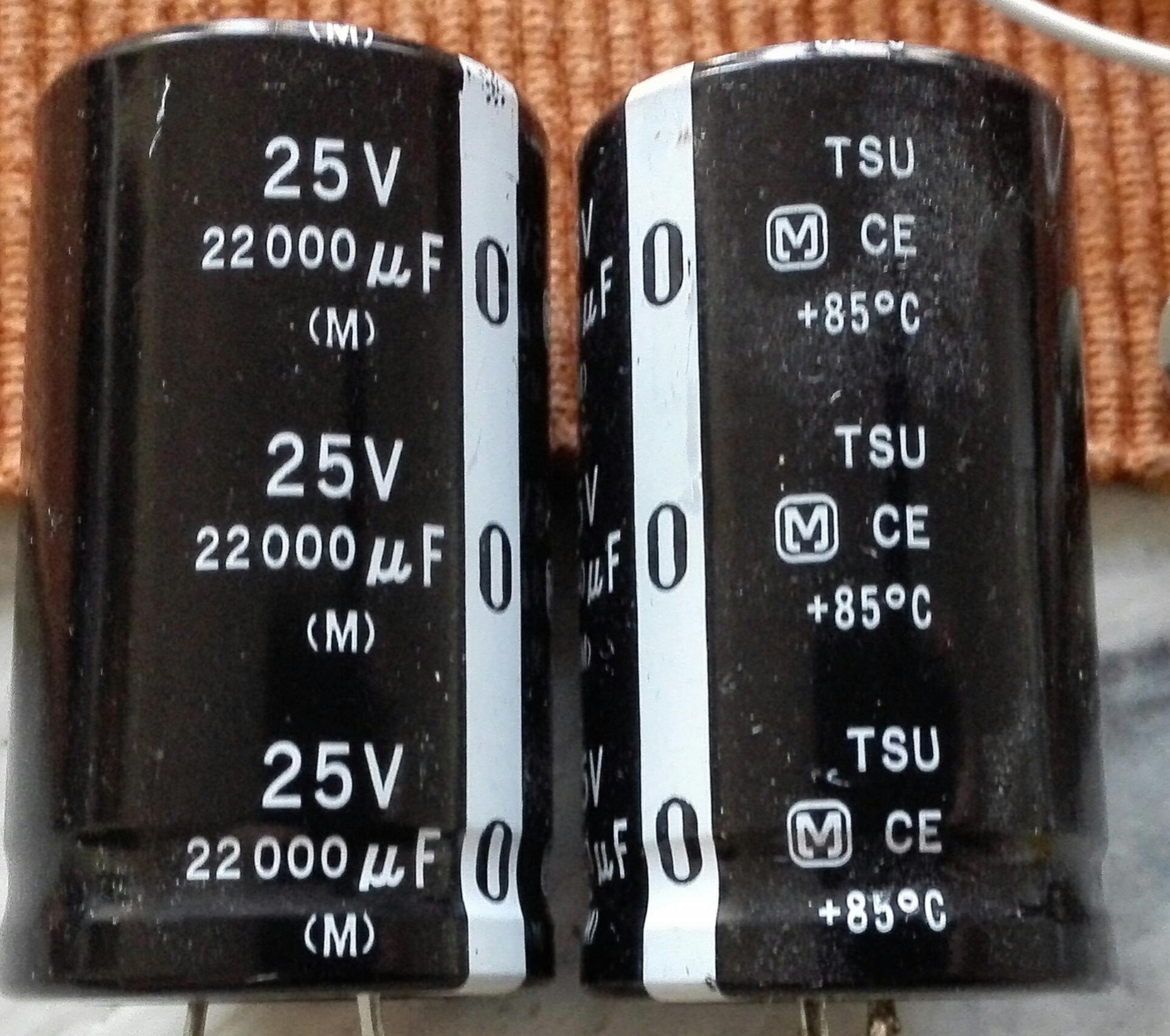

How about a CRCRC filter using these two caps (attached) for the first two caps and a 2200uF for the third? Resistors, I have the choise between 0.1R/5W and 0.22R/5W, that I recall without looking through my parts.
PS being a 19Vdc 3A smps laptop supply.
That would work as I use 2200uF and 0.47R CRCRC and it works well. Put the R on both positive and gnd sides as noise sneaks in on ground side as well.
Thanks, I actually didn't think about the gnd side needing resistors as well.
I tried editing my previous post, but couldn't.
Anyway, will an smps supply be ok with that much capacitance? With the caps I have in mind the total will be 46200uF. Very much overkill but I have the capacitors and I have not found any other use for them (intended as parts to modify a Marantz CD-player with tda1541a.

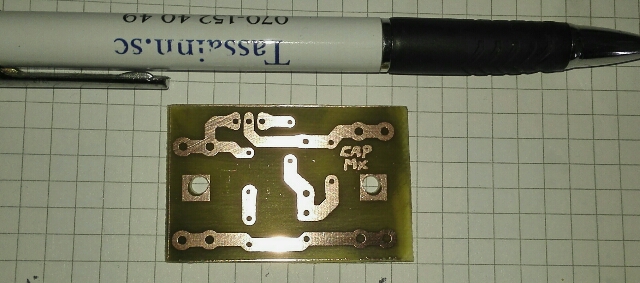

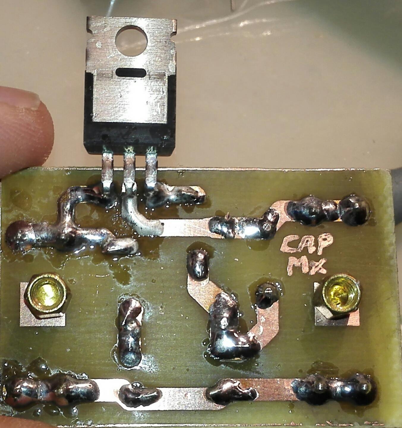

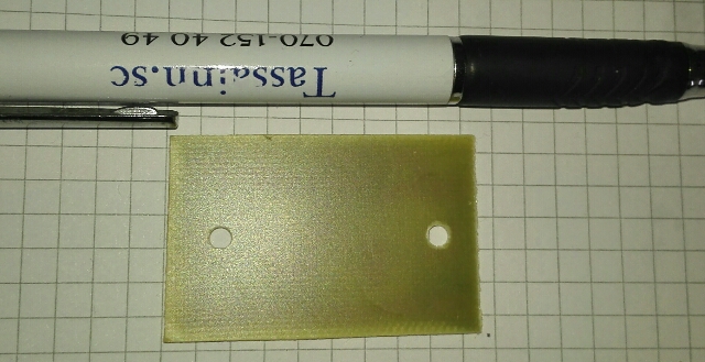

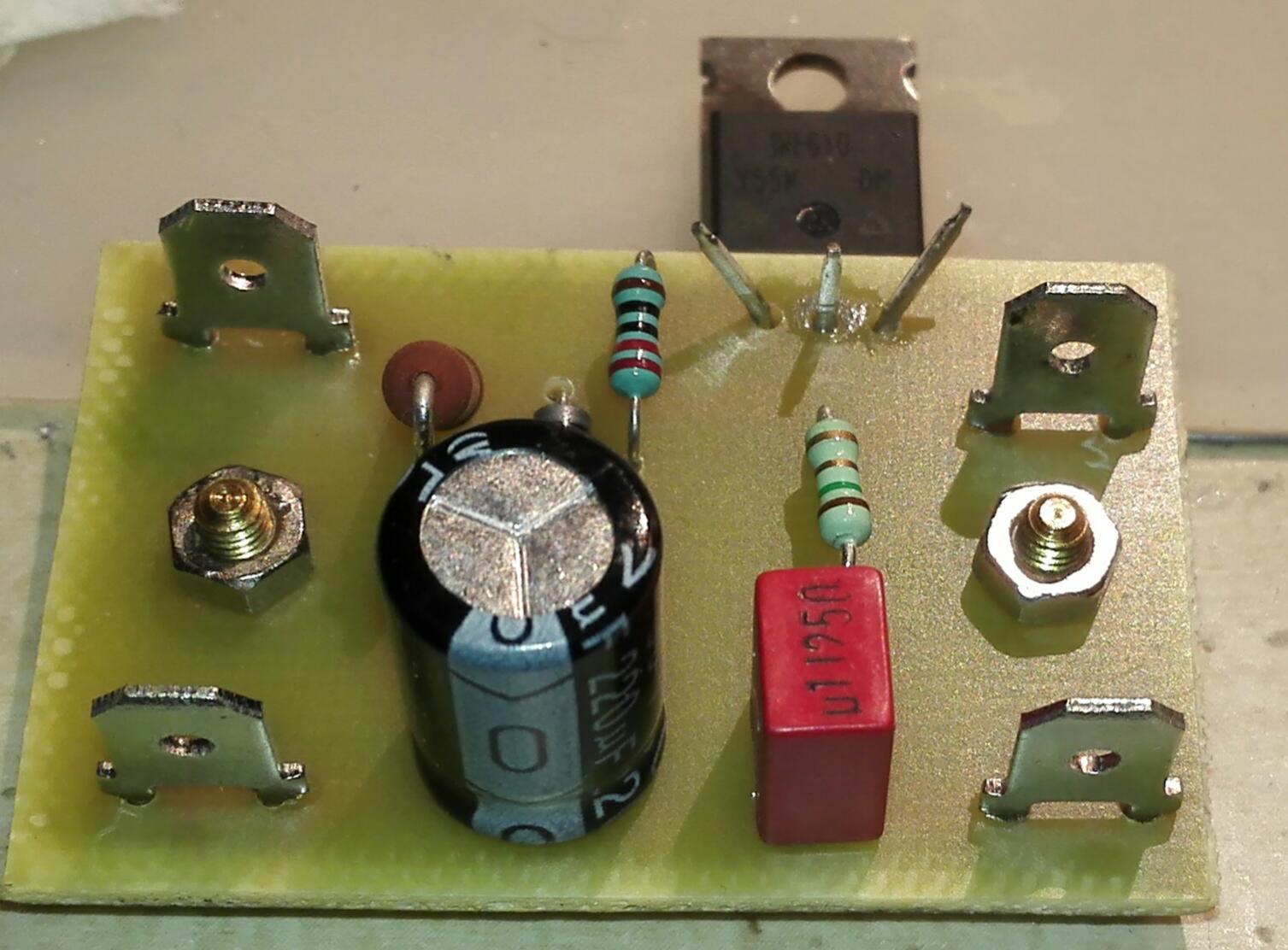

I made a quick layout for the capmx
I figured I'd use the alu enclosure as heatsink for the mosfet.
And yes, I really could use a drillpress as M3 and above without using a centerpunch is not my thing as seen in the pics.
I generally make these with P2P (all secured to the 3 legs of the mosfet as mounted to case). Or veroboard works well too for small IRF610 based ones.
PCB looks good though.

Edit: I noticed my mistake using a 100nF where the schematic called for a 1uF, so I soldered a Wima mkt 1uF under the 100nF MKP.
