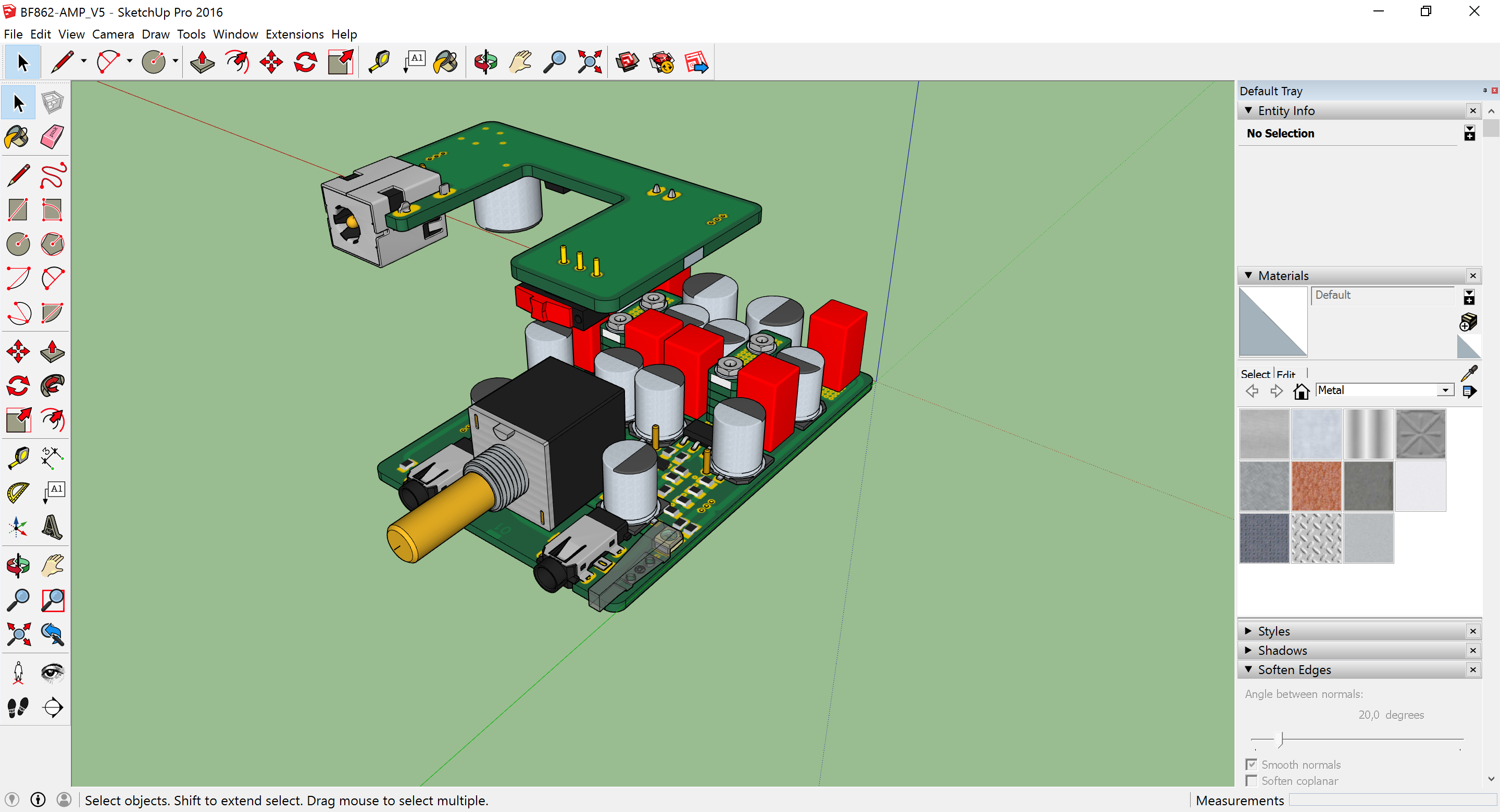

Hi all,
I'm currently in the process of laying out a desktop version of this circuit. X and I need to finalise the power supply design, and then we'll be good to go 🙂.

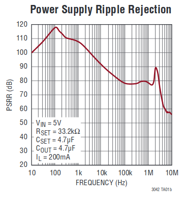

Considering using 19v SMPS to feed a low dropout TPS7A4700 with sub uV noise and -80dB PSRR - with 18v operating point into amp. Should give 115mA bias current which is plenty for most 50ohm phones. Most meaning not HE-6
+1 on TPS7
I've had good success with the sister part, TPS7A33, which is still available in through-hole package. At similar current, a CRC with 2200uF caps and 4.7R resistor feeds about 30mV AC into the part, and my (out of calibration) meter says about 20uV AC on the output. The TI datasheet has a good example circuit.
Lt3042 is superior in the audio range psrr has a Peak around 120db for 200mA.
http://www.linear.com/docs/46159
I saw that one too. Would need one for each channel. Is it happy running at more than half its rating?
LT3042 is nice.
LT3042 is nice.

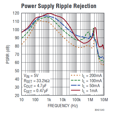

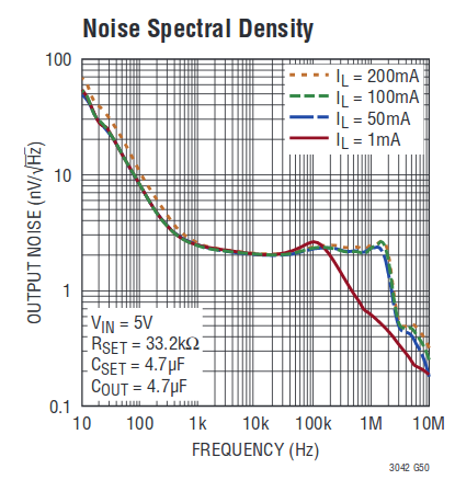

http://cds.linear.com/docs/en/datasheet/3042fa.pdf According to Figures G43/G50 PSRR and noise are getting better with lower current (down to 1 mA).
p.s.: For maximum performance - stability and low noise - you should be careful with C_set both low ESR and low ESL is required.
edit: the "cover" graph TA01b of the datasheet is a bit missleading saying that psrr up to 120db can be achieved with 200mA (G43 vs TA01b Cset 0,47uF vs 4,7uF other parameters are the same).

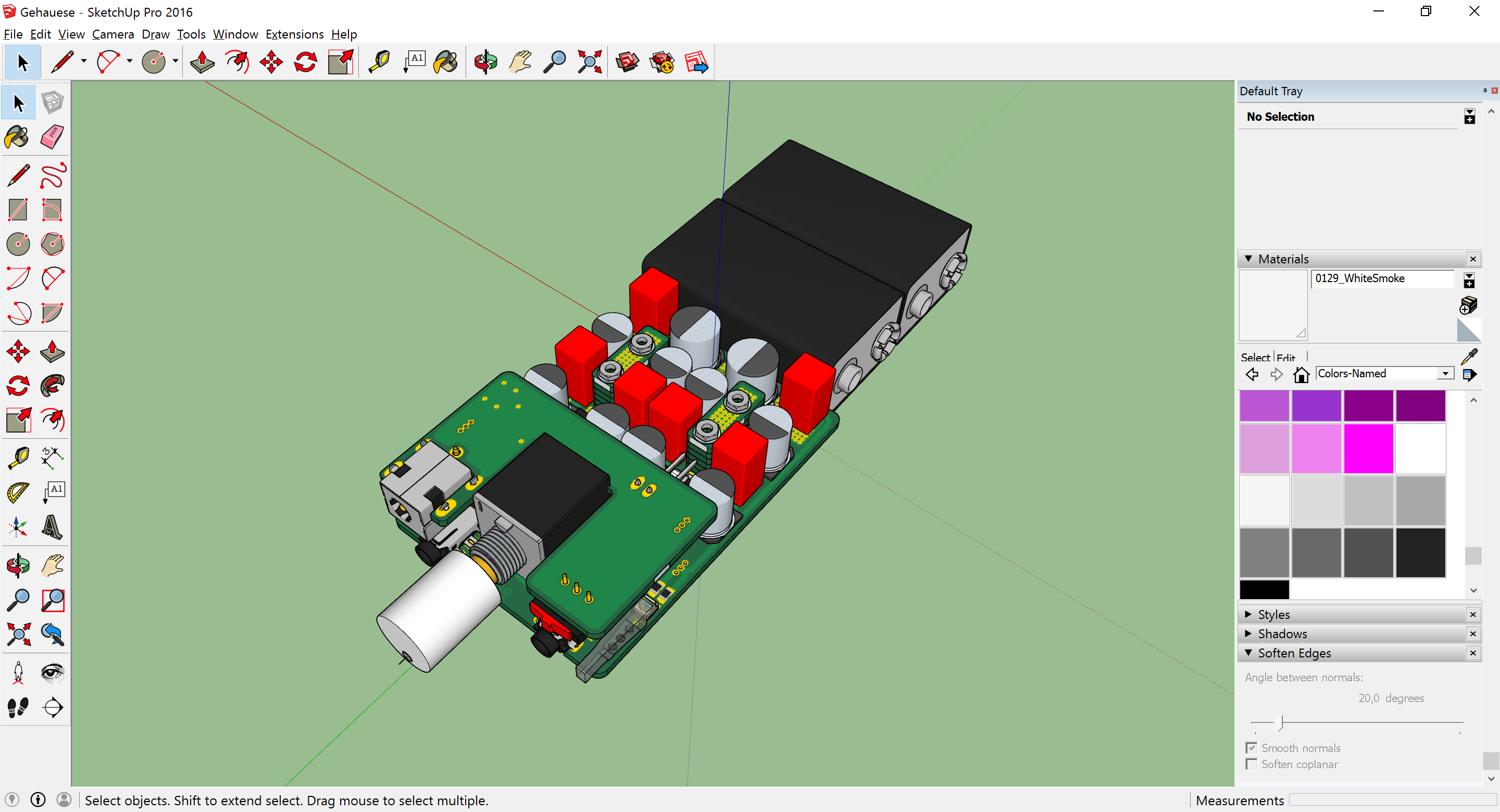

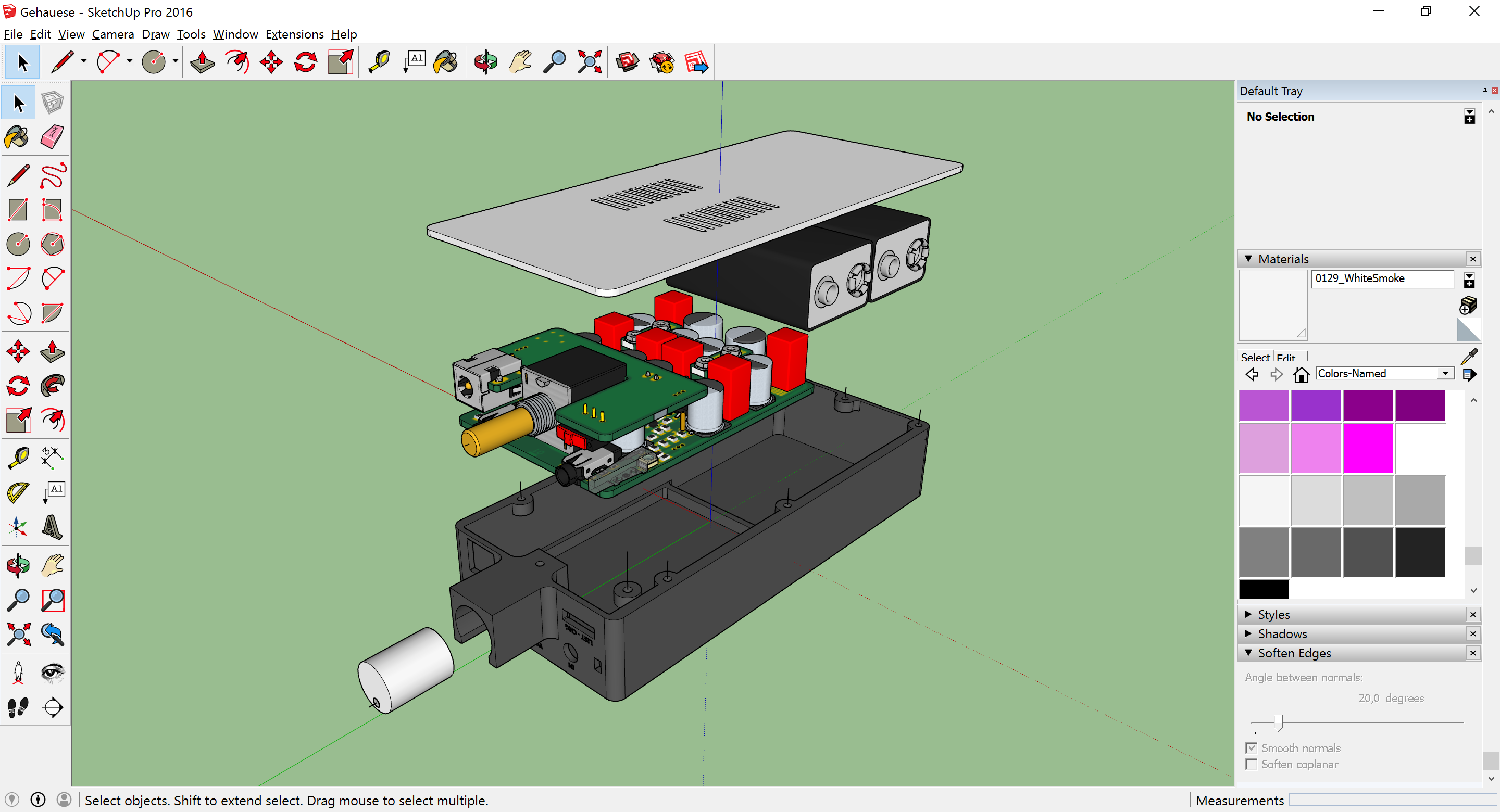

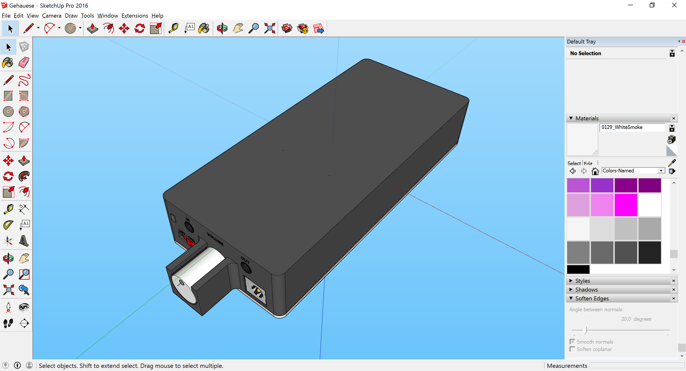

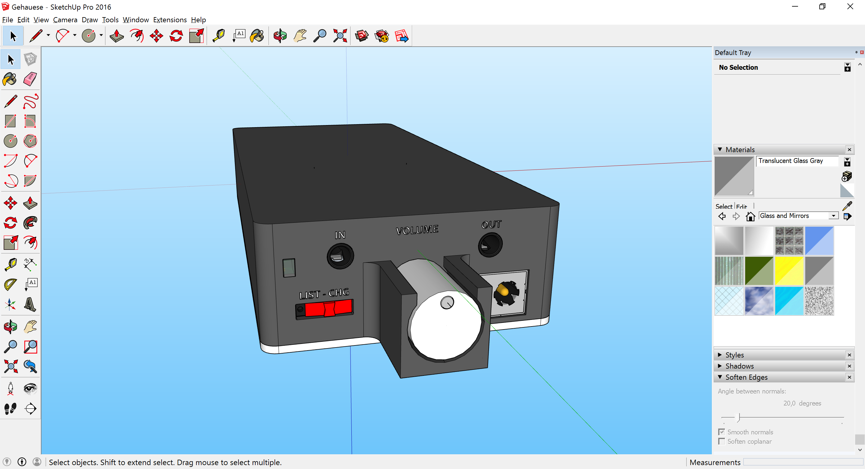

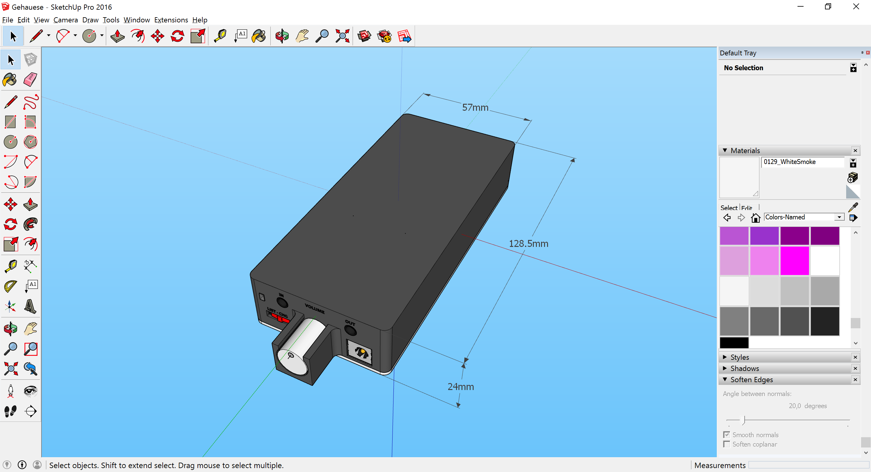

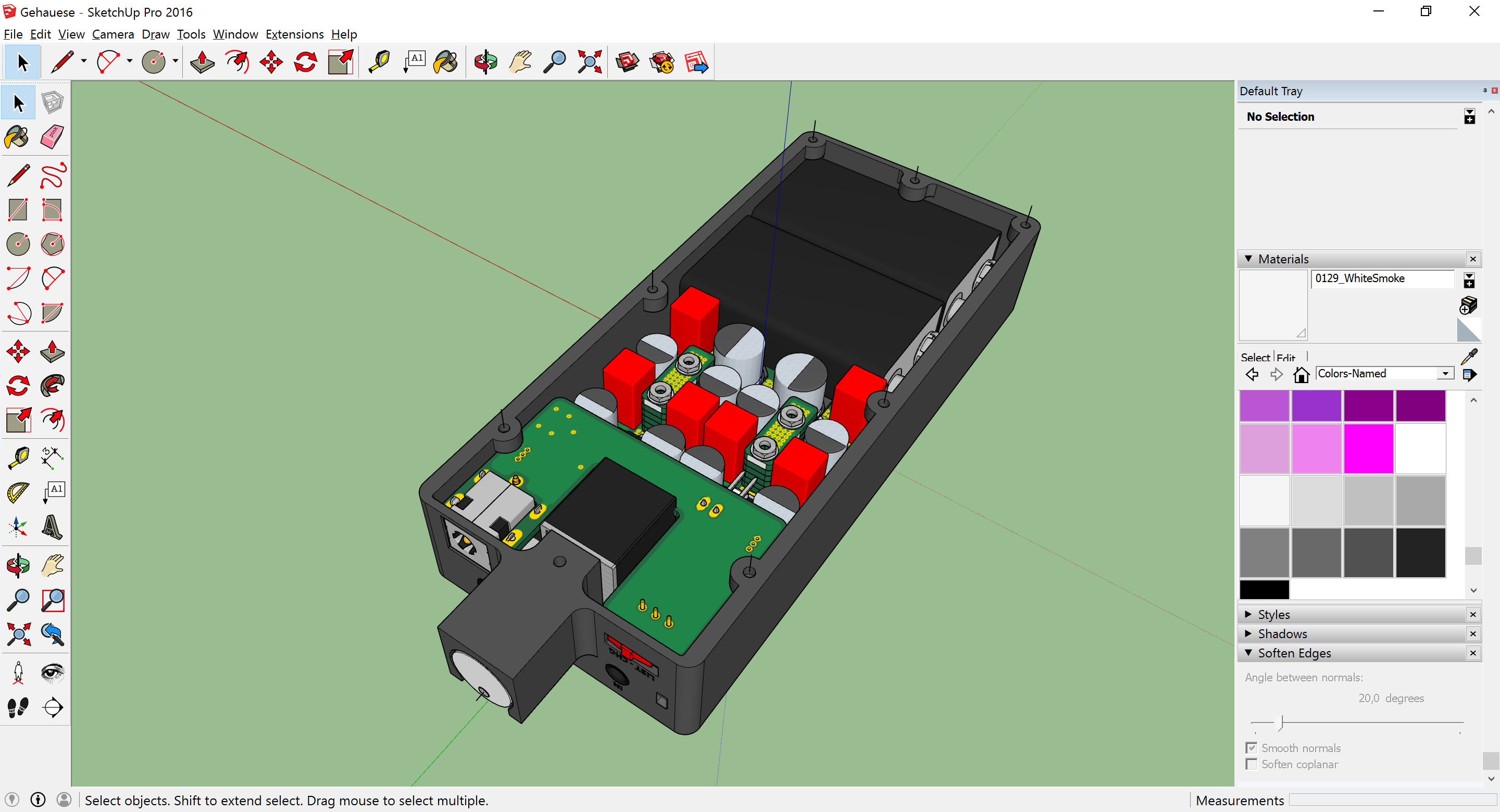

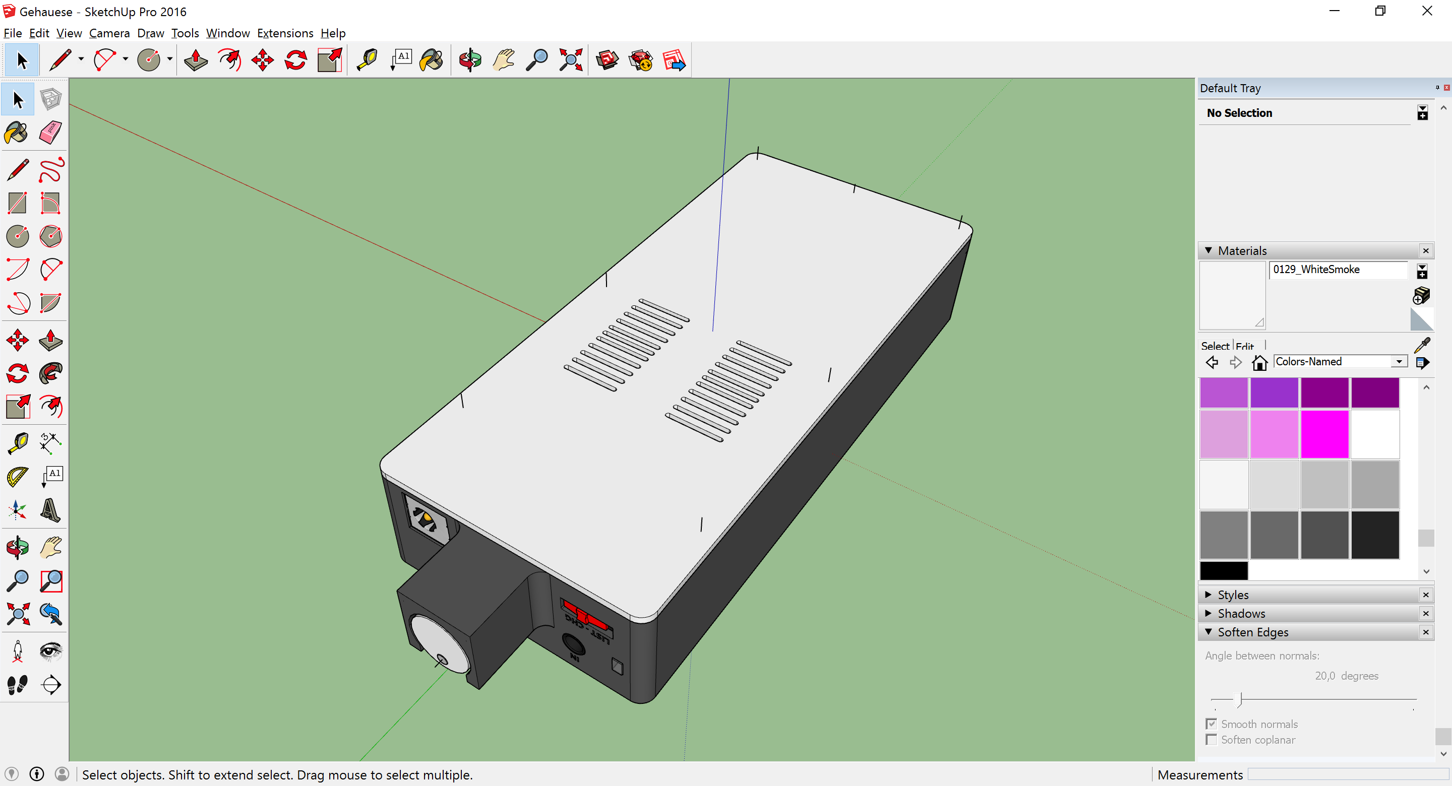

PCB ordered: 10µF ELNA SILMIC SMD on input; 4x 220µF OSCON + 0µ22/MKP2 + tbd FKP2 on output; TKD potentiometer; NiMH/NiCd charging electronic.
Preparing 3D Printing datas for enclosure online ordering...
JP
JP

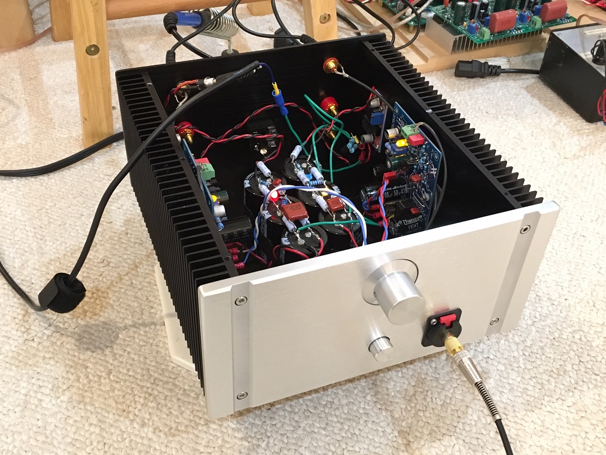

JPS64. That amp looks very nice. Is that a stack of PCB with bias used as a heatsink extended "fin"?
Check out the Silicon Harmony (6w into 8ohm single ended):
Well done X! What a beautiful beast. I can only dream of building something like this one day.
Looking forward to reading all the reviews, and I hope the orders start streaming in.
Thanks DIYRookie. It is indeed a beast: hot and heavy to hold when fully warmed up. 🙂
But the sound is glorious.
Slight correction. Measuremts show max power is 5w into 8ohms before clipping.
