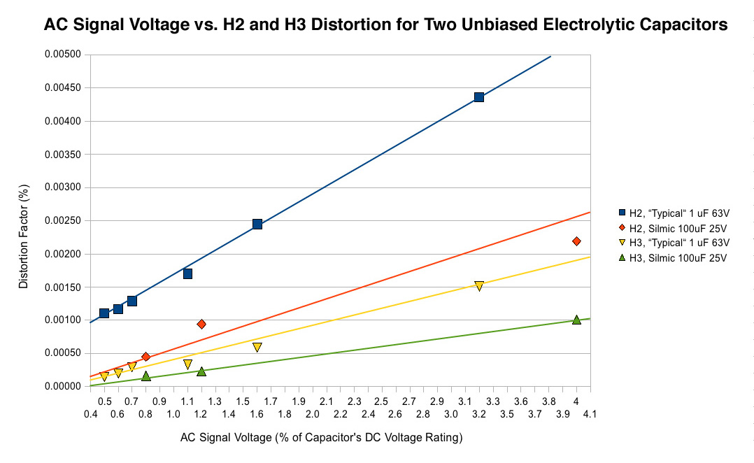

Note that the two caps I graphed were unbiased. This does not matter whatsoever for H3, which occurs wholly in response to AC signal voltage and is not significantly affected by DC bias. Thus, I believe this graph can be used alone to (very!) roughly estimate an electrolytic's H3 regardless of bias voltage. I should try to derive formulas for these vectors.
I think most caps' H3 would fall between the Silmic (representing best-case scenario) with most "Audio grade" caps tracking pretty closely above it, and less expensive general use caps performing more like the other unnamed (why?) cap, which Bateman called "typical" based on all of his measurements, most of which remain unpublished. Bateman passed away last year...RIP.
Figuring H2 will be more difficult since it depends on two variables.

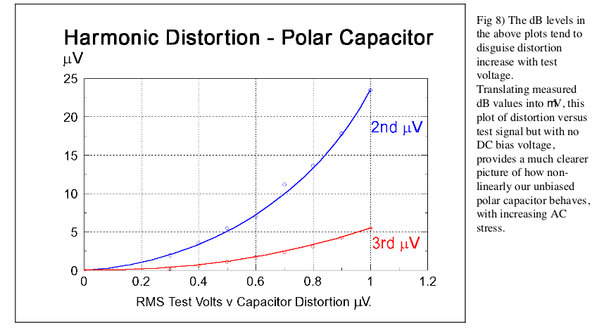

Excellent job! I like the graphs, it's easy to see the y=x and y=(1/2)x relationships. But I doubt if it's that simple, the axes are probably not linear WRT one another, which turns a straight line into some flavor of quadratic curve.

Alrighty... (Warning: artist preparing to attempt mathematics!)
X, your sine wave was 0.7 volts, and the OSCON output cap is rated for 20V DC.
So the signal was at 3.5% of cap rating.
Using the chart, and assuming an OSCON performs somewhere in between a Silmic and a "typical cap", we might expect about 0.00125% H3 distortion factor from the cap.
The total H3 you measured from your amp during the test was -84dB, or 0.00631%.
.00125 / .00631 = .198
If I'm doing my math correctly, the OSCON contributed roughly 20% of the H3 you measured! 😱 That's actually a more significant amount than I expected!
Note: At this point I'm ignoring the fact that you used a WIMA MKS bypass on the output, which should reduce distortion at 1kHz by some amount TBD, at least with higher impedance cans. This reduction must be less than 50% (and even that would be with a perfect, non-distorting capacitor) assuming the two caps share the signal equally above bypass corner frequency, though I'm not positive that's how it actually works???

About distortion vs. voltage axes being quadratic, that certainly can be true. The only comparative graph that Bateman published in all of his articles illustrates this:
attachment.php
This is from pg. 8 of Cap Sounds #5. This chart actually uses the exact same data used in my graph, but only from the "typical" cap, not the Silmic.
I'm not positive about this, but I think the relationship becomes linear only when units are converted (as I did) to signal voltage as % of cap rating. Possibly converting to distortion factor % helped too. At least it looks pretty linear with the limited data (wish there was more...but I've included everything relevant).

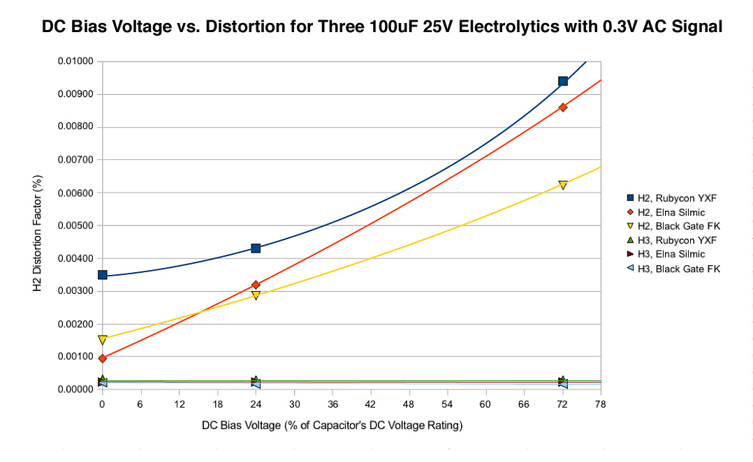

Here's DC Bias vs. Distortion with a 0.3V Signal
Such big gaps in the data are infuriating, but hey, the lines sure fit well this way!
This relationship is somewhat clearly quadratic, and I'm guessing mlackey is right that the last graph is too...just too subtle to notice there. Note how H3 is unaffected by bias voltage.
attachment.php
X, I don't want to choke your thread with irrelevant/insignificant stuff, so I'll start a new thread for the last couple graphs I plan to make from Bateman's measurments. Once I figure out a sensible way to cross-reference an AC vs. Distortion graph with a DC vs. Distortion graph, I'll report back here with my laughably crude prediction for capacitor H2 in the Pocket Class A! :hphones:
