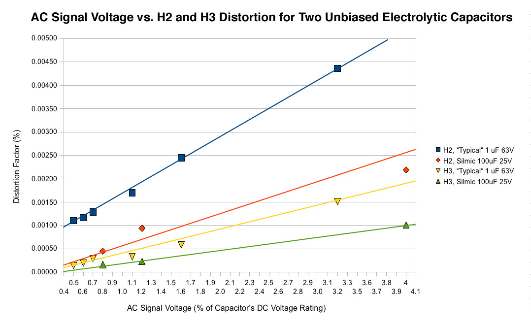

After further study, I've revised my list of capacitor facts gleaned from Cyril Bateman's work. I plan to start a separate thread for discussion of these ideas at some point, but since I originally got lost in this topic as a result of the Pocket Class A amp, I'll keep it here for now.
This list now includes A) the effects of AC signal voltage on distortion and B) the concept of "optimum bias" (thanks to Cwtim01's comment). I condensed some other things a bit.
In the effort to make this information more accessible and useful for predicting capacitor distortion levels, I've also made some graphs to help illustrate these points. Here goes:

So here is a graph that illustrates point #4 for electrolytic caps. (Pardon me...I flexed my primitive Excel skills to create this) There are some obvious gaps in Bateman's measurements, but certainly enough to establish a clear trend.
attachment.php
I used this Sengpiel Audio tool to convert the distortion attenuation measurements from Bateman's FFTs (in -dB) into distortion factor values (in %). I also expressed his AC voltages as % of cap rating, to make the comparison between different caps possible. I am very pleased that graphing in this way reveals a linear correlation between AC signal voltage and distortion. It shouldn't be too hard to just extend the trajectory of the best-fit lines for prediction purposes.
I am working on similar graphs for electrolytic distortion vs. DC bias voltage and hopefully another one for film caps.
