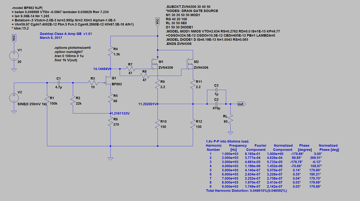

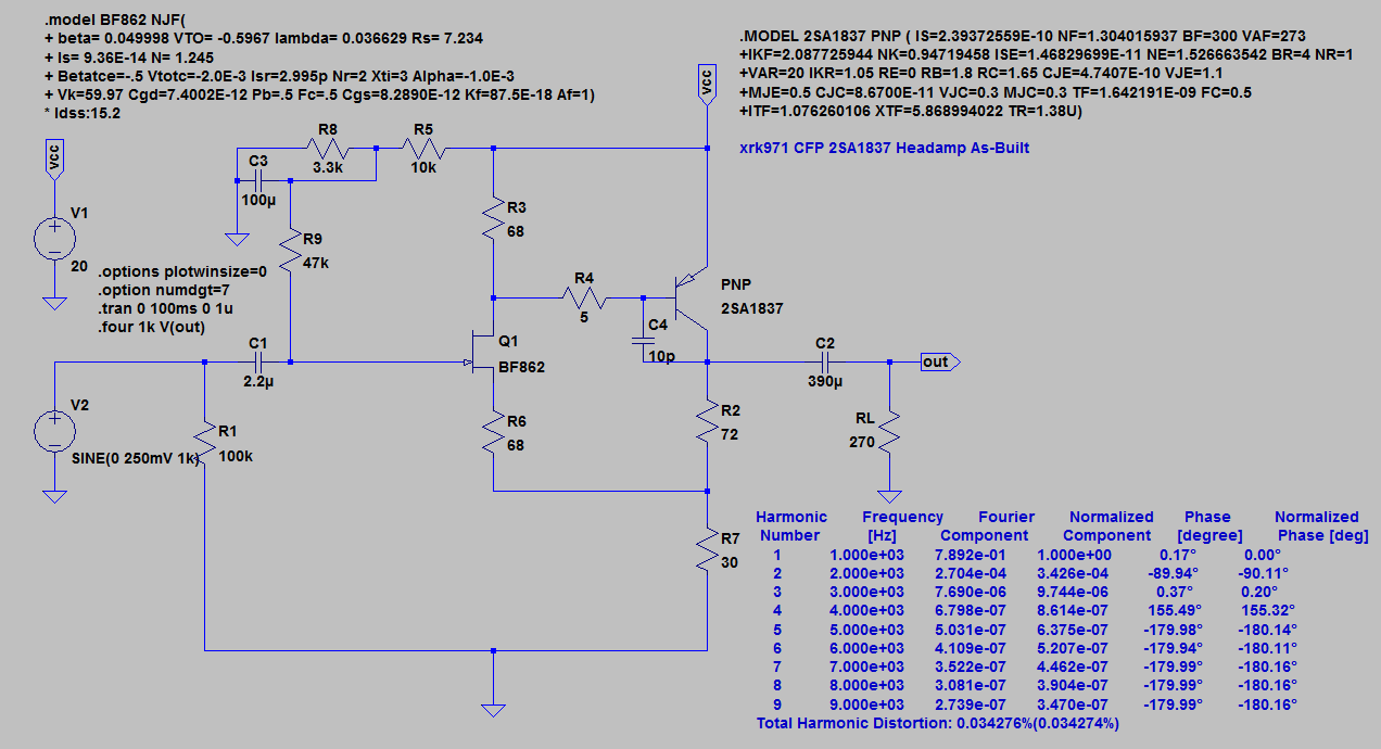

Here is something that BDHM and I are considering making for a new desktop amp based on the topology of the pocket amp - but with just more power. Now running about 150mA bias and having a 20v supply with dual matched MOSFETs, it can really drive lower impedance cans with more authority. Still very simple to make and hopefully we can get a new GB coming out for this in the near future.
Schematic & THD analysis:

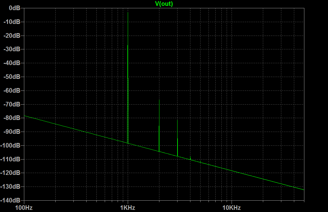

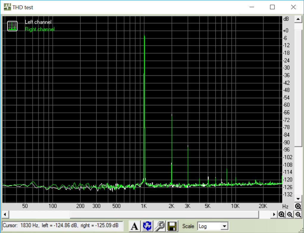

FFT for 60ohm load driven with 1.6v p-p:

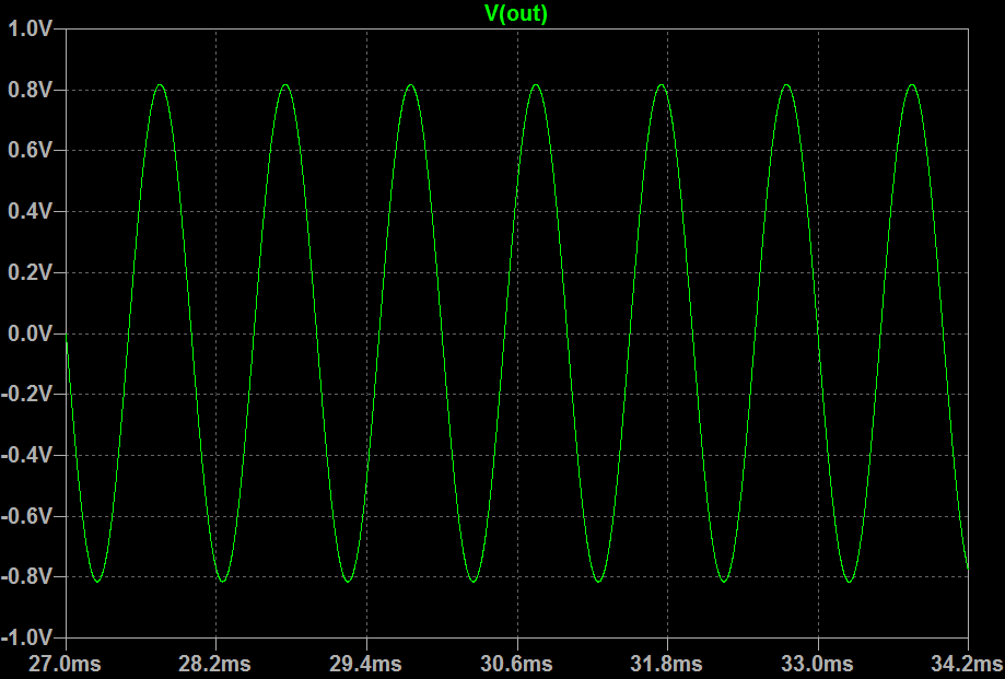

Output waveform for 250mV (500mV P-P) input:
Of course, careful matching of output MOSFETs is needed to maximize performance but we know how to do that very well using self-circuit for in-situ FET matching.

Yes, I am too. One thing to consider is how to implement an ultra-low ripple PSU. I have tested recently a way to get a few hundred mA of very low ripple (noise free) single rail power for low cost using common (cheap) off the shelf circuits.
Rather than a traditional transformer where we work really hard to get 120vac signals down to micro volt ripple - it's easier to use low cost SMPS (like a 5v USB charger or 12v external HD / router wall wart) to get a voltage that is *lower* than what is required. Then use an out-of-audio band 1.2MHz dc step up converter followed by some rudimentary (non-heroic) CRC filtering to smash that 1.2MHz RF signal down. 1.2MHz is so much higher than 40kHz that very steep passive filtering can be achieved for peanuts. By non-heroic efforts, I mean no series regs, no shunts or even cap multipliers requiring large heat sinks.
Here is an example of the 1kHz FFT spectrum from such a 1.2MHz DC step up followed by a simple CRCRC filter. Non audio (not the 1KHz and harmonics) are basically non-existent.

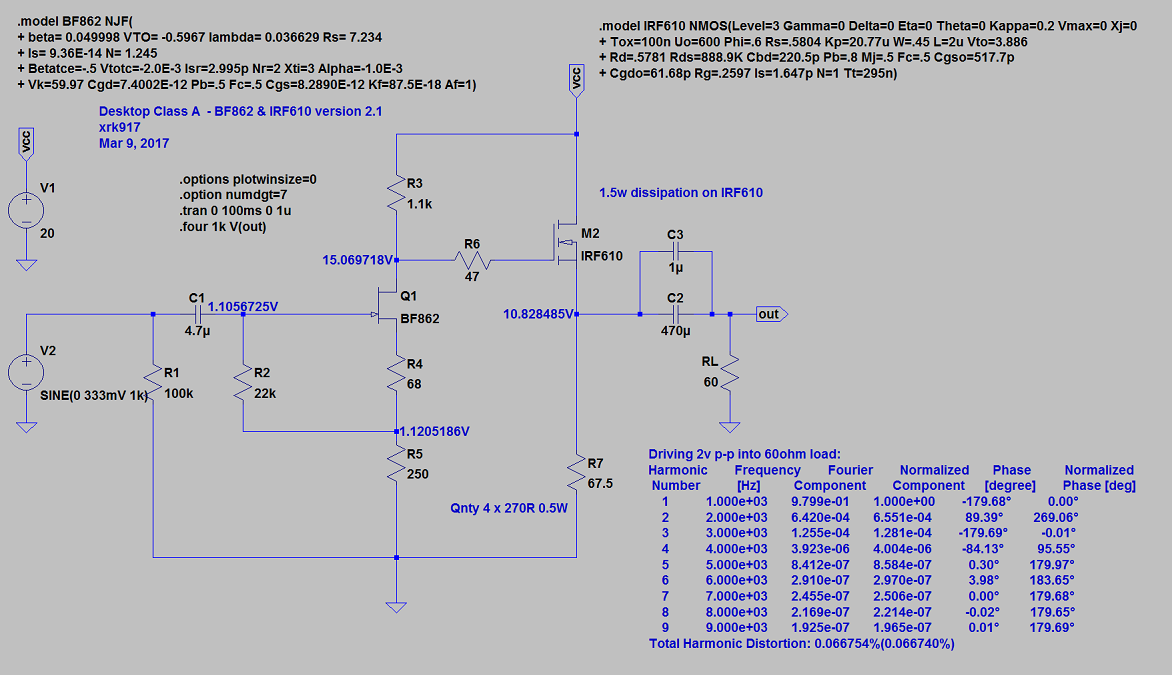

A simpler solution with single IRF610
I tried this out and now it's much simpler - no matching needed so resolution should be excellent. Able to drive 2v peak-peak into 60ohms cans witn 0.06% THD. THD can be made lower with R4 selection.
Schematic and THD analysis:

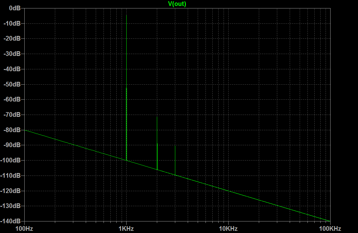

FFT for 2v P-P into 60ohms, gain is 3x:
By tried out, I meant in simulation. Luckily, it can be built quickly using the pocket amp PCB with an IRF610 standing up with heatsink and four through hole 270R 0.5w resistors.

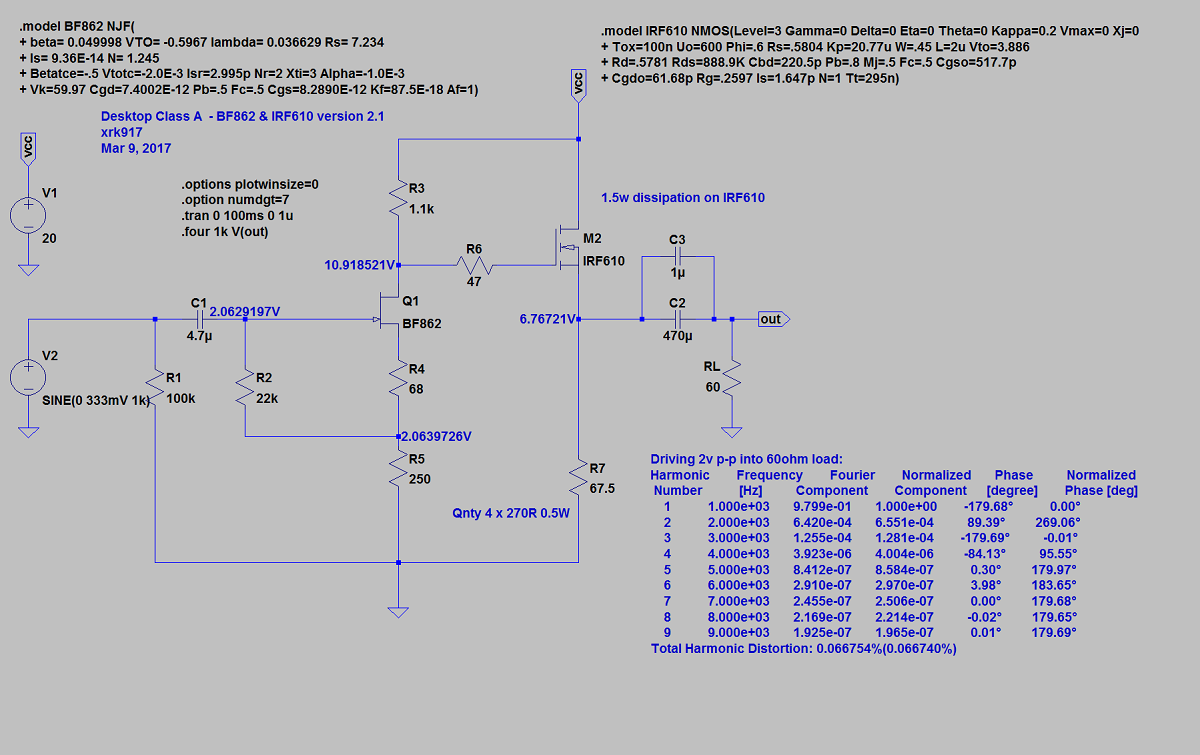

Strange but I must have uploaded incorrect picture because DC setpoints are not correct. Here is correct one:
Voltage out of MOSFET Source should be circa 10v to 11v (around mid-point of supply voltage).

Great X!! Very good results; particularly high ratio of H2 to H5.
Looking over your results, it might be possible to supply lower voltage whilst maintaining the output range to up to 2Vpp. The higher 20V supply militates against economical battery supply; if it could be done at 12V, it would save dissipation as well. The big issue would be the BF862; taking it down will reduce it's linearity but it could be OK.
