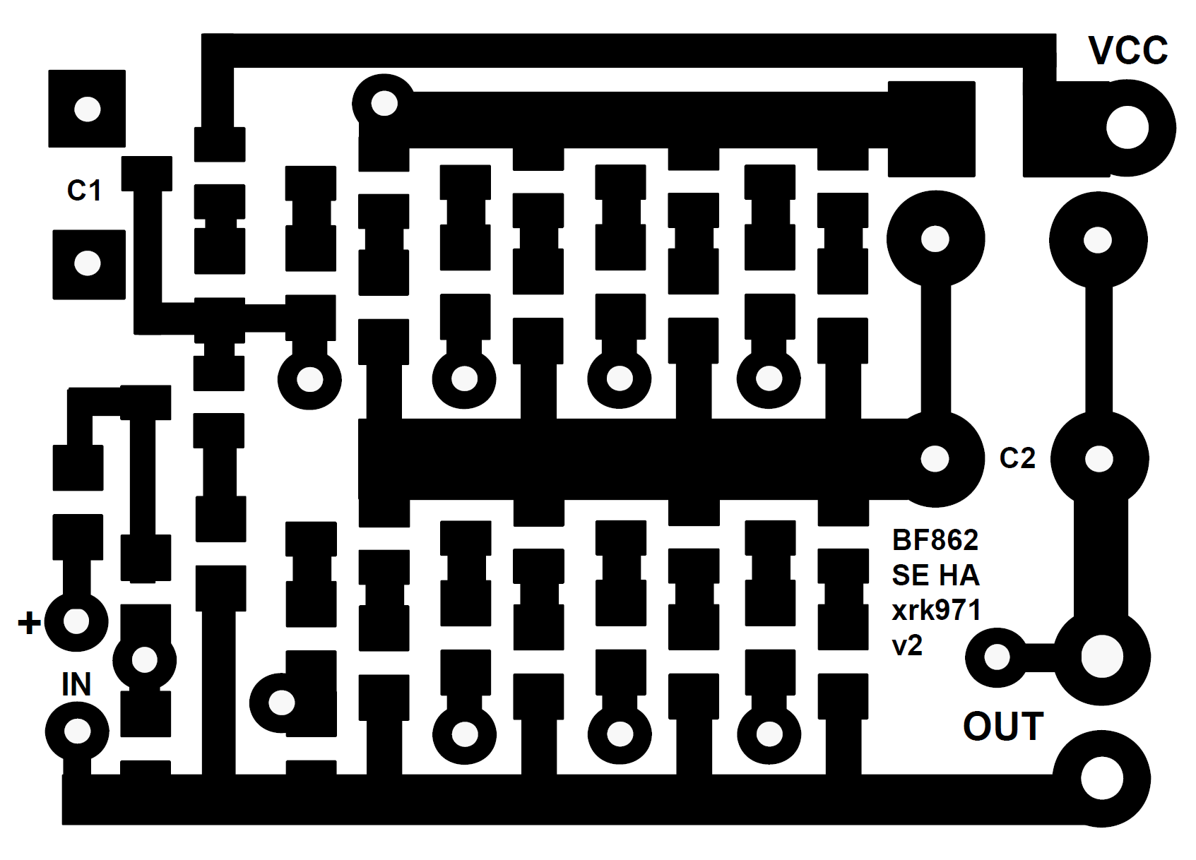

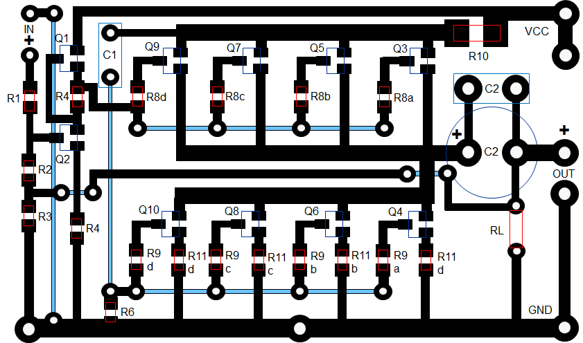

I did my layout using a drawing program (MS PowerPoint in this case) and came up with this:

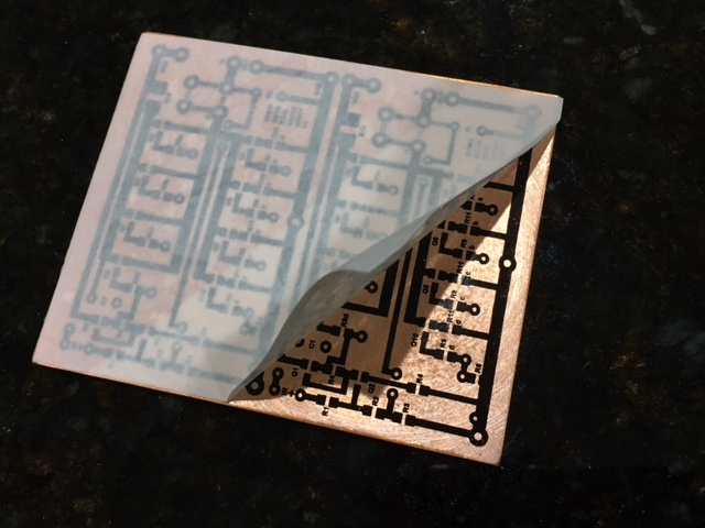

I then made iron on transfers using laser printer and got this on the copper as the etch mask:

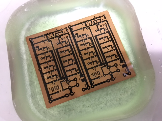

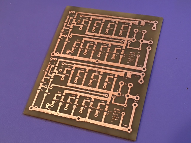

Etched in HCl and peroxide (hardware store muriatic acid concrete sidewalk cleaner and hydrogen peroxide (3%) for 20 minutes:
Etched board looks like this:
Soldered it up (I had to switch 1R source resistors for 33R to keep my bias current low, it was pegged at 23mA ea wit 1R):

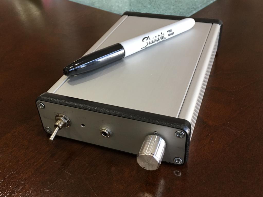

I spend half a day listening and decided it was worthy to be boxed. So using this niftly enclosure. After drilling some holes and adding a 50k stereo pot, and power jack, switch, LED indicator, 3.5mm jacks IN and OUT, the amp is completed:

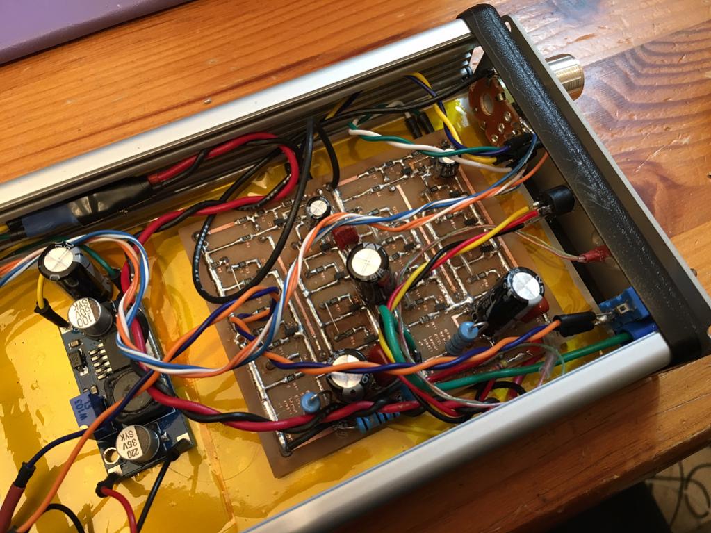

Here is the (messy) inside. I am not one to have neat wiring harnesses as my time is very limited to work on it. The wires work fine and do not seem to pickup noises. All wires are at least twisted:

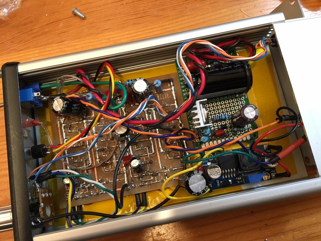

Edit: I added a cap multiplier using IRF540 MOSFET with 10mF output ca[ and circuit from Juma's Easy Peasy Cap Mx thread:

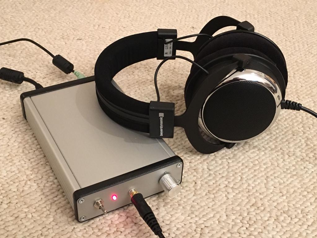

Here is the amp next to DT880's that I will be using them with. I am using a 2200uF 16v electrolytic cap for C2 bypassed with 1uF 230v MKT. I initially used 330uF OSCON but found the bass lacking. With the 2200uF I can hear deep deep bass now. There is a 270R 2W load resistor, so when I plug in the 250R DT880's, overall impedance is about 125R - which I think may help to draw more current out of the amp so it gets more impact with the bass (seems so subjectively).
586400d1482011463-bf862-based-se-class-headamp-without-heat-bf862-ha-build-final-dt880-12.jpg

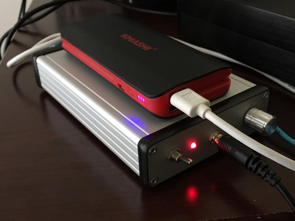

So in addition to sounding extremely detailed, neutral, and having excellent bass authority, they are absolutely cool. The case is ambient temperature after hours of playing. Also, since I am using a XL6009 switch mode step up regulator, the power supply input is very flexible. For desktop use I have a 12v 3A SMPS wall wart from my external disk drive. For portable use, I will use a 5v USB phone charger battery pack and let the step up take care of getting the 17v rail. I estimate a 10,000mA Li-ion battery pack will last more than 12 hours. That's a lot of pure class A play time for a small battery.
This amp sounds wonderful and I thank EUVL for a great design. It has indeed been tested and works very well. Give it a shot.
Edit: Dec. 22, 2016 - an attempt at a smaller 37mm x 26mm layout to fit in an Altoids tin with two 9v batteries.
Edit: Jan 6, 2017 - portable battery operation using 5v USB charging battery pack. 10,000mAhr cell should last about 15 hrs.
590340d1483735403-bf862-based-se-class-headamp-without-heat-bf862-se-ha-portable-demo-v2.jpg
Sound is still great - using XL6009 DC to DC step up internally for 18v supply to amp (after cap Mx).

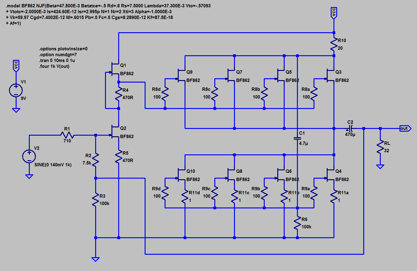

Schematic and THD prediction:
With audio its better not to harness the wires as close wires can interfere with each other.
Its worst with valve amps where there are high VAC and heater AC mixed in with high impedance audio signals.
I just got caught out recently with a USB scope circuit.
I ran a RAM address line close to a 1meg input resistor and every time the address line changed I got a glitch on the audio signal.

I posted this schematics as a Spice file for the gentleman easphyx who started the thread " Tin of FETs headphone amplifier".
http://www.diyaudio.com/forums/solid-state/298026-tin-fets-headphone-amplifier.html
It is largely his design so all credit goes to him.
I merely suggested a variant using alternative devices.
I have not built this and have no intention to, also in the future.
For this to work as in the simulation requires matching of both Idss and Yfs.
Gettinng sound out and having the circuit functioning properly as intended are two different things.
If any of you wish to find out please google SRPP and White Follower.
Or ask the originl designer at his thread, as a respect to him.
And the circuit is capable of fitting into the original footprint by easphyx, as he intended.

MMBFJ310 has 24-60mA IDSS, which is the "idle current" when Vgs=0, so I wouldn't exactly call that "current capability" for the typical MMBFJ310, which will have less than 60mA IDSS. You may have trouble finding matched pairs if IDSS does actually vary that much.
Note that forward transconductance of MMBFJ310 is only 18 maximum compared to 45 typical of BF862. I would expect you to need almost three times as many of the MMBFJ310 to maintain a similar output impedance as the BF862's, despite their higher IDSS.
Also, how do you plan to cool a tiny SMT MMBFJ310 passing 60mA at ~10V?
Good job, guy.
May you say me how did you do the transfer from the paper to the copper side of the PCB, of the toner ink? I know it can be used an iron, but I doubt about time, and quality of the transfer, and which process did you do to ensure that the transferred toner doesn't peel off.
Thanks in advance.
Founder of XSA-Labs
Joined 2012
Good job, guy.
Thanks in advance.
I use a laser printer to generate the black images onto adhesive backed vinyl film (applied to paper) used to cover shelves and other surfaces. Then preheat copper with iron for 2 minutes, then lay image face down on copper and cover with another piece of paper and apply iron for 2 minutes. Remove and run under cold water, then peel vinyl off at sharp (near 180 deg angle) to leave transfer behind. Touch up holes with black Sharpie marker.
This is what I use.
https://www.dollartree.com/Con-Tact...dhesive-Shelf-Liners-18x54-/p306003/index.pro
Very crisp features can be obtained if done right. I got it after 2nd try. Start with small projects like a preamp. Take for example my BF862 preamp by Juma. Lettering and traces are very clear. This one was better than my head amp.

Added Juma Easy Peasy Cap Mx
I added Juma's Easy Peasy Cap Multiplier (using IRF540 MOSFET and 10mF 25v output cap). I also adjusted the DC step up to produce 20.0v output after the cap Mx. The dynamic headroom really went up another notch and cannot detect clipping at highest volume setting now. Also, bass authority seems to have improved dramatically with the cap Mx. Running 20v across about 50mA is about 1w dissipation in the JFETs per channel. Cap Mx is dissipating about 200mW for 4v drop and 50mA current, per channel. So 2.4w total heat generation so should be manageable.
