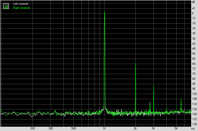

ROFL. That amp looks incredible--both its physical form and the sweet harmonic profile visible in the FFT.
Where does the the tiny peak around 2.8K come from?
Those little peaks are an anomaly - perhaps the DC to DC switch mode step up converter is not working right. It was not there earlier - so I am investigating. I do hear an audible buzz in the converter (with my plain ears when near the amp) that wasn't there before. Sounds like 2.8kHz - you can't hear that as the level shown by the FFT is very low.

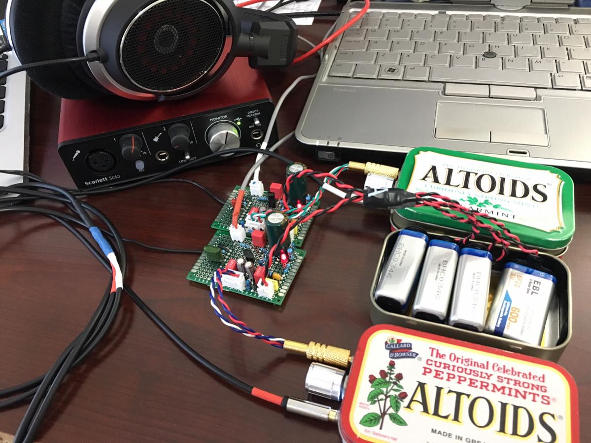

SE Class A balanced line driver for balanced headphones with two Pocket Amps.

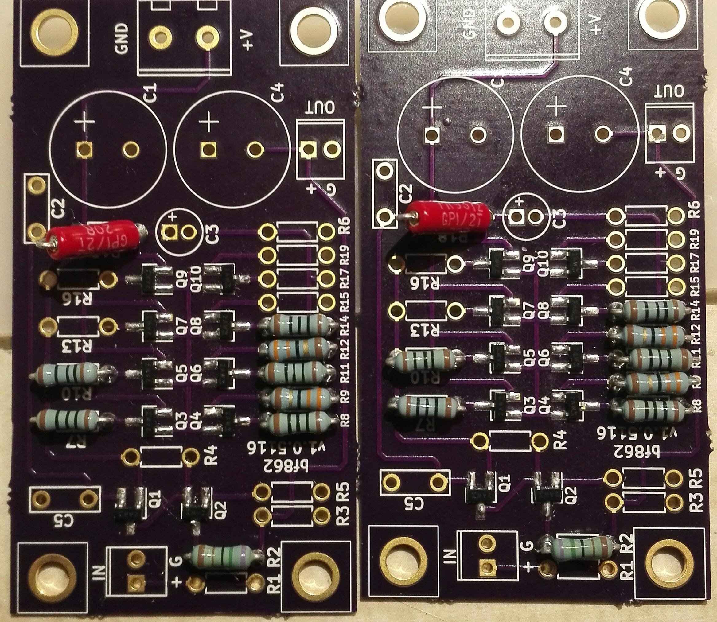

Are we talking about this layout (from post 75)?
How closely matched does the BF862's need to be?
I've got 100pcs on the same strip, the first 15 or so I've tested are mostly 13-15mA Idss, mainly 13.5-14.2mA.
I'm thinking getting 0.1% or so may be difficult with the 100pcs I have.
I managed to get 20pcs with Idss 13.4mA - 13.8mA out of the 100pcs I have. That is the closest I can get for that many. The good thing about this tedious process is that I now have some quads and pairs with very close matches for Idss.
That sounds pretty good match what you describe. 13.4mA to 13.8mA.
I would have prefered something closer to 1%, but not enough to go get another strip of 100 BF862's.

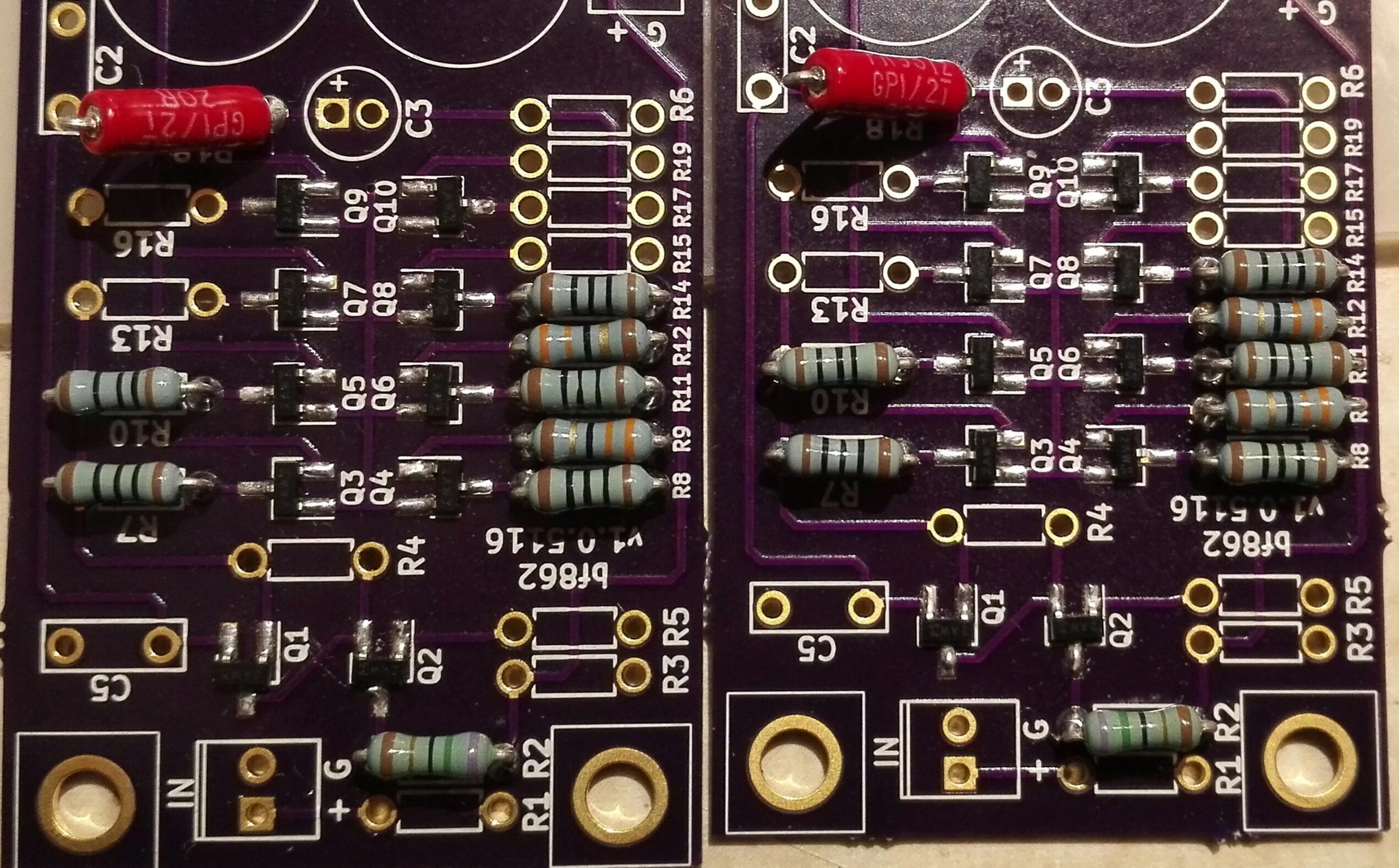

The boards are slowly populating as I can only do so much before the pain in my back gets too overwhelming.
Resistors are Takman metalfilm and PRP metalfilm.
