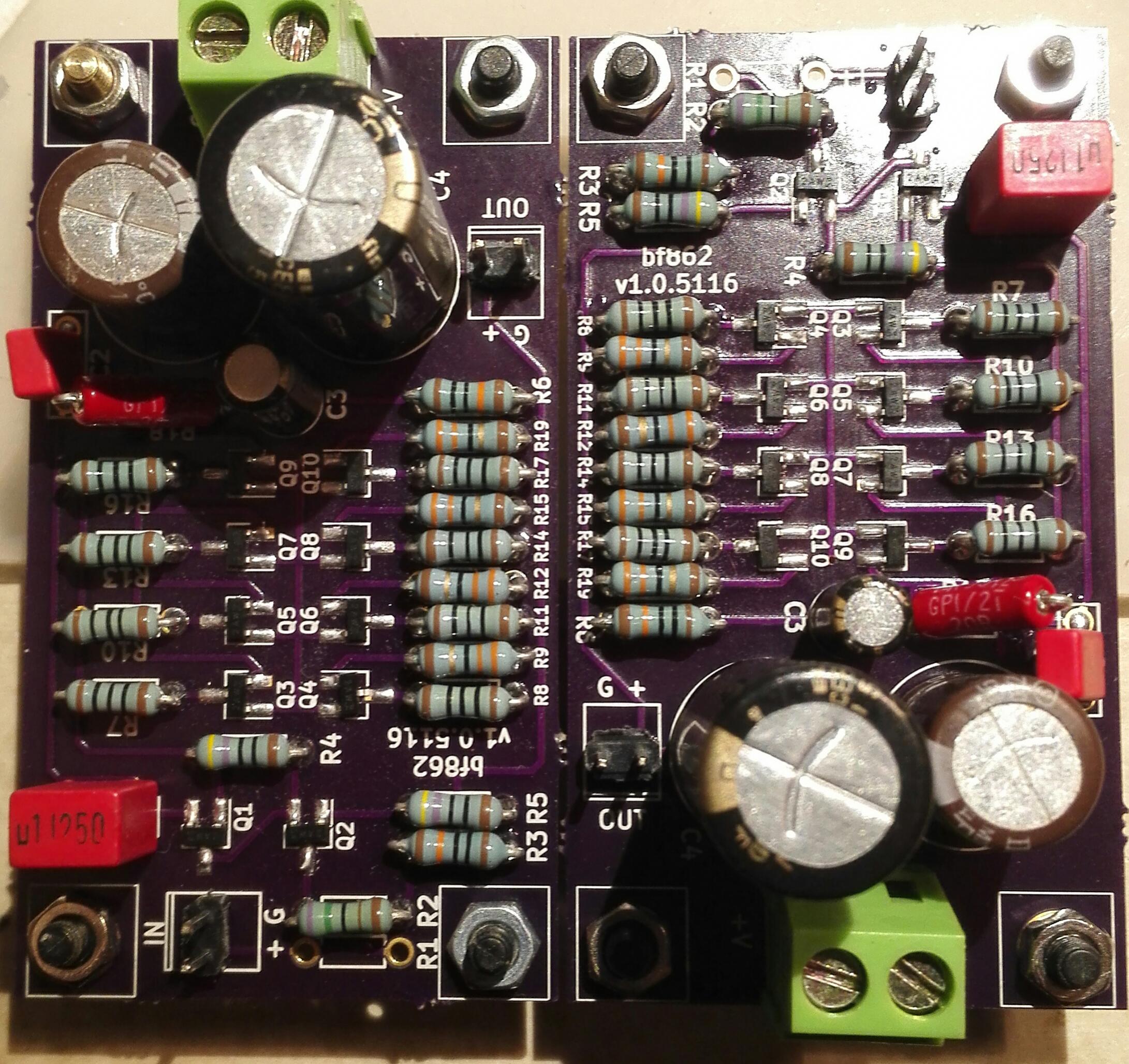

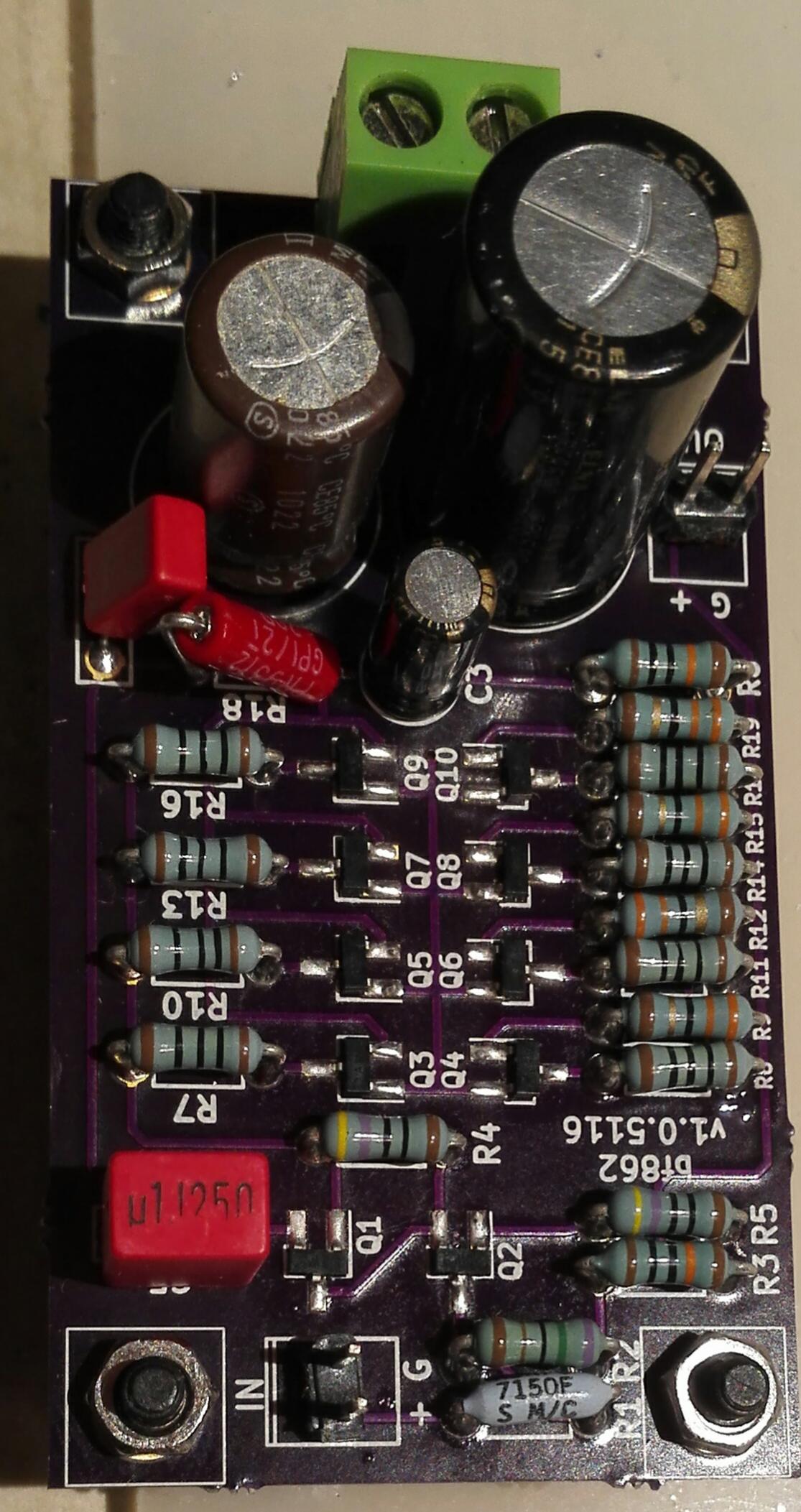

Nearly completed the headamp. I am still waiting for the 715R's (RLC IIRC) light blue ones I have used before and I think they're good.
I used a 100uF/25V Silmic II for onboard PS as I could not fit the 470uF/25V Silmic II in any acceptable way.
The 470uF/25V ROA Cerafine on the output fits perfectly. I am considering the potential benefits (if any) of putting an SMD film cap across the output capacitor.
I have some AVX and Panasonic SMD film caps in various sizes and values.

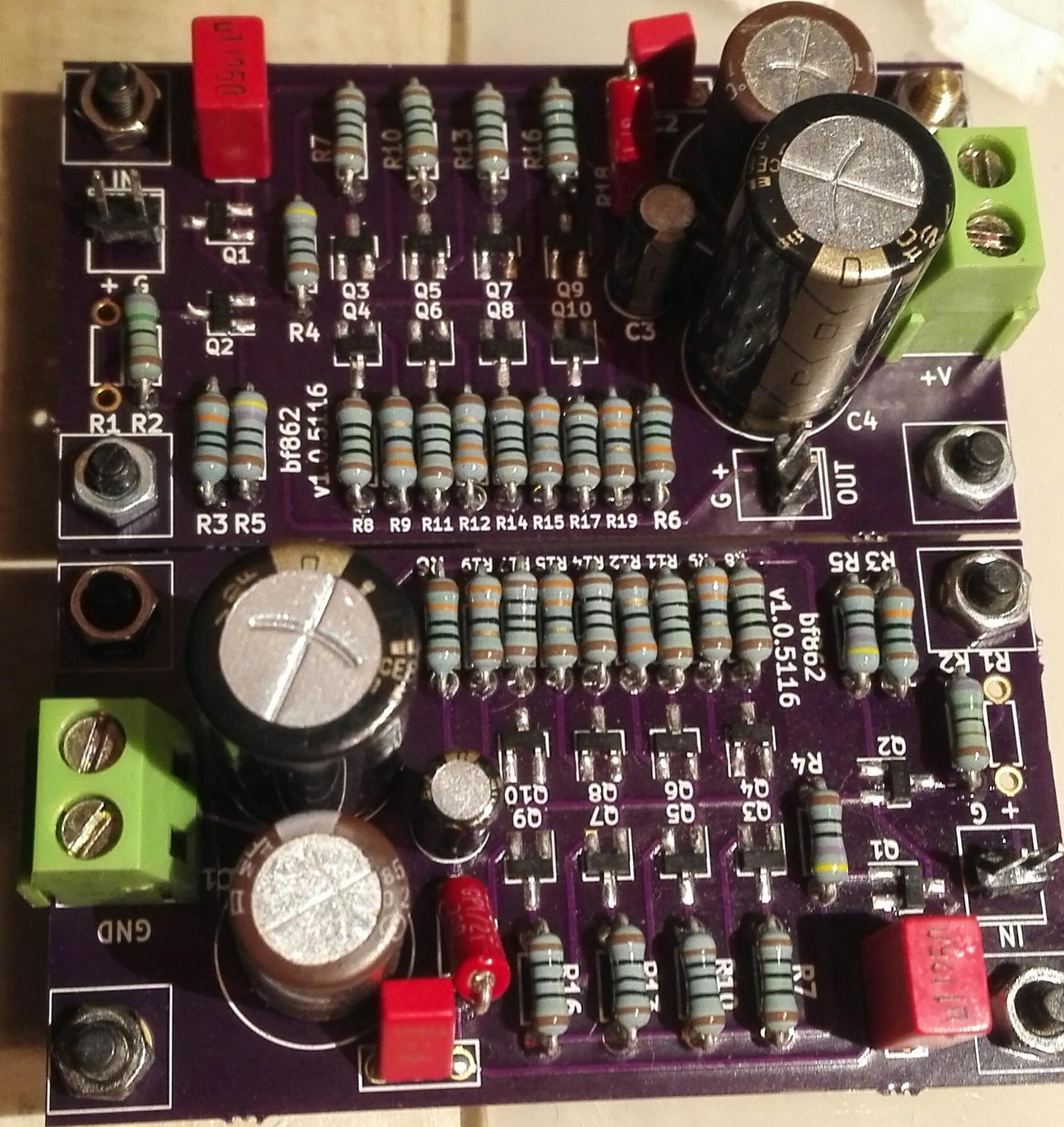

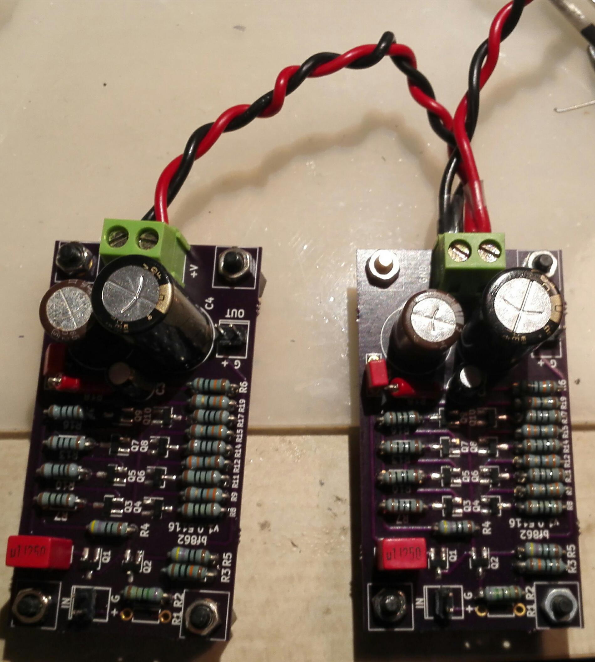

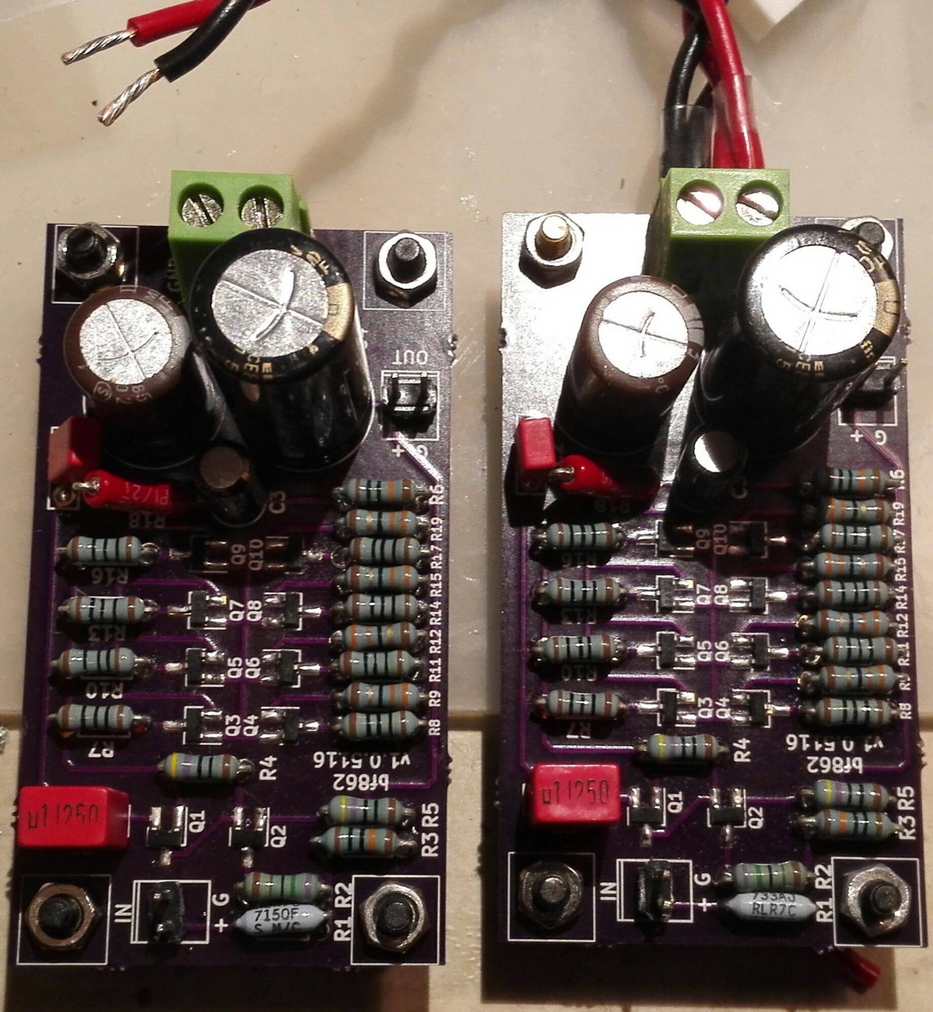

I went over the boards with the DMM, with PS wires connected as in the attached pics, I got about 22R between VCC and GND. Is that correct?

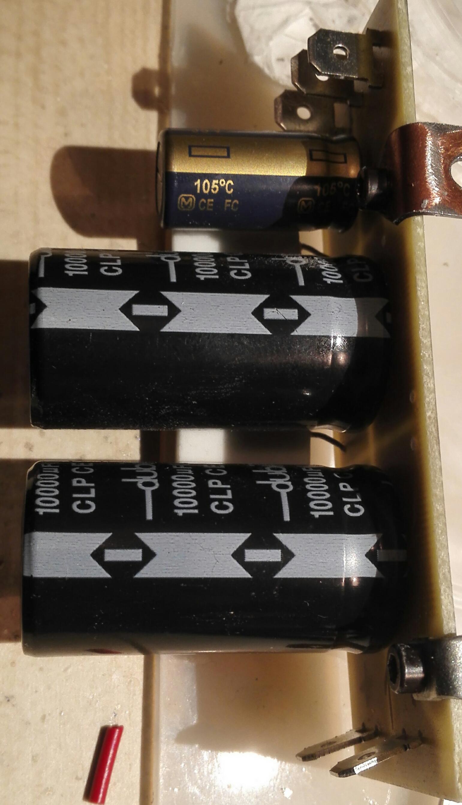

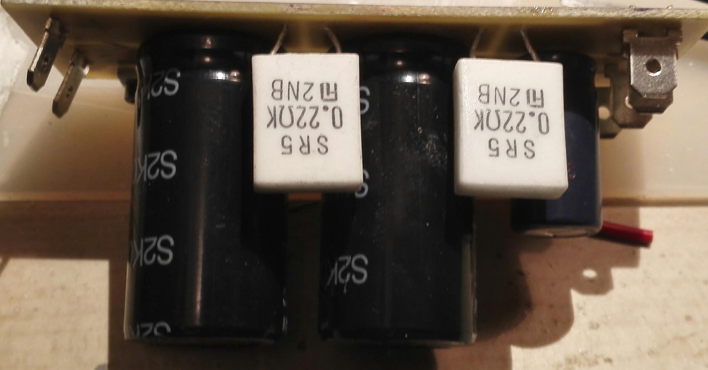

I had to use 10000uF/25V Dubilier (x2) and 1000uF/35V Panasonic FC as there's no way to fit two of the 22000uF caps on the board.
Edit: resistors on GND side are not yet populated.

BF862's are N-junction depletion-mode FETs, which are normally conducting (self-biasing capable) when no voltage is applied to the gate. 22R is probably result of natural conduction in the nominal no-voltage applied state. With a 20v rail that would be nearly an amp, nut max is limited by Idss of BF862 (around 10 to 25mA). I think nominal operating bias current is about 50mA to 60mA if I recall, so should go down once powered up.
Looking good Mayday!
Thanks 🙂
With the boards not connected via PS wiring I got 42R.
The devices are 13.4 to 13.8mA Idss.
I got the resistor needed to complete the headamp today. 715R as I didn't find 710R, does that matter?
Sorry you were waiting on that. Not critical at all, anything from 220R to 2k would have worked

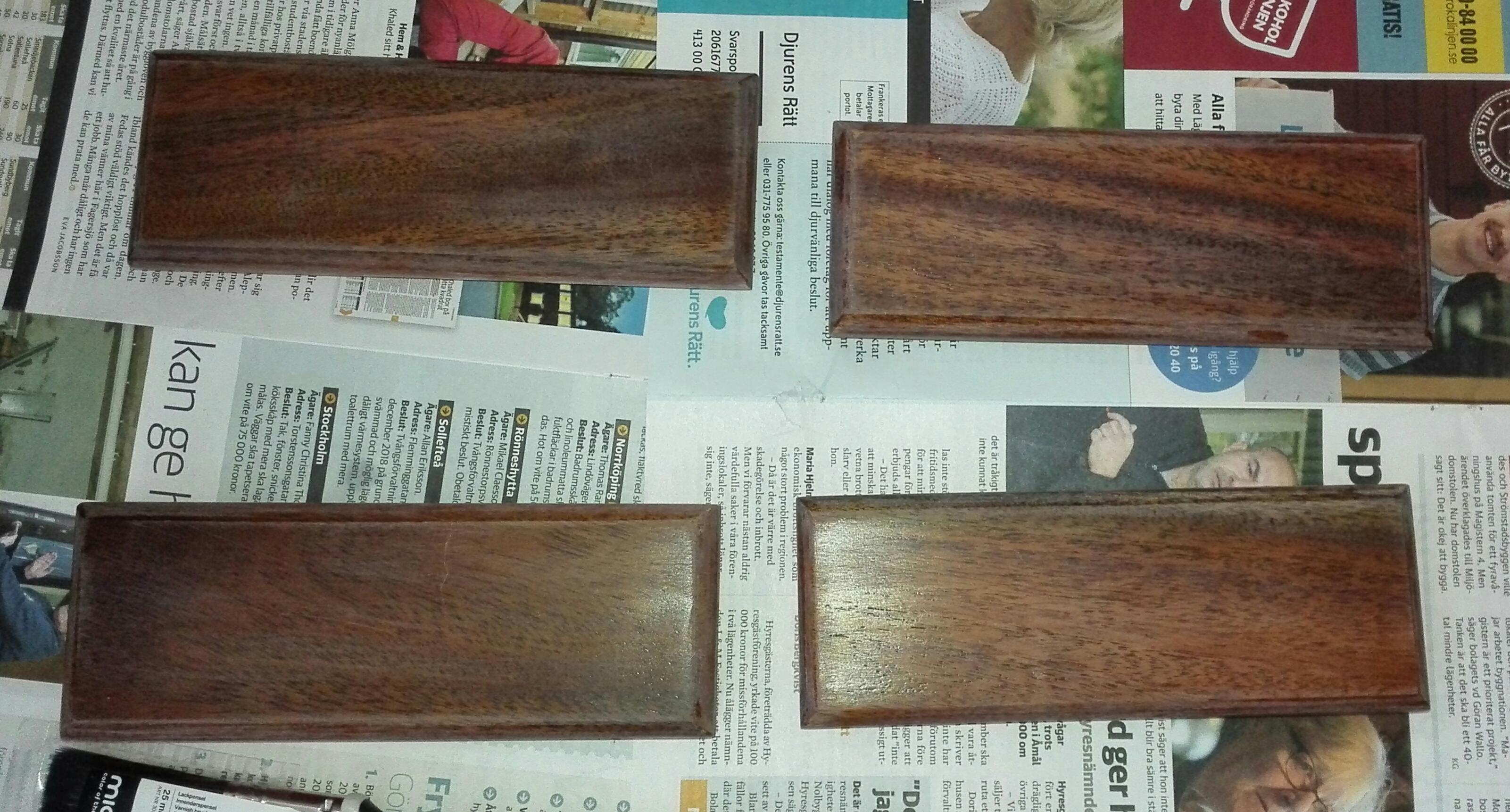

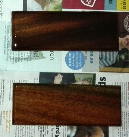

Today I sanded and put the first layer of varnish on the wooden side panels.
Edit: I have two of the same enclosures, that's why there's 4 side panels.
1W or even 500mW resistors can work for your CRC. We are taking flow of maybe 120mA here Class A so steady.

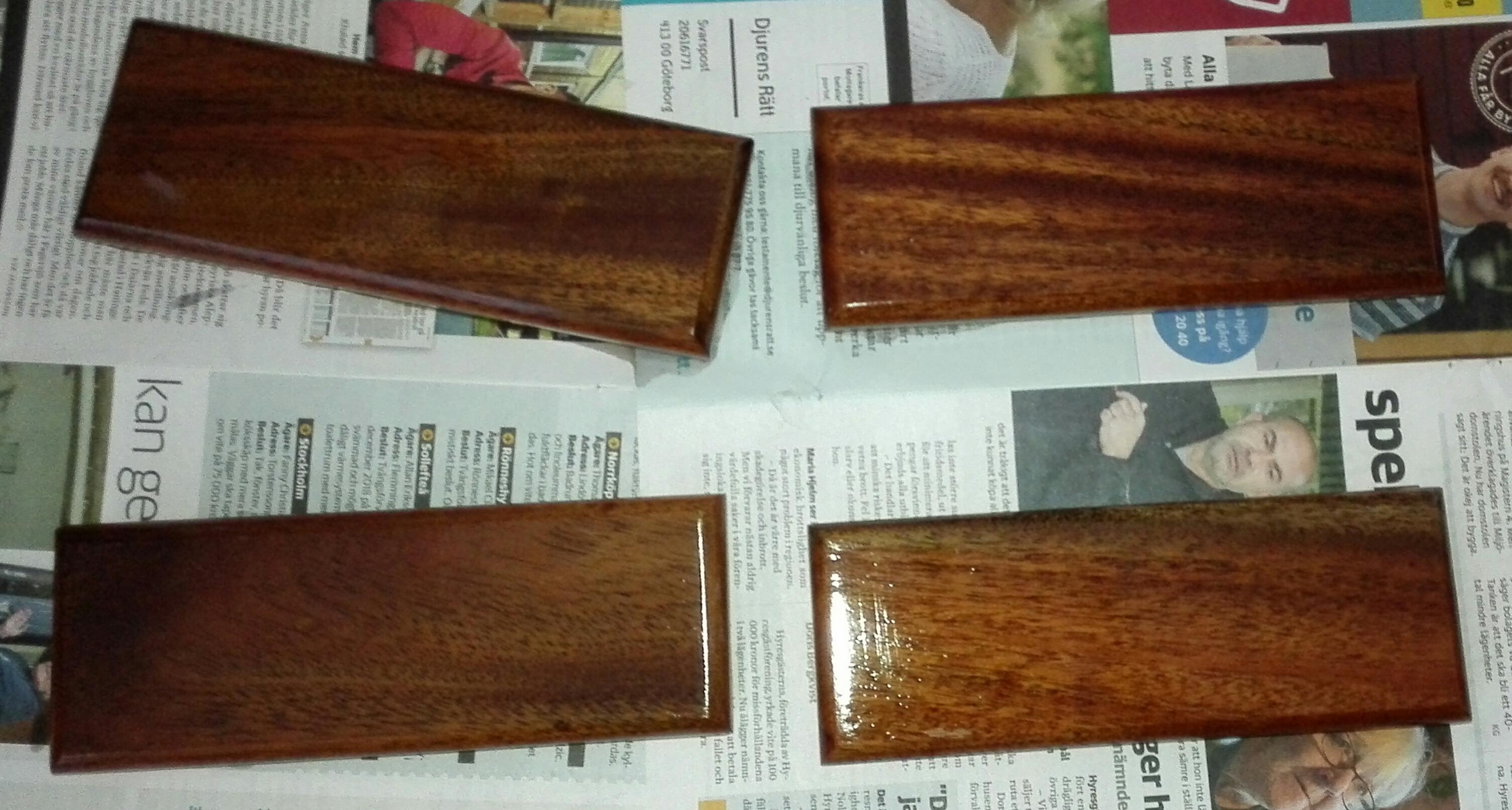

Put a second layer of varnish on the wooden sides.

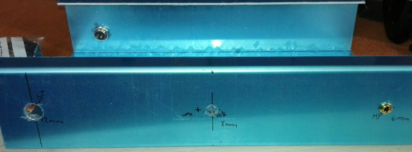

I also started drilling holes in the alu-enclosure.
