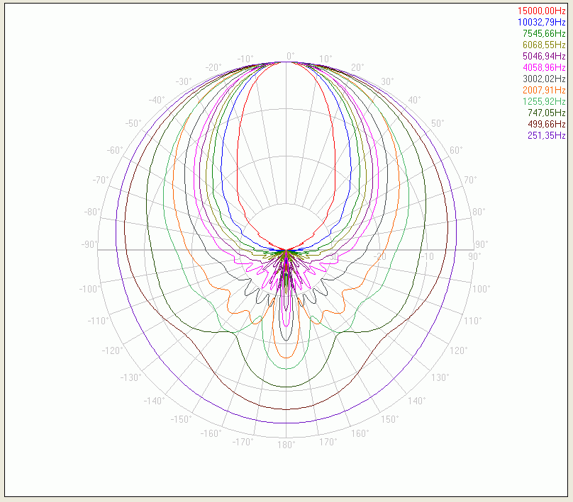

In my experience you don't have to have constant directivity at all frequencies to get a certain imaging characteristic. I have played with systems that were fairly constant directivity above the modal region of typical rooms (several hundred hertz), systems with narrow beams that narrowed further as frequency increased (my current midwoofer / horn HF system), and systems that were only constant directivity above several kilohertz if you squinted really hard. I have noticed similar imaging differences with all of these systems which makes me think the higher frequencies are more influential than lower frequencies. Low directivity systems are more enveloping / have wider soundstages and center vocalists or instruments sound like they're further away / behind the front wall. As the directivity rises vocalists tend to move forward to be in the room / between the speakers and the sound stage narrows. This is when comparing with the same recording / room. In my mind, at a high level directivity = imaging characteristics (assuming all else equal).

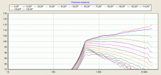

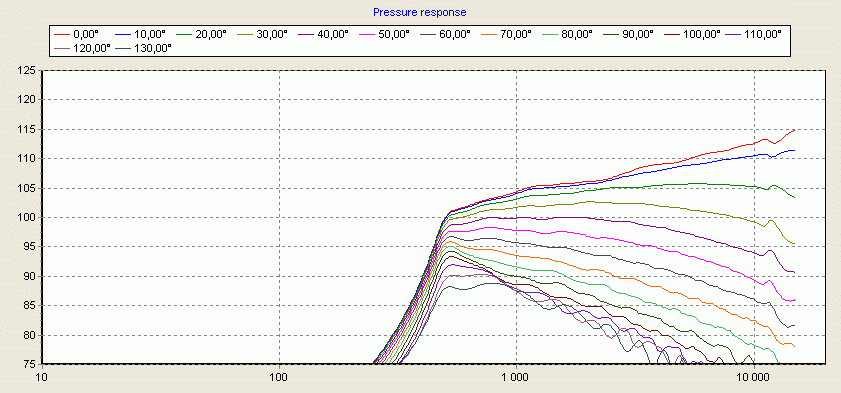

Ro808 posted this attached curves. https://www.diyaudio.com/community/...ion-with-a-2-way.334757/page-164#post-5926354
Assuming these are accurate measurements of the AH425 horn, looking at the FR curves, if the horns were toed-in ~ 30 degrees, though you would lose that amount of room coverage you would in turn gain a much flatter on-axis response, yes?

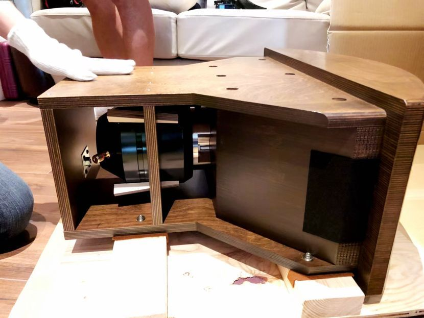

I know it’s only a picture, but what might it tell you about how sound is projected by those 425 horns as placed (~ 8 ft apart) in that room? And in a ~ 22 ft x 15 room, with a sloping ceiling that peaks at 11 ft?
https://galibierdesign.com/wp-content/uploads/wa-trip_gary-d.jpg
For a single listener 11 ft away, despite the very beamy 425 horn, versus low directivity horns (e.g. https://audiohorn.net/x-shape-horn/ or https://audiohorn.net/next-gen-bi-radial-horn/ ) being “….more enveloping / have wider soundstages and center vocalists or instruments sound like they're further away / behind the front wall.”, would there still be a perceptively large sound stage in all dimensions?
If not, would it seem more so if I moved another 3 ft away?
The only reason I asked this was because this DIYer who built these speakers with AH425 horns/Radian 745Be drivers said “Soundstage is ridiculously huge. Incredibly 3D it sometimes sounds like it’s coming from behind you. Surreal.”
What may account for his reaction from such high directivity horns?

Those curves are kind of tough to use in my opinion. I prefer polar maps for looking at directivity. You can (and pretty much have to) EQ a horn like this to get the response you want in my experience, so 'getting a flatter on-axis response' is kind of meaningless in my opinion. You can make any axis flat (or whatever response shape you want), but the power response will change in the same way which is what will drive the reverberant field in the room. I have my speakers pointed at my listening position. I EQ my system for the room it's in at the listening position. I have my speakers a fair distance from all walls, but I'm not sure it matters that much with high directivity designs like these. The general comments I made on imagining had some systems near the walls, some far away. I suppose if you didn't point the speakers at the listening position and then eq'd the system like that you might get a more enveloping system due to higher levels of horizontal early reflections but I haven't tried it myself. I guess the reverberant field would end up a bit brighter if you had to boost the highs due to listening off axis (room dependent).
The Audiohorn.net horns you link to are not particularly low directivity. They look to be -6dB around +/-45 degrees horizontally which would make them a moderately high directivity design (maybe around 8-10dB of directivity index) in my experience. Not as high as a round LeCleac'h horn but still fairly directive. I would say low directivity is around 0dB (omni), medium is 5dB (cardioid), high is above 10dB. My LeCleac'h system is around 10-12dB above 700Hz when looking at DI based on power in the listening window.
I wonder what the difference in the subjective comments on imaging you are trying to evaluate are due to. I honestly do not know. My experiences come from being able to instantly switch between otherwise identical systems in the same position in the same room with matching in-room timbre with varying directivity. In such a case you are really only listening to the directivity differences. It's very interesting. Having a speaker with a directivity dial would be a fun thing to have. Dial it down for some classical in a big hall, dial it up for jazz or other small bands, maybe.
The narrowing directivity also makes sharp percussion sounds and little high frequency events also more "visible"
