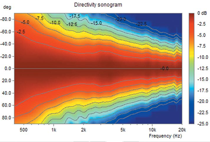

https://cdn.shopify.com/s/files/1/0...BMS_4591-8_off-axis3_480x480.png?v=1649504045
https://cdn.shopify.com/s/files/1/0...ot_2023-10-14_170306_480x480.png?v=1697317415

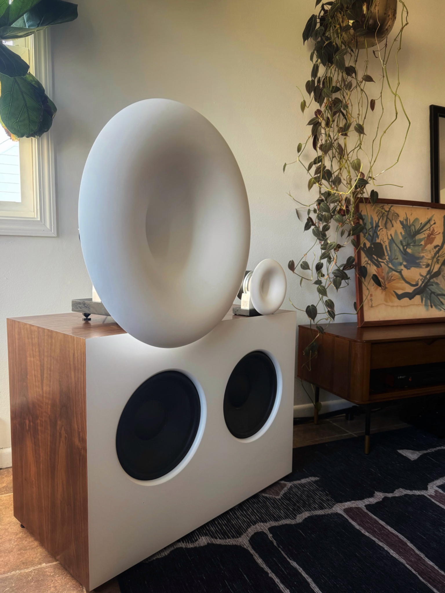

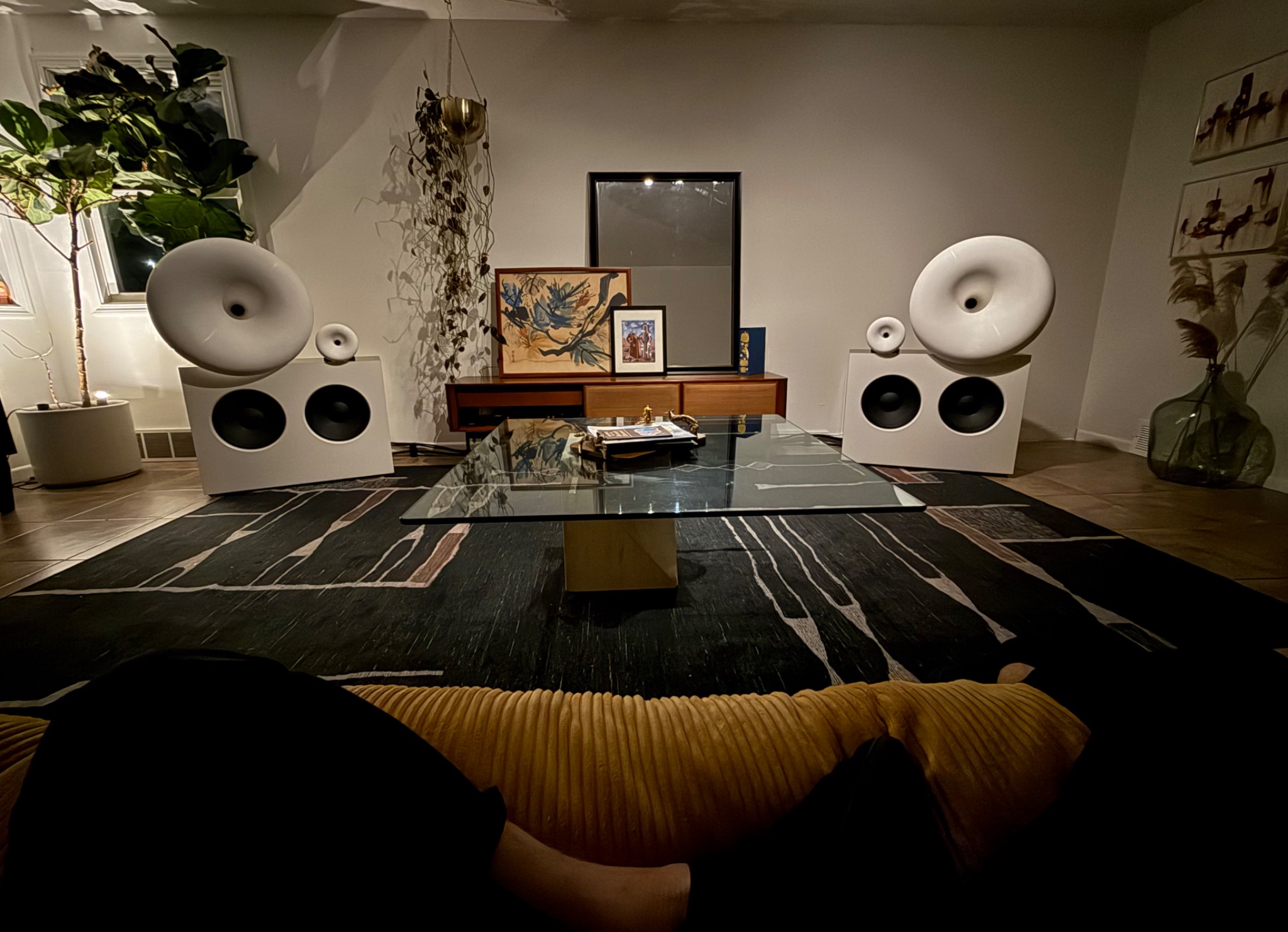

Question: Say you were going to buy a TV to use with your elliptical horn speakers and maybe a pair of subwoofers. And that the chosen TV screen size and viewing distance would be whatever you were comfortable with. With everything all set up, you retrieve from your sizable BD movie collection a few of your favorite titles and spend time playing a few scenes from each BD disc. Based on what the movie dialogue usually sounded like among all of those scenes, on a scale of 1 to 10, with 10 being most likely, how likely would you want to add (buy or build) a center channel speaker? And why or why not?

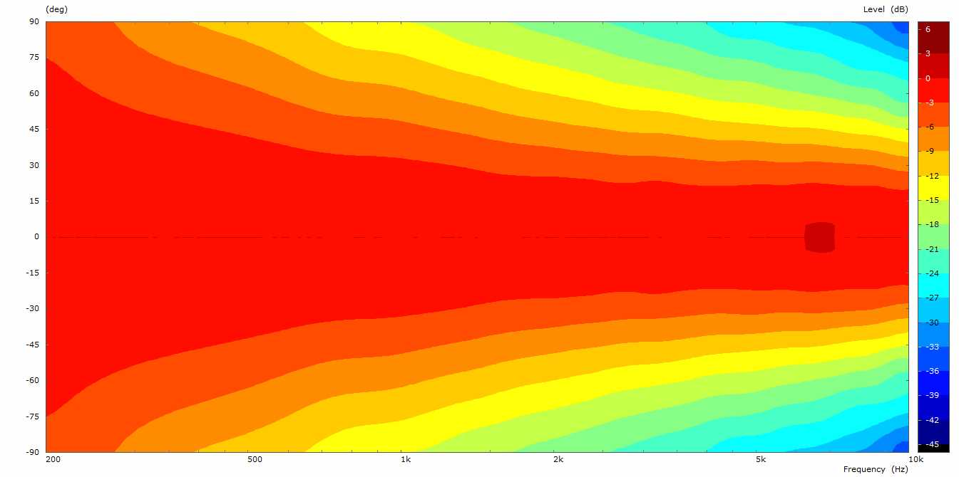

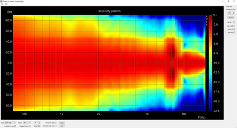

Given the hrz plot of your horn https://sphericalhorns.net/wp-content/uploads/2023/04/mk3b2_polhrz.jpg compared to Camplo's, it seems clear that you prefer a CD horn while Camplo likes a horn with rising directivity. If so, based on Camplo's above statements, it would therefore seem that you like to hear a more indirect sound-although you presumably went to great lengths to detect, measure and attenuate harmful room reflections, yes? But might there have also been something about the design of your horn that makes it less sensitive to room reflections? And might this even be true of which of these horns you would recommend for me? http://www.alg-audiodesign.com/pavillons-mono-cellule/I think that the original Iwata profile would fit to your needs / expectations: https://www.audioheritage.org/vbulletin/showthread.php?31481-Are-Iwata-horns-that-good
Question: Regarding vrt plots https://sphericalhorns.net/wp-content/uploads/2023/04/mk3b2_polvrt.jpg ,
is one of the uses for knowing the horn's vertical directivity behavior being able to minimize horn and/or woofer lobing?

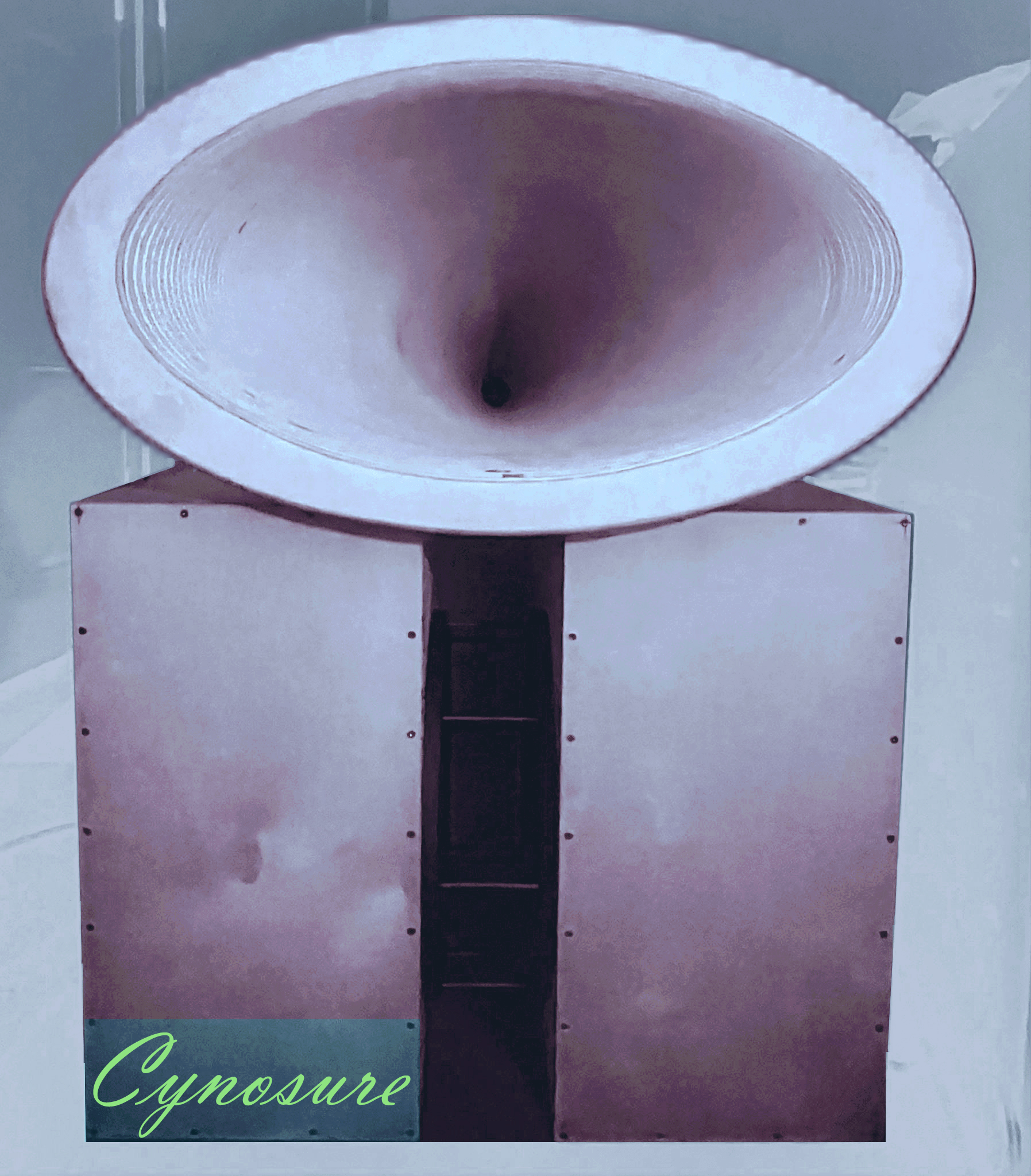

Regarding that Iwata horn you posted, even if I could ever find a pair (and if Troy would agree to use it to finish my speakers), it's clearly too big for my woofer cabinets. I don't have the cabinet depth but here's Gary Dahl's sketches attached. As per my latest chats with Weltersys, cabinet + horn/driver depth vs. listening distance can be problematic for bass response (100 to 70Hz range) unless I can place the cabinets a distance from the front wall to avoid 1/4 wavelength imposed bass cancellation. Therefore, I can only choose a horn with so much horn depth. However, from his last message Troy Crowe was offering me these horns at a better price. And as he has my woofer cabinets he must know that they will fit safely enough. https://josephcrowe.com/products/3d-cad-plans-for-es-290-biradial-horn-horn-no-1670
Can you recommend something with very close to the same or smaller depth?

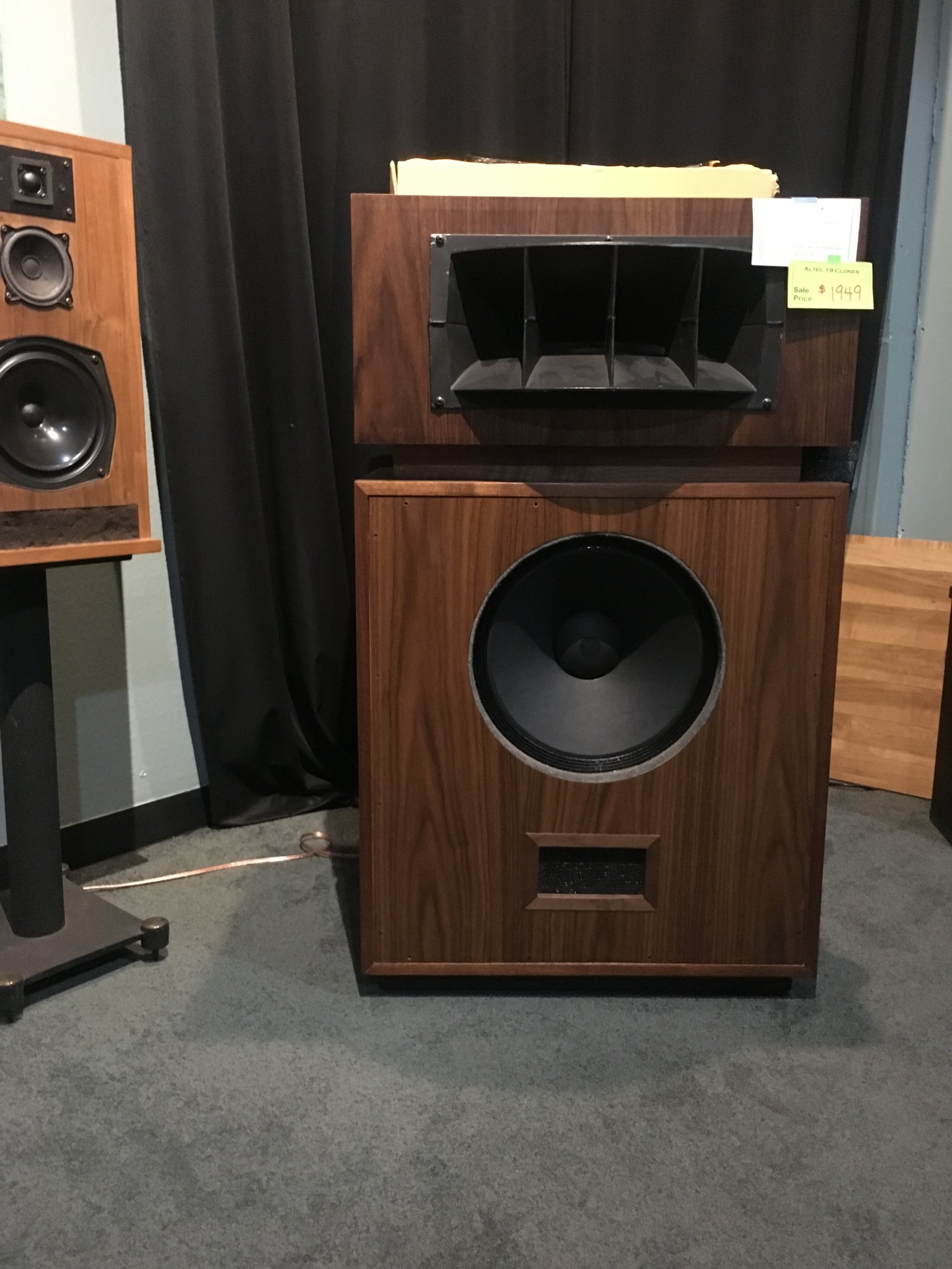

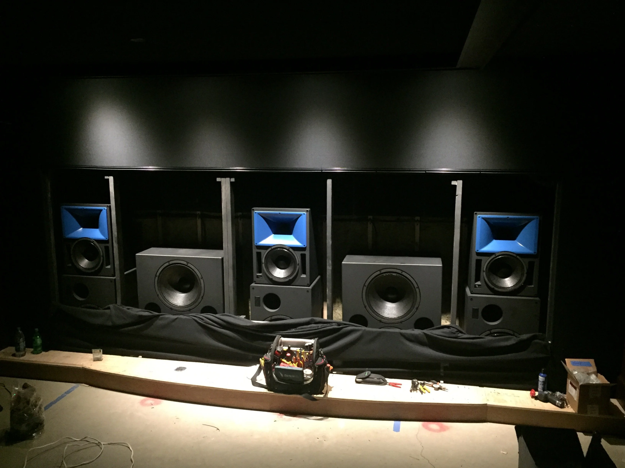

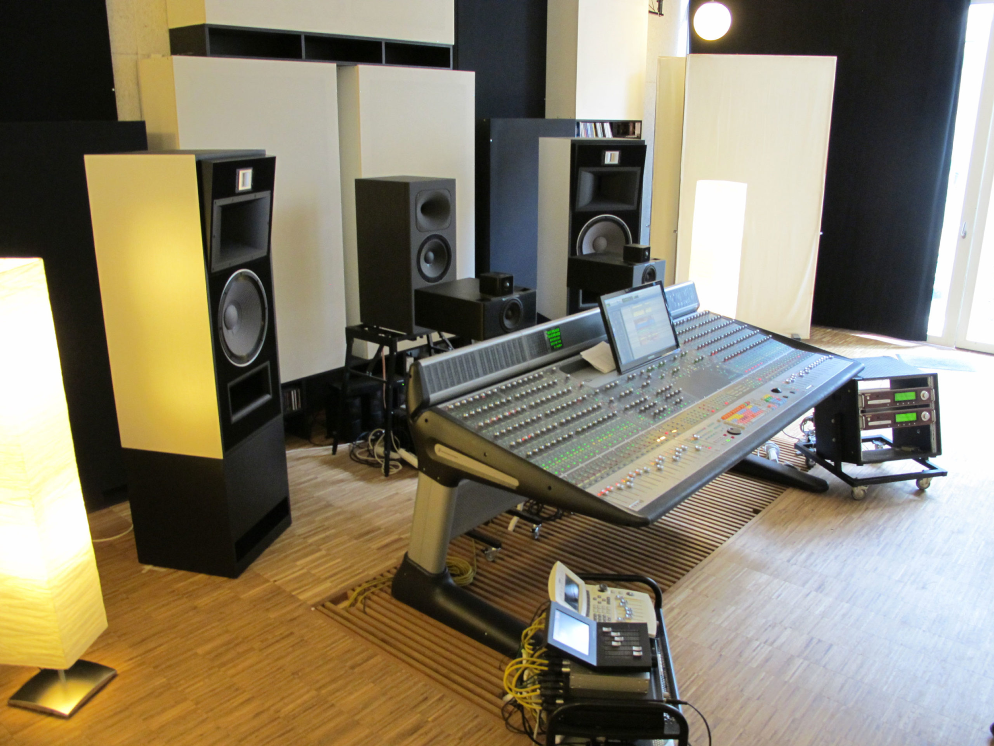

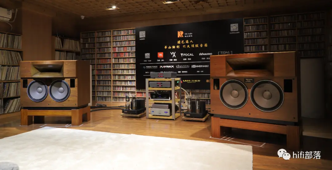

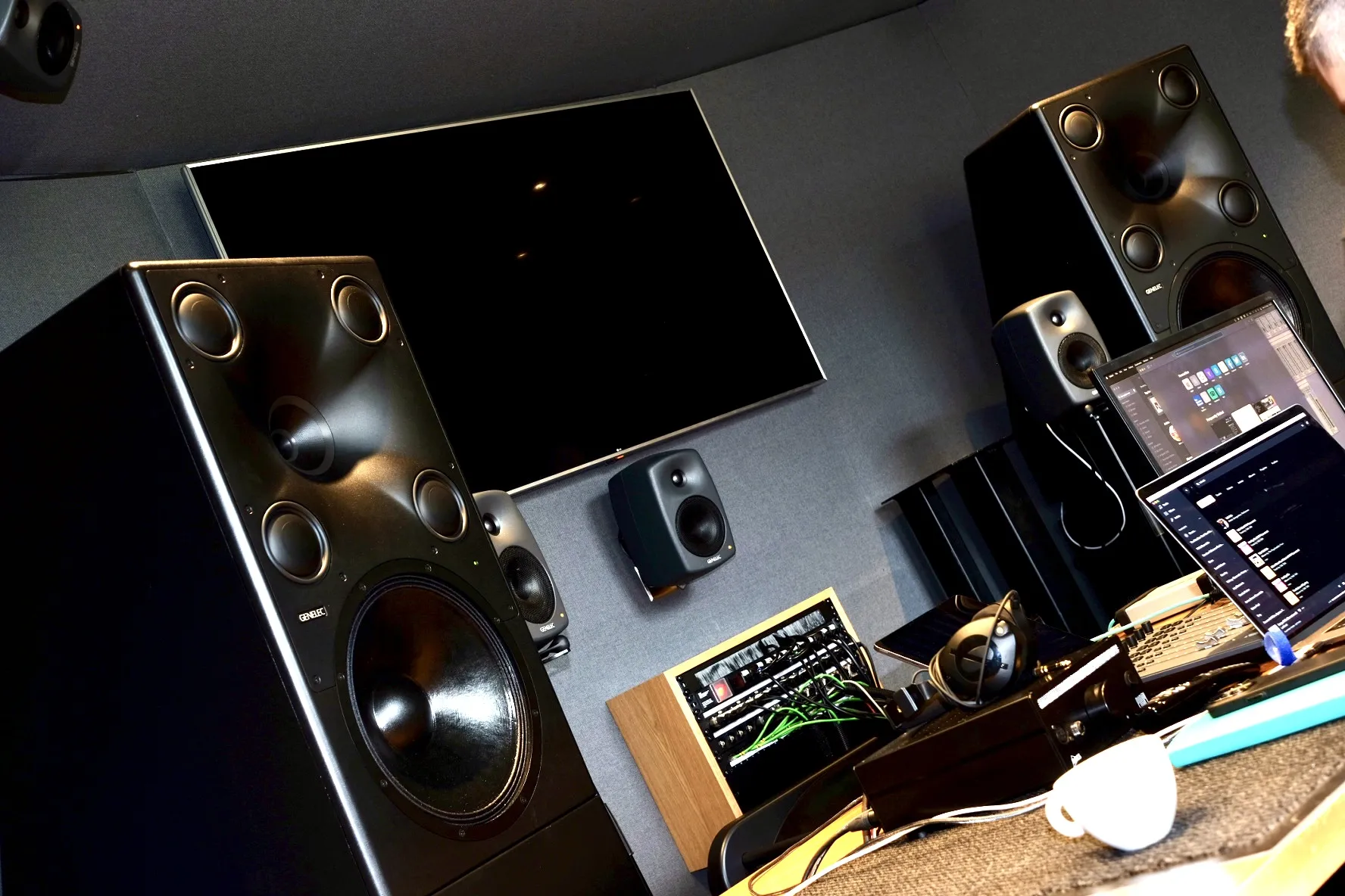

Horns and waveguides are where its at. Period. You spoke of studio gear, here is the Meyer Blue Horn mastering monitor, its just not that special since we all have similar performing systems. Buy it from them at 64,000 a pair or realize that performance isn't always a direct reflection of performance, rather, a reflection of the market its selling to. At the top of the food chain, price to performance gets really strange. There are particular PA 2 ways that after some tuning with DSP, are relative to the performance of these monitors, but only cost 3k or so a pair.

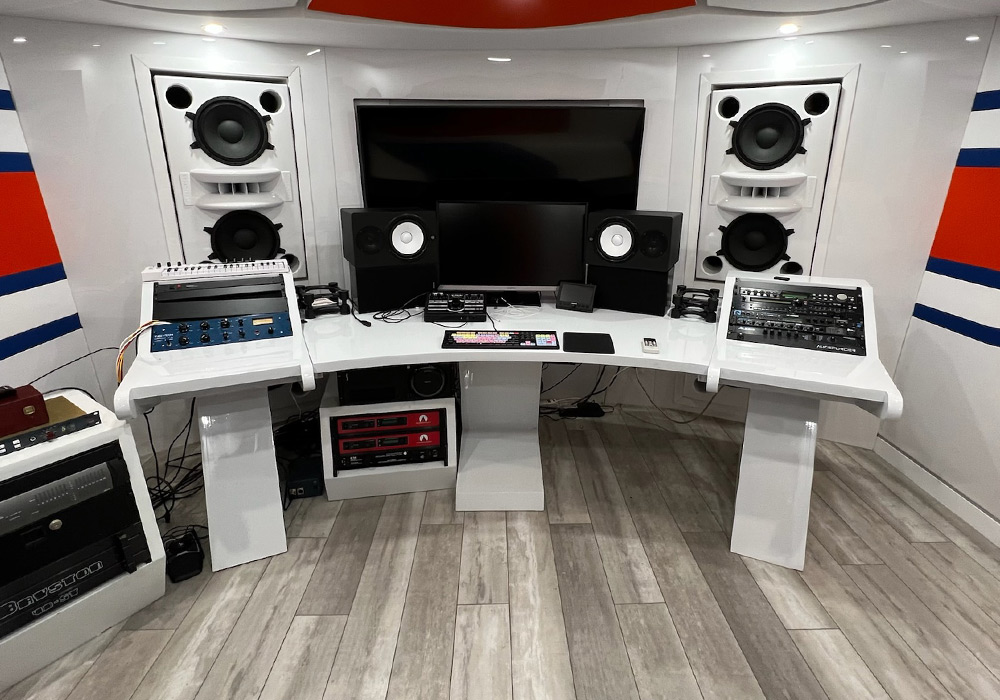

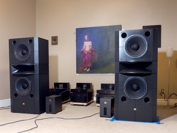

Or you could spend 100k on something like this, something that I would never touch with a stick... Don't you get it? Try to find some polars on these bad boys lol.
Oceanway
JBL m2
Augspurger
Strauss
Tom Danley
Genelecs newest
Tad
Altec

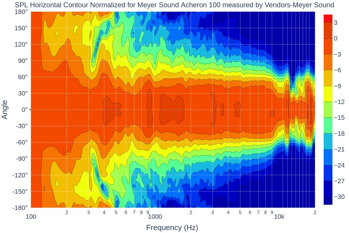

Meyer
Bonus! Meyer Blue Horns Polar! Look familiar? This polar isn't no better or worse than many of polars you've already seen. Yet the for one of these monitors you'll drop 32,000 easily.

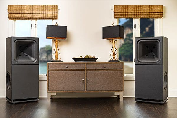

This (First 2 below Below) is the closest products I can find to my horn. My HF probably narrows more. Rising DI isn't the final detail, How much is it rising.? Not a lot. My Horns DI is likely higher in the upper HF but oh well.
Round 350 tractrix
Elliptical tractrix LH142
That one guys "Next Gen" Bi radial.
The Tad horn
Jmlc_petf_300
Somebodies Tractrix Horn
ES290

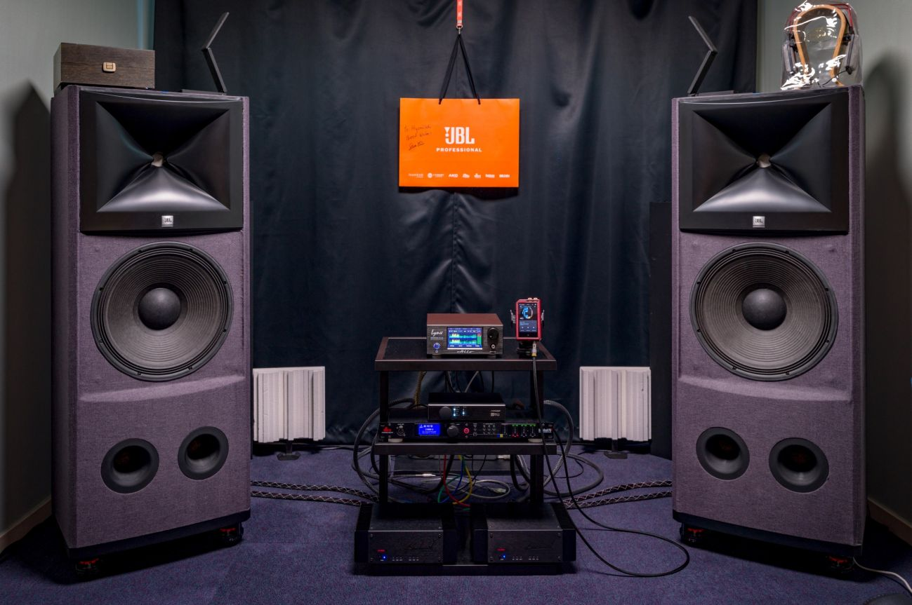

Small correction: these aren't Oceanway monitors. They are JBL M9500: https://audio-database.com/JBL/speaker/m9500.html
Otherwise, excellent post! It should be pinned to the top of this thread.

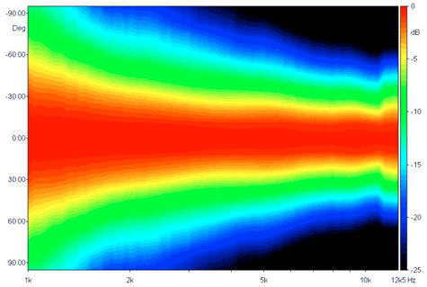

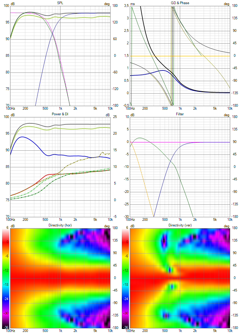

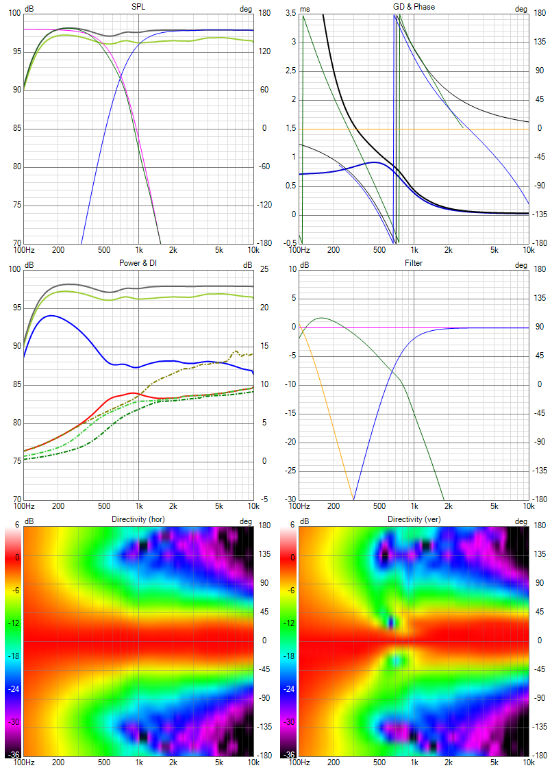

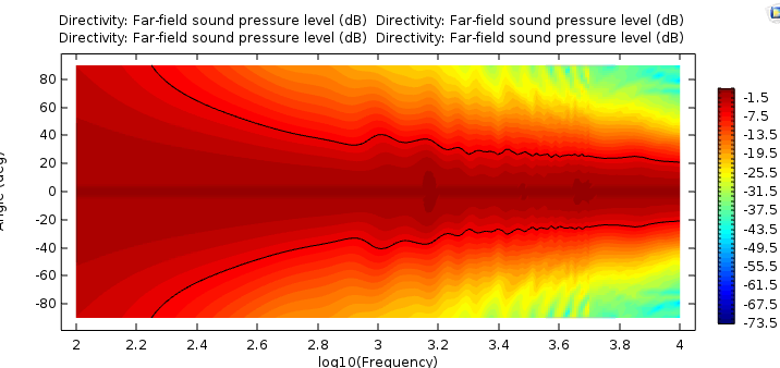

Matching polars at crossover has nyance to it, which directly affects off-axis nulls and smoothness of DI. Because, if DI of the drivers at crossover matches exactly, sound to all directions is almost exactly equally loud, which means near perfect destructive interference on vertical axis, which means more sound power is lost, which makes dip in power response and peak in DI.
So, it's actually better to have directivity mismatch at crossover to cancel less sound to get smoother DI?🙂 But, this of course shows in off-axis response, so choose which one is better per application 😉 whether it matters at all. Just something that gets touted around, while kimmosto for example has said this stuff multiple times I think.
Example, simulated 15" and 30cm waveguide, and the other image is the same waveguide but scaled bigger to 46cm make matching DI with the woofers. Overlays on the power / DI window are:
lime green is big waveguide, dark green the small waveguide, brownish green is the ideal 15".
As seen, the smaller waveguide results smoother system DI because the directivity of waveguide doesn't match the woofers at crossover. c-c distance adjustment deals with the same thing mostly, smoothing DI by adjusting how much power is lost in vertical axis, while horizontal stays about the same.
Sorry, edit time over and the post is incomplete. Forgot to mention the waveguides are freestanding and axisymmetric. Overlays in the power DI window are DI of the woofer and both waveguides alone demonstrating what's their match at crossover. Red line is system DI. Crossover is LR4 at 700Hz here. All other settings in simulation are same on the two images, except the waveguide (measurement data). The first image is smaller waveguide (30cm diameter) and the second is the bigger one(46cm dia).
I also failed to mention, that idea of matching directivity usually means ideal where horizontal system directivity is smooth without a jerk around crossover, like in case with ~beaming woofer and ~omni tweeter. Here I illustrated that there is some playroom within this ideal and rule of thumb. Both examples in my previous pist yield system with smooth horizontal directivity fulfilling the ideal, although directivity doesn't exactly match, literally.

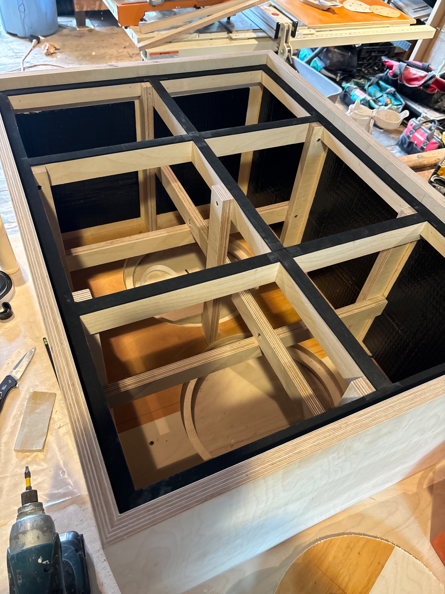

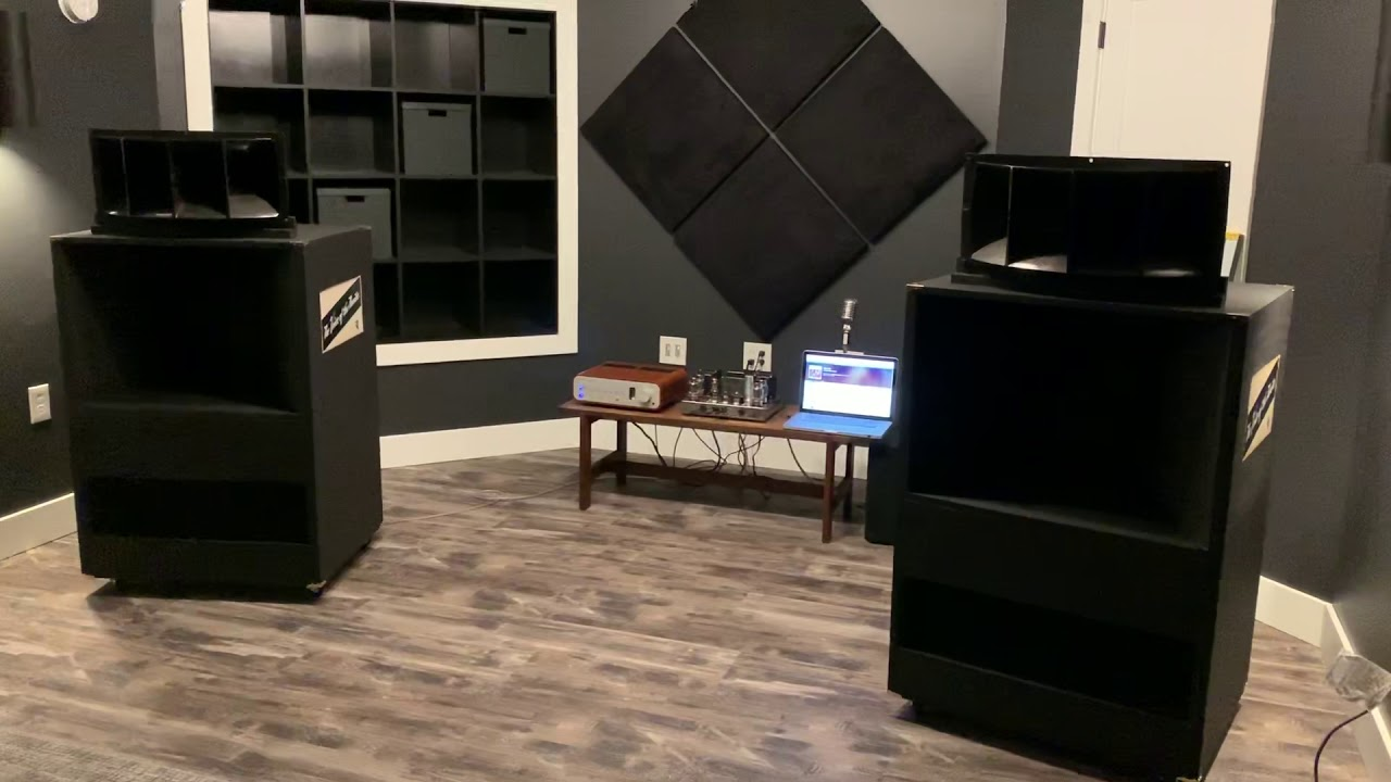

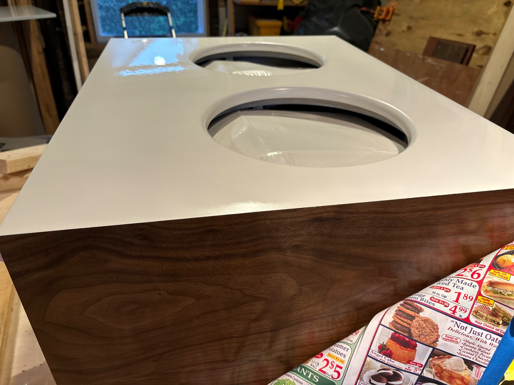

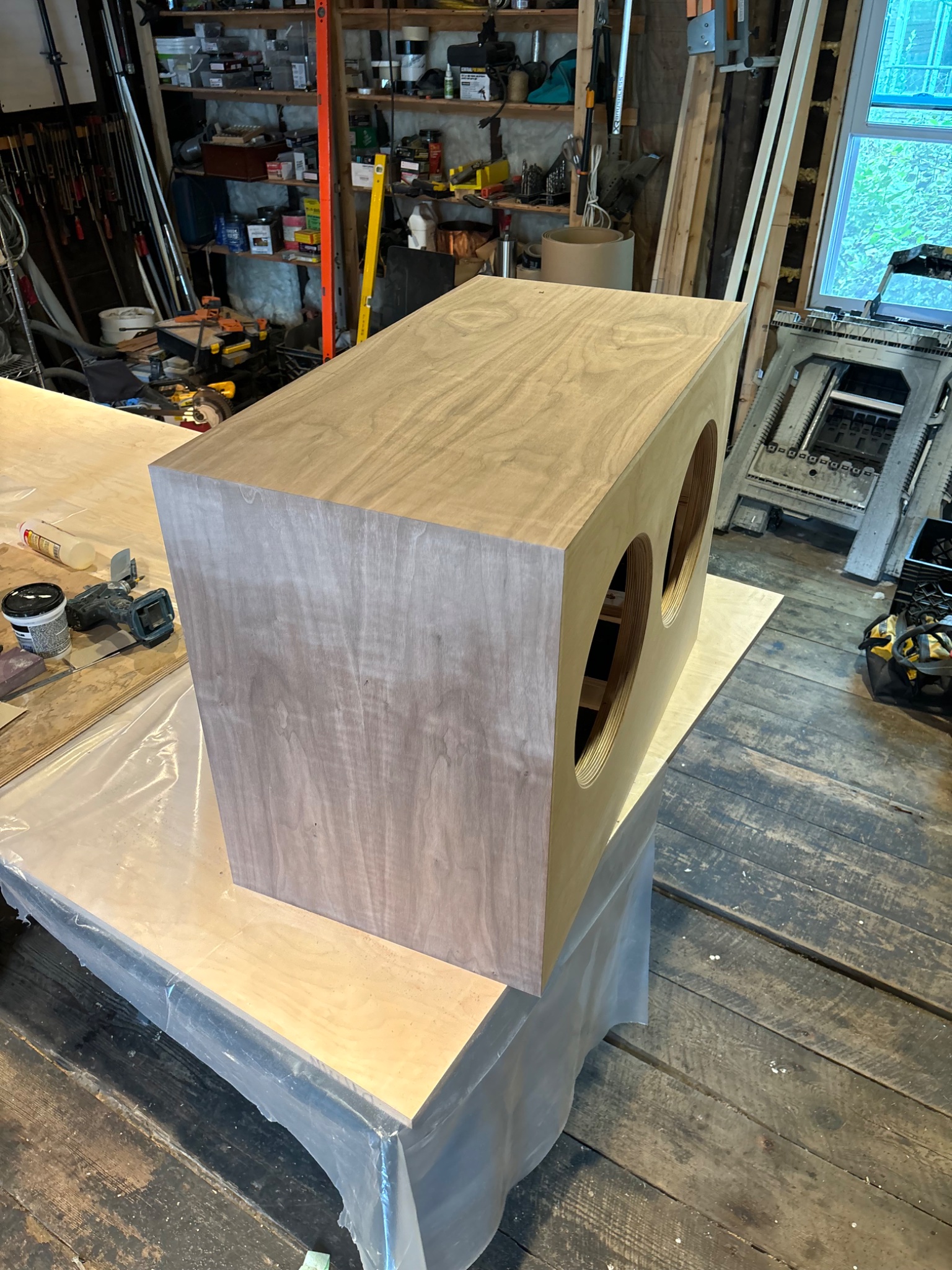

Just finished this build up with @Bryan S. I designed these with a lot of inspiration and knowledge learned here from you guys so thanks!
Dual sealed Beyma 12br70s 25hz-500hz
Azura AH-340 with Faital HMF200 500hz-5khz
Azura AH-1100 with Faital HF10-AK 5khz-20khz
Triamped and using the Sublime k235 analog active crossover
Huge thanks to @Bryan S. for nailing the cabinets and @martin seddon for the horns
