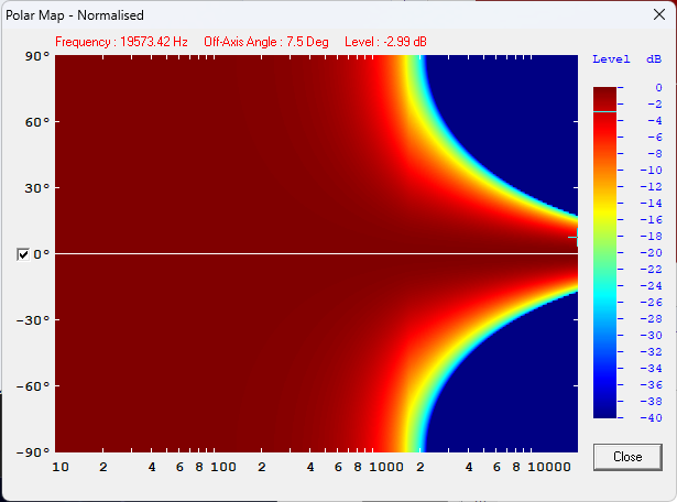

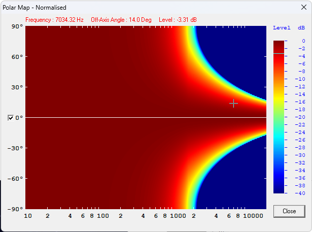

A system with rising DI can be equalized for a particular response on or off it's central axis, but that response will only "address" that particular axis.A system with a rising DI can be equslized on axis. EQ isn't used to address anything off axis, period...
A system with constant directivity can be equalized for a particular response at any axis, and the response will "address" anything within the range of it's constant directivity...
Large sizes are not required for high efficiency and high directivity.Large sizes are a require to create high efficiency and high directivity.
Large sizes are required to control directivity at low frequencies.
The JBL 2402 has high efficiency, 110dB 1/w/1m at 20kHz and high directivity at high frequencies with a horn mouth diameter of 79mm (3.125 inches).
Like any rising DI horn, it's response varies across it's beamwidth, so if equalized for flat response on axis, it's high frequency is progressively reduced off axis, sound going from "bright" to "dark".

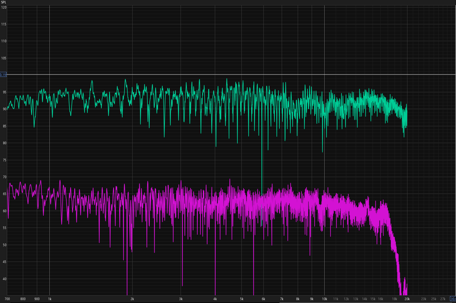

I have gated and ungated single system measurements.
The more hair, the more comb filtering. I am not going off of subjective or psychoacoustics, I am just being objective to the measured data. A fair comparison would be in the same room, same positions, etc. You said you did this comparison and I hope you have and can share the data.
Group Delay shows arrival performance as well. The more consolidated the GD, the better.
no its not. Its the result of comb filtering and reflections create it. The more reflections, the more comb filtering.That saw tooth is typical of any measurement with high resolution say 1/24 as an example.

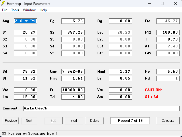

A horn/waveguide that is towards its low end, 60 degrees wide but rising DI as moving towards HF might be another happy median.
I think my top end is somewhat similar but what happens is the smaller horns open up faster. My horn is ~36" deep and wide. I went with an elliptical because I wanted to keep center to center spacing down. So my sweet spot size is likely similar as the jmlc horns actually seem to have a slightly more narrow pattern than tractrix, up top. Then again that can be designer specific. I have a 300hz elliptical tractrix also, its about 15" wide. Probably will sell it as it was a sort of test run before buying the big horn.Also, while it might be a silly question without comparing polars and other measurements, your horn's shape at least suggests that it may project a wider sweetspot than, say, the AH425. If yes, why might that be desirable rather than not, at least when for solo listening?
