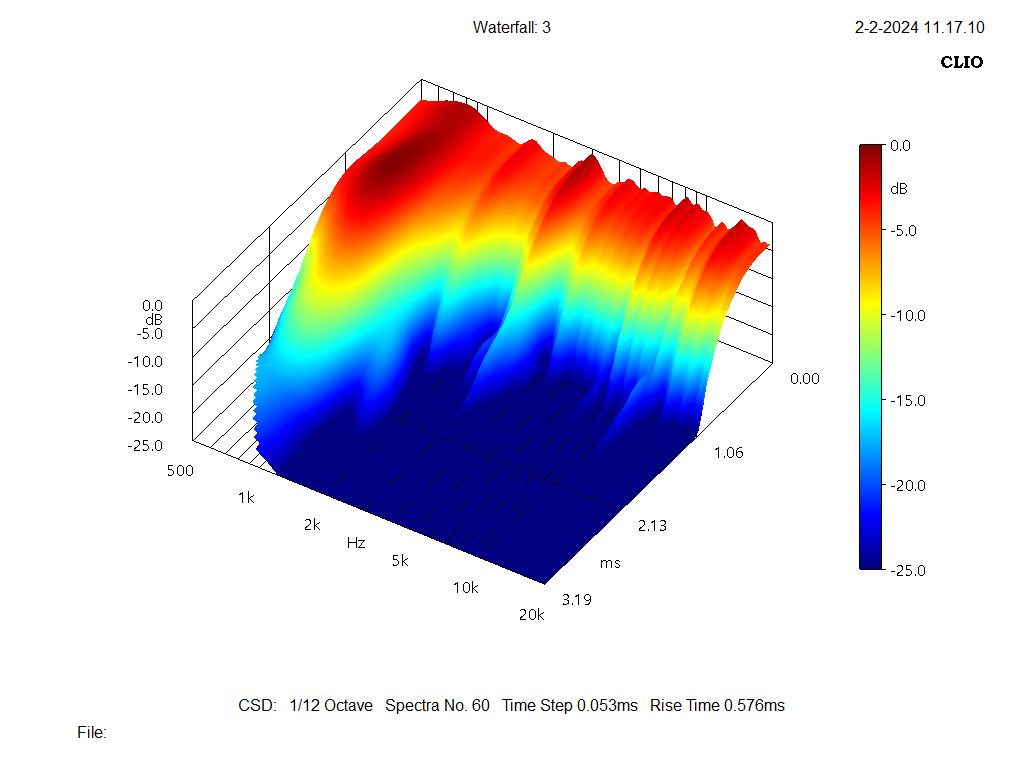

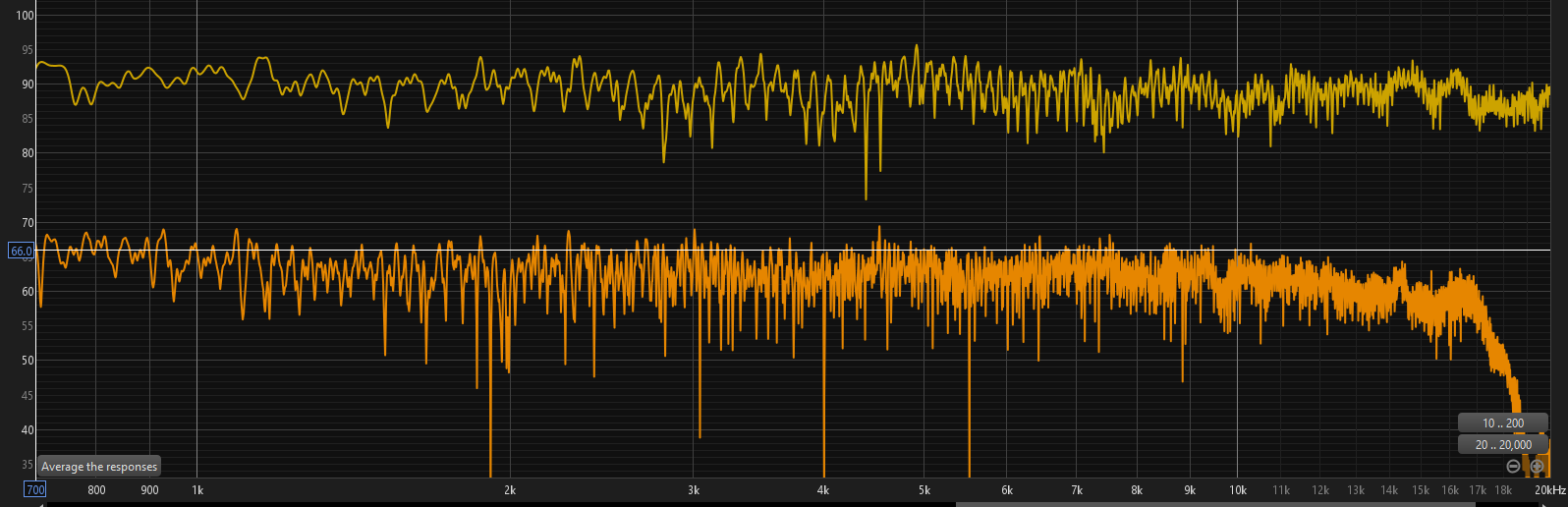

You have done what I wish to do. The best I could do is source measurements of an Gedlee Abbey and the comb filtering was much higher, at a lower spl and closer distance than my measurements. Both rooms had hard surfaces, and the Abbey room had some acoustic treatment. my take away though a very crude comparison, was that the wider wall angles simply caused more comb filtering.
The abbey at 30" and my horn at 36"? though possibly 54" we'll say 36" to be safe
You said you compared? Where are your measurements???? Ears lie measurements don't
Why would you see that in the impulse response which is gated before the reflections can pollute the measurement? Like a CSD as an example.
First sorry for the miss typings in my reply above. I had only been awake for about five minutes at that point. Also did not check the window setting on those measurements, to make sure that they were identical. Normally, I set the right window to 500 ms.That is plenty enough time to allow reflective data... I think.
I am not talking about a raw measurement. A gated one like 5 msec for CSD or period limited for Wavelet. If you are using a raw 500ms you are going to have all type of reflections in the measurement. Are you including the room response?
Is that a Stereo pair?
A single with reflections included?
What are you using? Rev? I use CLIO 7.11 and CLIO Pocket 3.
What smoothing are you using? That saw tooth is typical of any measurement with high resolution say 1/24 as an example. Why do you say it's comb filtering which is basically benign in many cases.
How are you quantifying what you posted is indeed comb filtering and determining how audible it is?
I have gated and ungated single system measurements.
