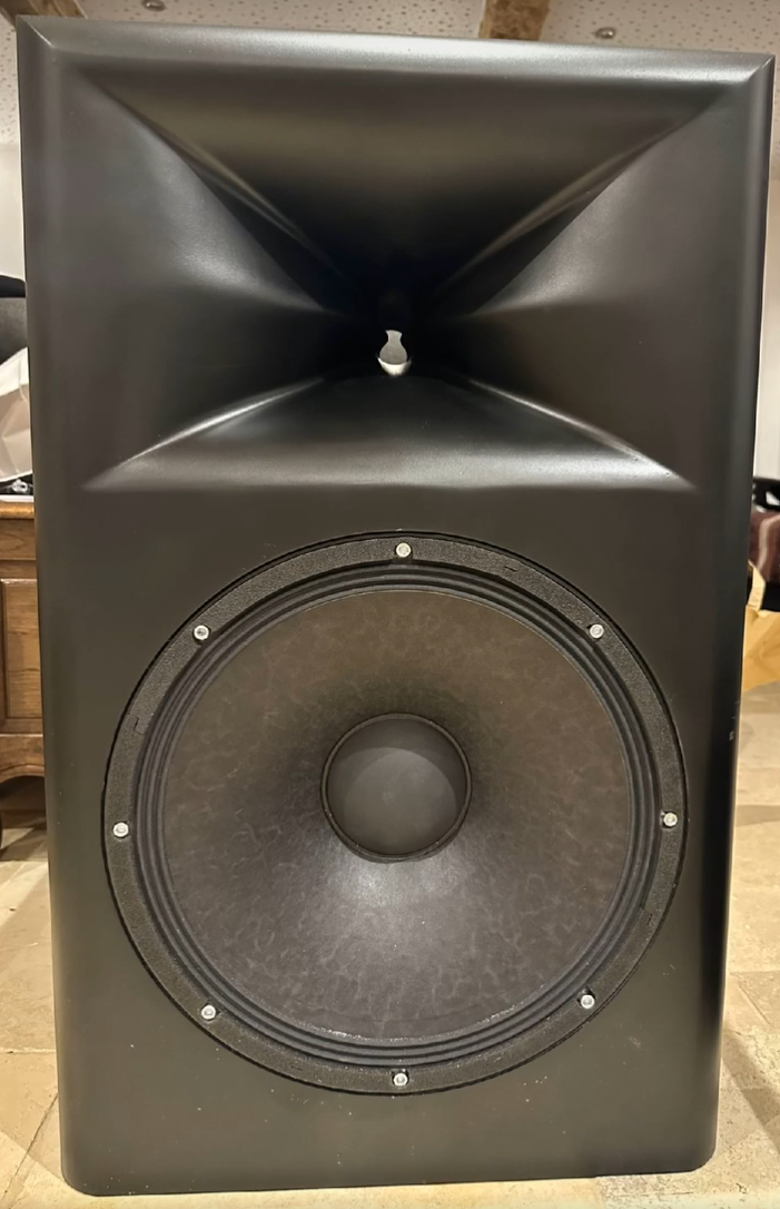

Btw, I like your work. The upper speaker has a mirror like surface and seems to be very even. Maybe a nice option for @Oltos if you offer to help him.
Funny story with that gloss-I was having horrible issues with the teak veneer, coat after coat there were hundreds of waxy dots migrating through the finish even after washing the veneer extensively with acetone etc. After 5 or six coats and sand-downs, I switched to a different varnish and it worked to contain things. So I returned to my satin varnish and it looked really good after I applied it and I felt so happy and relieved.
Came back 2 hours later and was shocked to see the varnish was still completely wet and shiny. That’s when I realized I hadn’t stirred the varnish for 3 days and the matting agent had all settled out. I really didn’t want gloss but at that point I was pretty over caring.

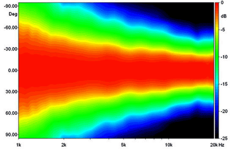

Yuichi A290 is no biradial horn and ES horns still beam considerably.
While the Yuichi isn’t biradial it’s shape is almost/ a close variant; and Crowe’s ES horns are basically a variation on the Yuichi

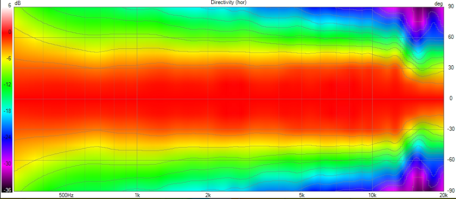

Where are the graphs that show the considerable beaming?
This appears to come back to my point that people vary in at what point they call a dispersion pattern beaming
Beaming in the sense that Crowe's horns have increasingly less constant directivity with increasing frequency? See these plots.
https://cdn.shopify.com/s/files/1/0...BMS_4591-8_off-axis3_480x480.png?v=1649504045
https://cdn.shopify.com/s/files/1/0...ot_2023-10-14_170306_480x480.png?v=1697317415

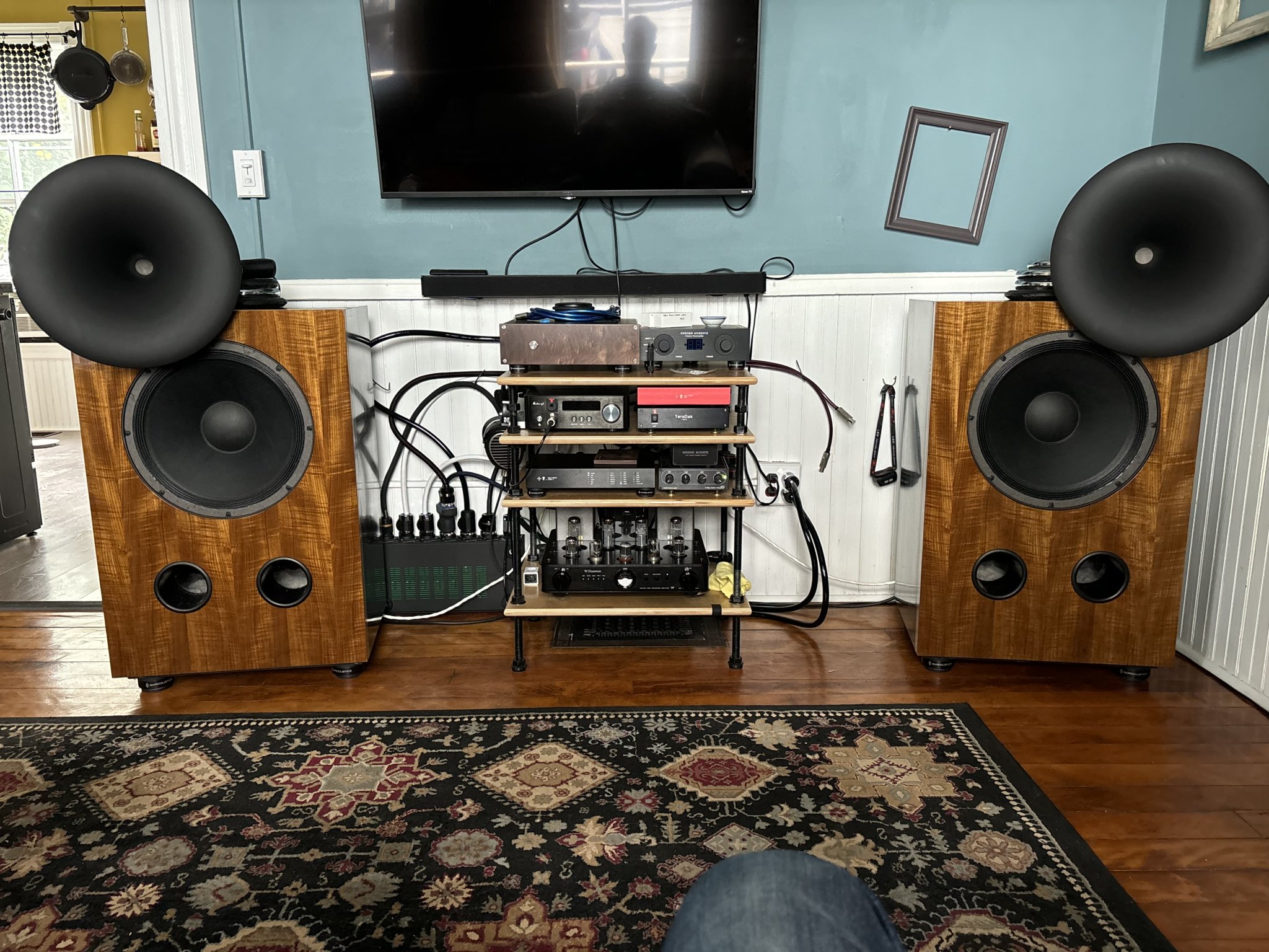

A big thank you to the members of this forum for making available such an amazing resource of knowledge. I would have probably not been able to do it otherwise.
Here's a photo of the wall of chaos (must be a mile of cables behind, violating all proper cable hygiene laws:
https://www.diyaudio.com/community/attachments/img_6718-jpeg.1355887/

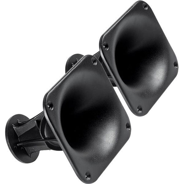

Two guys using their 425 horns/15" cabinets for TV audio. HELP! I have to decide on a 55 or 65" Sony TV before Dec 31st or I lose $1200. in Sony card points when the Rewards program terminates on that date. I'm looking at getting this beauty. https://electronics.sony.com/tv-video/televisions/all-tvs/p/xr55a95l
The current problem is that I don't want to use horns with a size, shape and/or color
https://josephcrowe.com/products/3d-cad-plans-for-es-290-biradial-horn-horn-no-1670 that shout at my eyes while I'm trying to watch the screen, which will be behind my black midwoofers https://josephcrowe.com/blogs/news/altec-416-8b-in-100l-sealed , and with me then seated ~ 11.5 ft away from the screen.
I do keep my living dimly lit so I guess if the 425 horns were painted black (or is that brown?) like Gary Dahl did then I may not notice them very much.
https://www.diyaudio.com/community/attachments/img_3796-jpeg.1193321/
Any other suggestions?
BUT in case I didn't want to actually paint them how else to make the horns black? Use flat black gaffer's tape?
Gaffer's tape looks fuggly, simply put a black grill cloth in front of the horn.
For complicated horn shapes, a breathable nylon and polyester spandex fabric can be stretched directly over the horn, and tacked or gaffed out of sight.

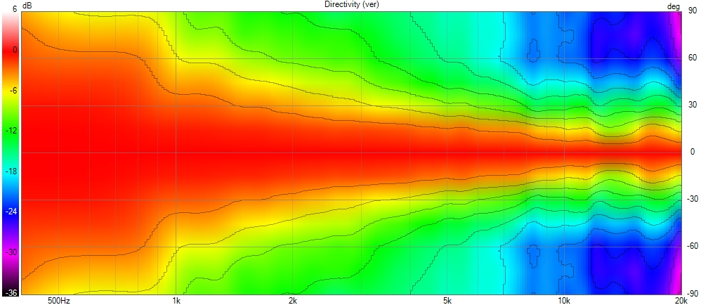

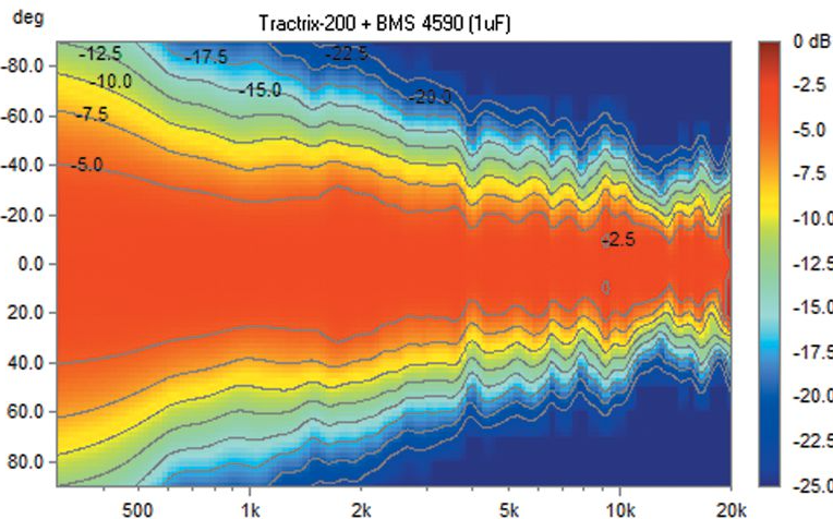

Whats hard about it? Maybe the problem is that you need to understand what the sweet spot is and why its important to a person who is interested in critical listening. The sweet spot "refers to the optimal listening position in a room, where the stereo image is most accurately perceived and the overall sound quality is best. As you move away from the center, the soundstage will gradually lose its focus, the tonal balance may shift, and the overall clarity and detail may diminish.". Lets focus on Tone, since that what Constant Directivity seems to be about most. If Voicing starts to change, as one moves away from dead on axis, you can say you have left the sweet spot. I personally like to use -3db. Similar to F3, -3db being significant in the terms of a change in spl. I also chose to look at the most narrow beam which is at 20khz....actually I looked at 17khz since I don't think I can hear above that. When 17khz dropped -3db from 0 axis performance, I said this is the end of the sweet spot, and recorded the beam angle (In simulation at this point)... Later I was told by some design professionals on this board that I was being way too strict. Which is what I intend to do anyway but I am trying to make a point. I was told that truthfully I could use ~7000hz (IIRC) as my reference point to judge effective listening window. Case and point, anything outside the sweet spot, is unoptimal and should not be used for critical listening. I personally want to use my system for high precision EQ work. Signal Design. Hearing the signal without adulteration has been my goal
I would look at the above polar and say the sweet spot is no wider than it is at 20khz, which is about 30 degrees wide. At 7khz the sweet spot is about 60 degrees wide.

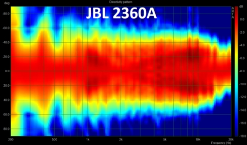

This Elliptical tractrix Horn Doesn't reach 60 degrees wide until about 6khz and is somewhere near >40 degrees at 20khz
Depending on how strict one wants to be, The elliptical tractrix horn in this example has a wider sweet spot if being literal and judging by 20khz, the top of the register. Constant directivity horns and Horns with Rising DI need to be judged case by case. I have just shown a real world example of a Rising DI horn that has wider coverage than your Constant Directivity horn. Your horn, like almost any horn/waveguide, needs to be listened to within the sweet spot in order to hear all of the signal undistorted in tone. If judging by 7000hz, both horns are Equal in achieving a ~60degree beamwidth.
So we could say the Elliptical Tractrix horn has Wider or Equal Coverage.... There are other horns that have non Constand Directivity that provide wide Coverage.
The only Waveguides I've seen keeping Constant Directivity to 20khz is probably Mabats which I think require a modified phase plug. My point, again, is to show that your comment "it's hard to give a coverage as it's never the same according to frequency, it narrow more the frequency goes up." is simply wrong, evidence being, I quickly pulled up a waveguide with wider sweet spot, than your CD horn, Sweet spot, being the beamwidth in which Frequency response stays with -3db of dead on Axis, according to my strict definition of the term. So we can let go of this idea about coverage.
Coverage is specific to a specific designs. One could build a Constant Directivity horn with the intentions of maintaining a 20 degree beamwidth. Constant Directivity is an design type that has no requirement to reach any particular beamwidth.
For critical listening, staying in sweet spot is whats desirable. The off axis performance of the system only needs to happen smoothly and free of large peaks/nulls, an excellent example would be something like below. This prevent the room response from being colored in a way that have any one particular note stand out be be hidden versus another. Every polar in this post, fits that criteria
Below is a Tractrix 200 from autotech, God knows what 200 means but non the less, This is a more traditional design where DI reaches higher than what We are seeing in Contemporary horns and waveguides. From ~4000hz on up, the beamwidth of the sweet spot is 40 degrees and diminishing. We know that above a certain frequency the Compression Driver owns directivity. The BMS 4950 is a modern driver and creates a ~20 degree beamwidth by 20,000hertz.
Your horn has the slightly wider coverage as this Horn in the most strict sense. If we relax the criteria we can easily say your horn has wider coverage. The Tractrix Horn shown above, maintains a higher DI than your horn over a larger part of the spectrum. If we place these 2 horns in the same room. Your horn will accommodate more people more people to hear the same frequency response. The Tractrix will only provide the intended to a very small audience. If using the strict expectation of -3db at 20khz, and 1 meter distance, the tractrix basically becomes a 1 man experience but then again so does yours.
If we look at 7000hz and -3db instead, which is what is supposedly commonly accepted for Quality sound, it becomes 40degrees vs 60degrees. 4.37ft coverage vs 6.93ft at 6ft.

All bi-radial is narrowing like this vertically by nature, mine is free of accident, that is not the case of old ones, bi-radial don't excite floor and ceiling, and all need to be listen at a relatively fixed position in height, they all have a sweet spot vertically due to their behavior bellow 7kHz, but not horizontally.
Our room and our physical hearing system is asymmetrical by nature between horizontal and vertical, it should be taken in account but it not means there is only one ideal solution to deal with it and we have to be careful as in fact our brain already corrected some things.
If you want a horn that provide no sweet spot on both axis, huge loading and stay close in terms of center to center spacing with the woofer, as you apparently know well my website, take an X-Shape.
It's a matter of preferences but it's important to be constant horizontally in the plain audibility range as I or other specialist or acousticians said.
And to remember that energy is not free, if she is present somewhere , she will be less present somewhere else.
