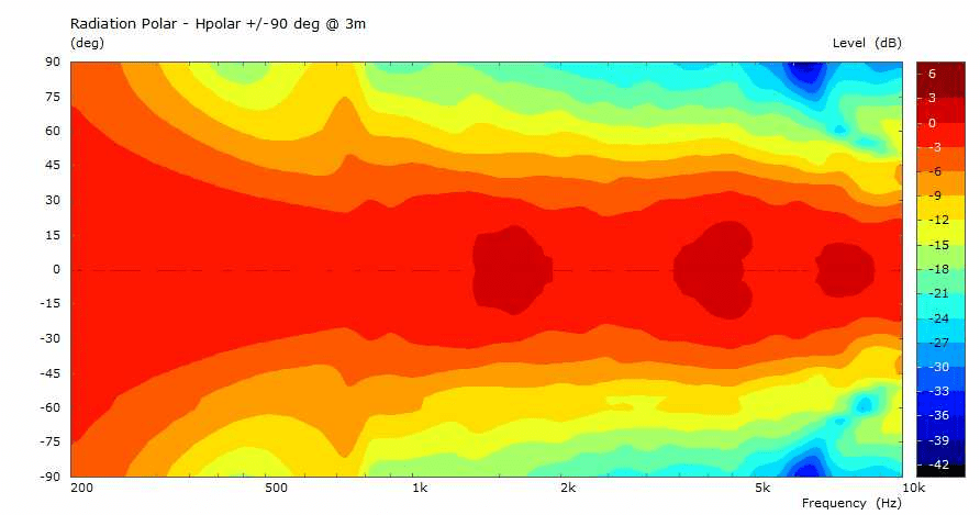

From little I know of horn design (zip?) and performance, I could say a horn would directivity at least this constant from ~ 550Hz on up. https://www.diyaudio.com/community/attachments/1726661699779-png.1357794/What are your thoughts on deciding this first, eg what angle do you want at each frequency, then discovering the curvature that produces this for you?

An example of one of many subjective EQ preferences dependent on listening angle for horns without constant directivity.What sounded best to my ears is an EQ circuit that attenuates lower frequencies by about 10 dB relative to the driver’s output at 15 kHz. The resulting response is flat-ish around 10 degrees off axis, and rises about 3 dB on axis. My hypothesis is that the rising on axis response subjectively makes up for the narrower HF dispersion pattern of this particular horn profile – which is not constant directivity.

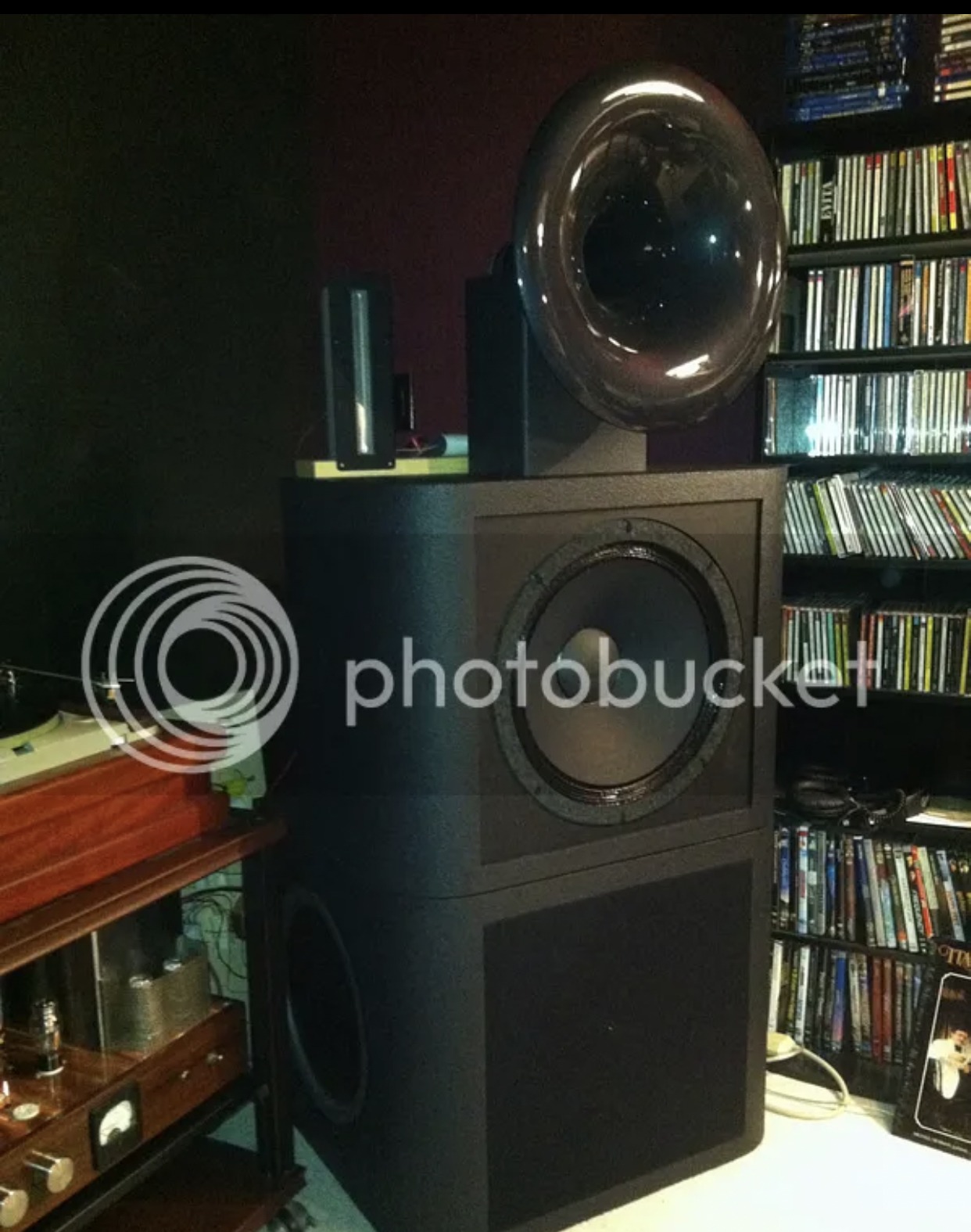

Even though I've now handed off high tweeter duty to a pair of Faital HF10AK drivers in AH1100 horns, the Rosso 65CDN-T in the AH 425 is what I was running prior and still am up to 7Khz. I'm actually considering going back the the 2 way, it was so good. I'm thinking something was lost in adding the second horn, especially imaging. @oltos if you already own these horns and drivers, just set them up and have someone build you a pair of cheap boxes for your Altecs and be done with it, or at least use it as a starting place as someone else suggested. And you might want to consider a Sublime K231 active crossover, they're relatively simple and might cost less then a passive. These drivers are really well behaved in the AH425s and there are options for room correction filters that can sweeten the pot at the end of it (or just don't worry about it).
Cross them at 700-800, or get Troy to print you out his rear covers for the Rossos and go to 600 if you like. This will sound excellent and probably beat the hell out of most of the old school horn combos people pay way too much money for although I admit if I had the room I'd own a pair of VoTs just because they're so sexy and iconic.

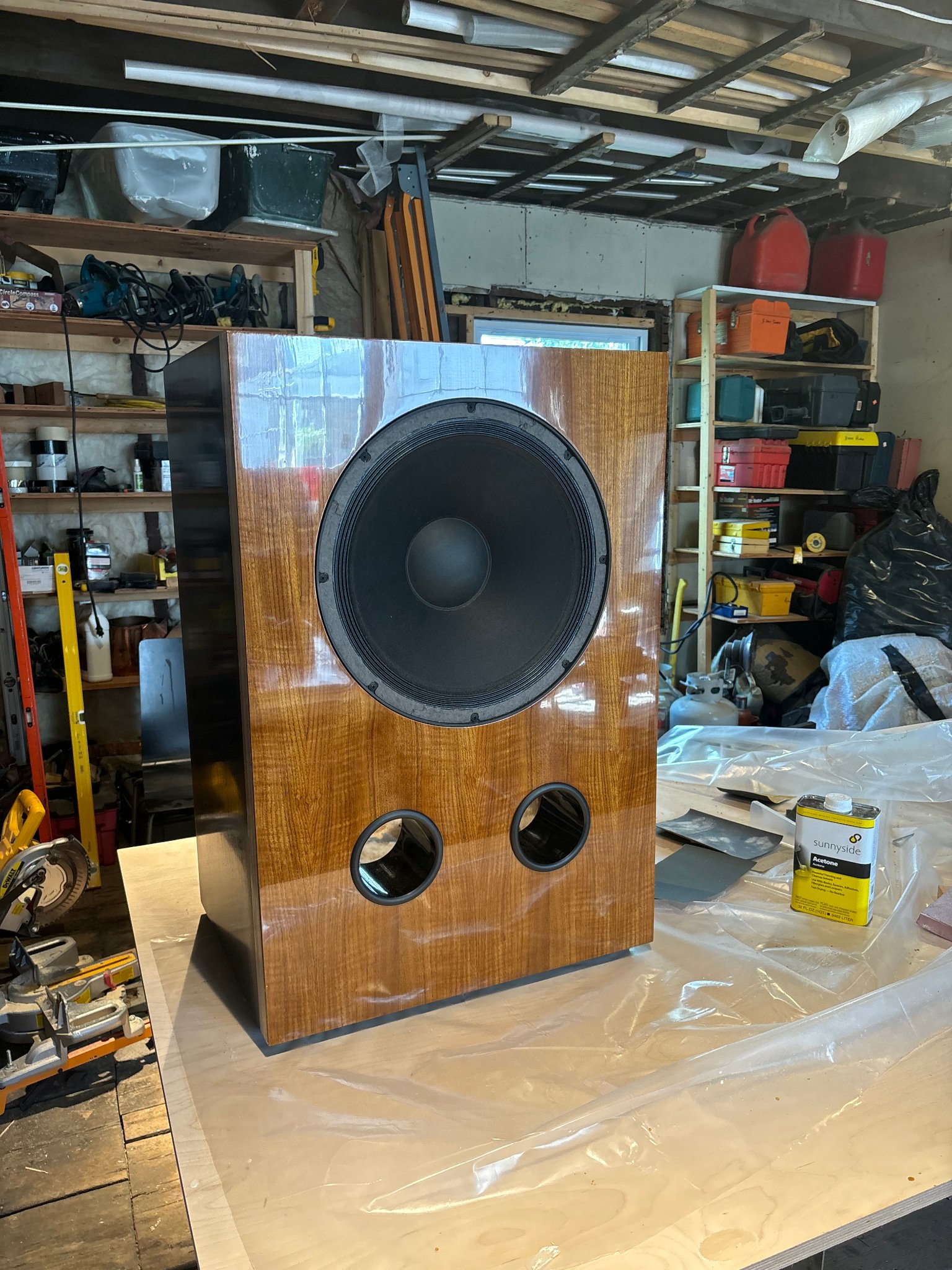

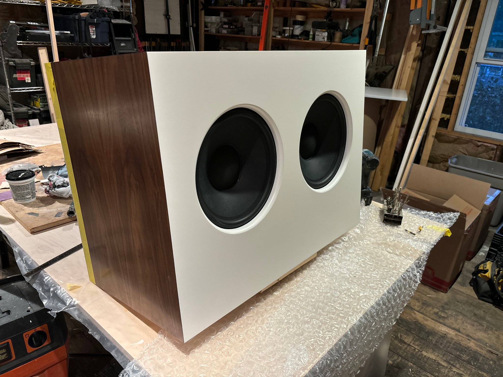

Ports and passive radiators....? 🤣😱😡The second picture, are these passive radiators in the back or is this a different cabinet/speaker?
They’re two different builds, first a single 15”, second 2-12” AR.@Bryan S.
I apologize if it wasn’t more clear-with the added HF horn the system is crossed at 7k, if I remove it the active module for the high cross is also removed, allowing the Rosso 65CDN-T/AH425 to play free which it does very well up to 13,500hz when it rolls off pretty quickly.Please excuse my near-total ignorance; 7-8khz appeared twice above, in consecutive, informative posts. Surely high frequency response >8khz is essential for fidelity, therefore a hard requirement for any horn/waveguide/constant-directivity speakers?
