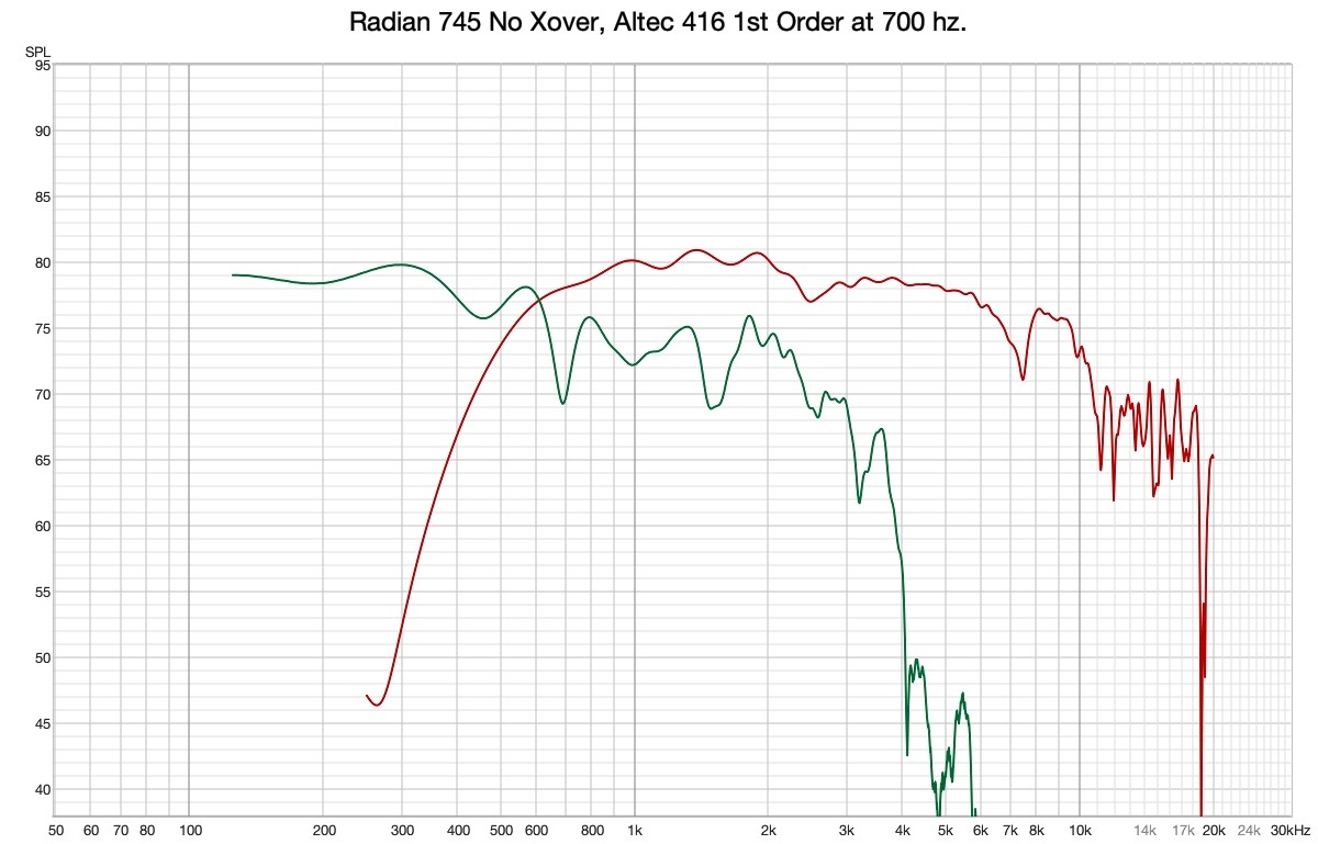

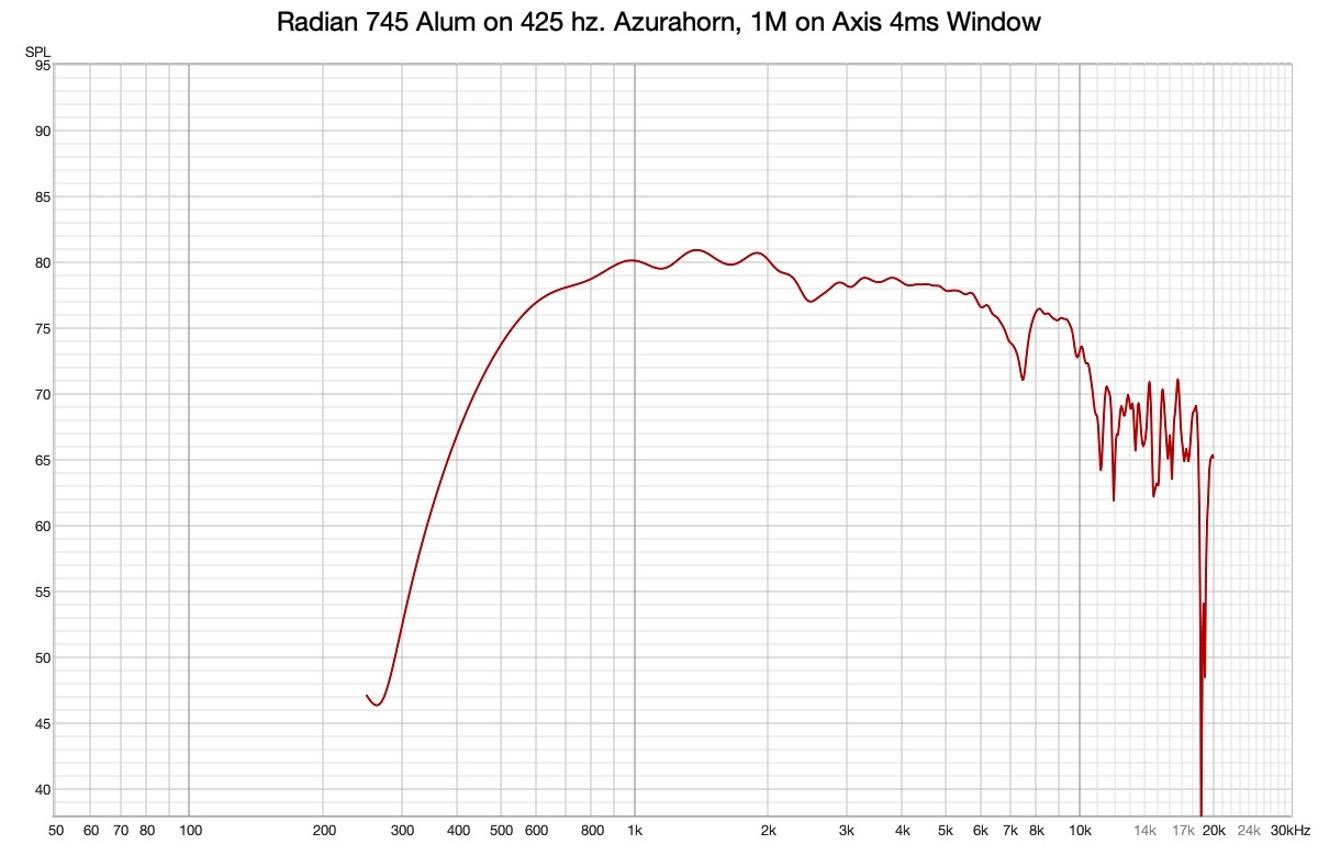

FWIW. I use the Radian 745 Neo Alum version on my 425 hz. Azurahorn. See the response below. This curve looks very much like the factory curve in the LF. I'm seeing it about 3 to 4 db down at about 600 hz. The factory shows 500 hz is about 10 db down, but I'm only about 6 db. down. This is where my knowledge also ends abruptly. I don't really know what this means for the Xover. If we say 500 hz is the cutoff, conventional wisdom might say we'd Xover at 1.5 or 2 times that or 750 to 1,000.
There's no problem with the horn hear, but the Altec 416 is still quite energetic at 1,500 hz. with a 700 hz. 1st Order Xover. I think this is why Lynn asked Troy for a notch filter. See enclosed, Altec 416 in green with 700hz first order.
So, really, at first blush from this, and in my current incompetent building, I think the woofer is doing a lot more damage to imaging, etc. than anything from the horn. Not from beaming, but breakup, etc. I'm using a Hypex FA123, so I can use steeper slopes easily, but I'd rather not, although damn if I can construct an A B test where I can hear the difference.
I think you'll find some of the old guys, the one's who've tried everything, really like to get the Xover down to 300 hz. ish, if they can for this reason. Coaxials anyone?

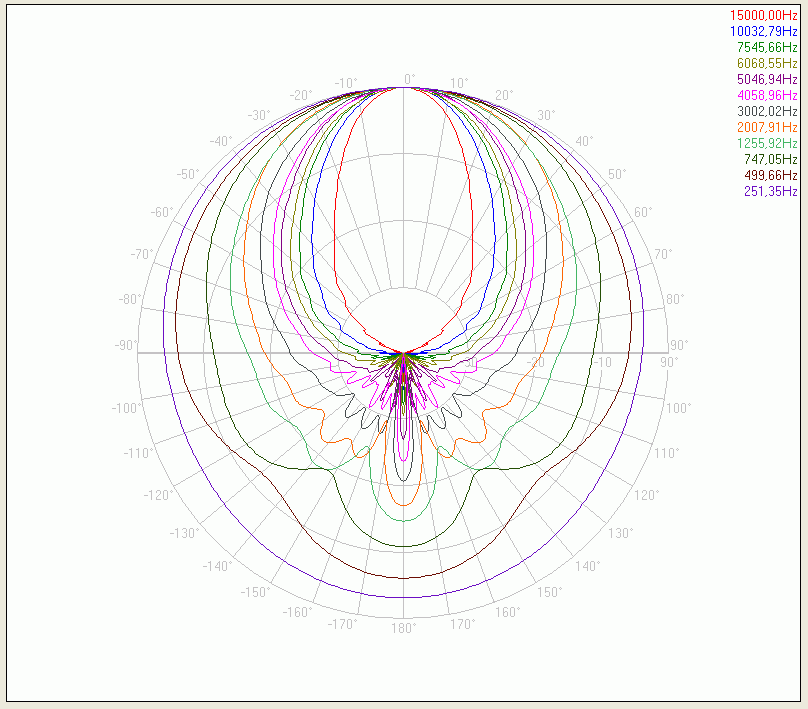

It's -6dB response is around 180 degrees wide at 500Hz, dropping to under 40 degrees at 10kHz, neither "here" nor "there", but it's "beaming" response on axis does nicely compensate for the falling upper response of the compression drivers typically used with it.
Radial horns are often designed for fairly uniform horizontal dispersion, with vertical response beaming, both "here" and "there".
If you want to choose between “You are There" or "They are Here" or something in between, chose a horn with a consistent DI over the range it's used, and EQ it's response as desired.
