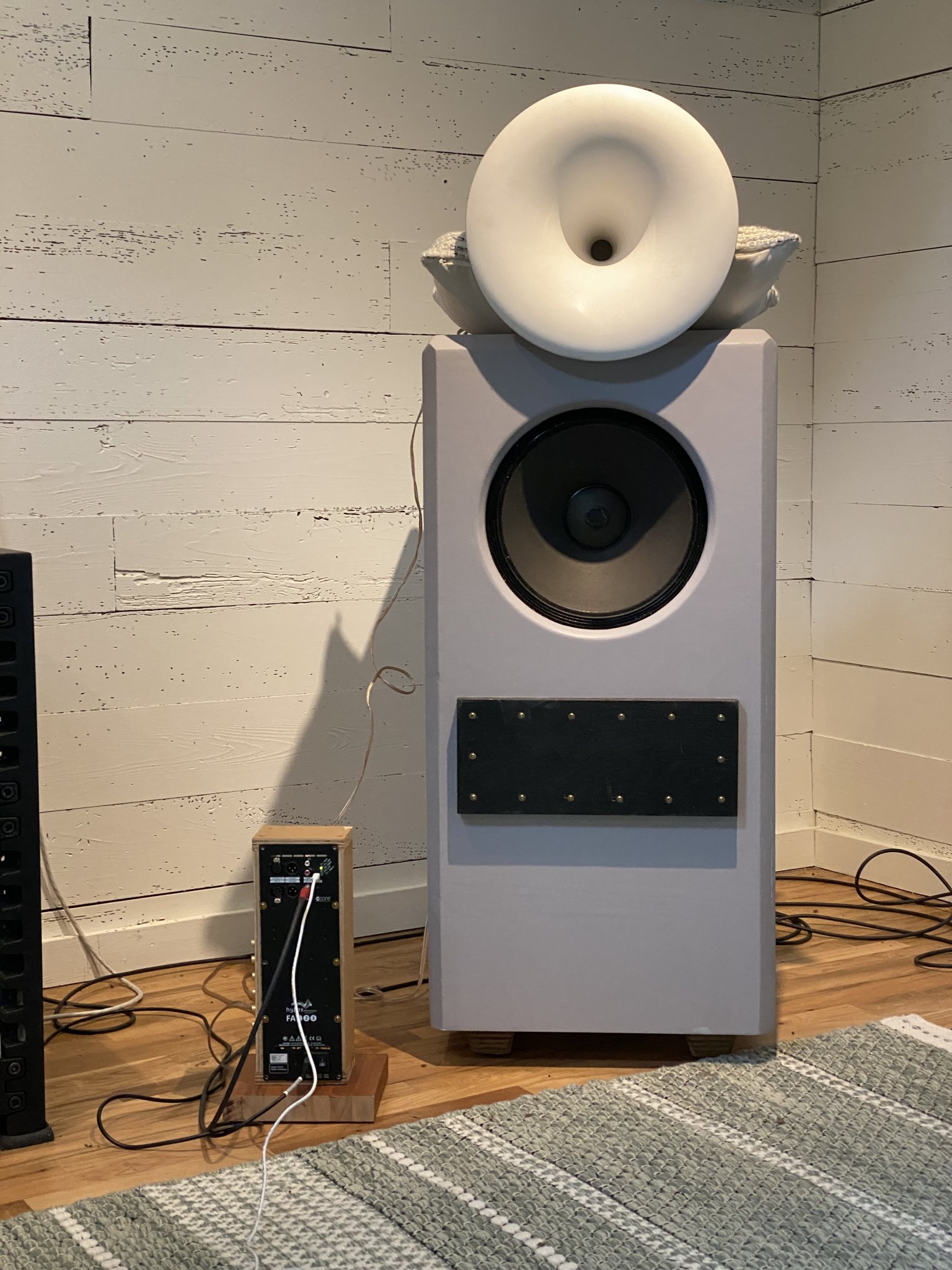

While they must sound wonderful, don't most two-way designs that you've heard produce noticeable beaming? If so in your case, is any beaming from the woofer not objectionable because the listening sweet spot is rather large, or due to other reasons?
The 15” woofer is in a 58cm baffle, crossed at 600hz. I always sit in the same spot. Maybe if it was crossed at 800 or higher it might sound more beam-y, which was my subjective opinion at the time I was dialing things in, but the 15PR400 seems to play very well up to 600hz without audible issues to my ears. It sounds very smoothly coupled with the horn (active 4th order LR). I’m actually adding another small 6” Azura with a Faital HF10AK, crossed somewhere between 3k-5k, hoping to hear a little more sparkle by breaking out the highs.
There are two possible issues here. One is the overall directivity of the system - how narrow the beam of sound it produces is. Horns as typically used in this thread (LeCleac'h style horns) with large woofers will produce higher directivity (narrower beam width) systems. The biggest effect I notice with these systems is the narrower imaging. You'll have a narrower soundstage and central sounds will sound more in the room / between the speakers when compared to a system with lower directivity. The second issue is rapid changes in the system directivity vs frequency such as when a woofer's beam width narrows at high frequency before crossing over to a tweeter with a wider beam width. These big woofer / horn systems actually do a pretty good job at avoiding this problem as the woofer and horn are roughly the same size so their beam width is about the same over a range of frequencies. For example, see the horizontal plot of my system in the lower left here: http://jhsaudio.com/images/170219_4wayJBLsystem/150104_4wayMonoData.png This is a 15" mid bass crossed over at 800Hz to a 385Hz LeCleac'h horn. You can see another issue with this type of system in the vertical plots - the large vertical spacing between drivers makes it tough to avoid issues in the vertical plane. However I don't notice those being too problematic.

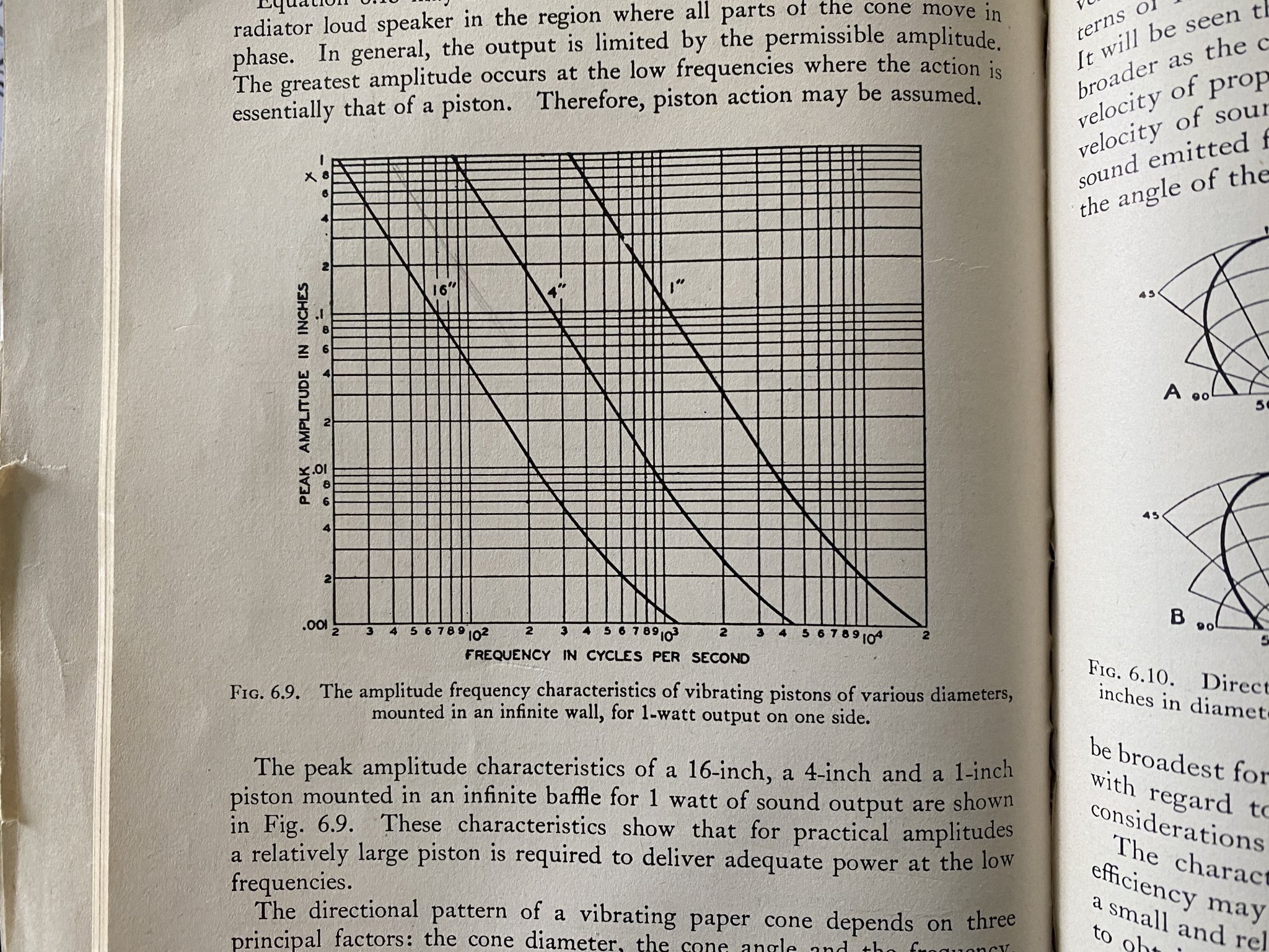

I found a much more explicit polar plot of a 16" woofer by Olson. You'll notice that a 16" dia. cone driver has some narrowing appearing at 1k, but it's still quite nice and is very similar to the directivity of horns in this region, except for the darn midrange pinch. This is one of the benefits of the 16", that it's directivity should be similar in the Xover region as the horn, at least for most horns in consideration here.
Also see enclosed a chart of the peak amplitude or excursion plot of various diameter cones at 1 watt. This really shows why a 16" woofer is what we use in this two way design. To cover something like 30 to 1k, the limiting criteria is cone excursion and only a large woofer can cover this range without excessive cone excursion distortion. If you search back through this thread for Gary Dahl's explanation of his design, you'll see he further limited excursion by using a somewhat small sealed box for the woofer. This increases low end response and really controls excursion. He adds another woofer I think or sub for the lowest frequencies.
