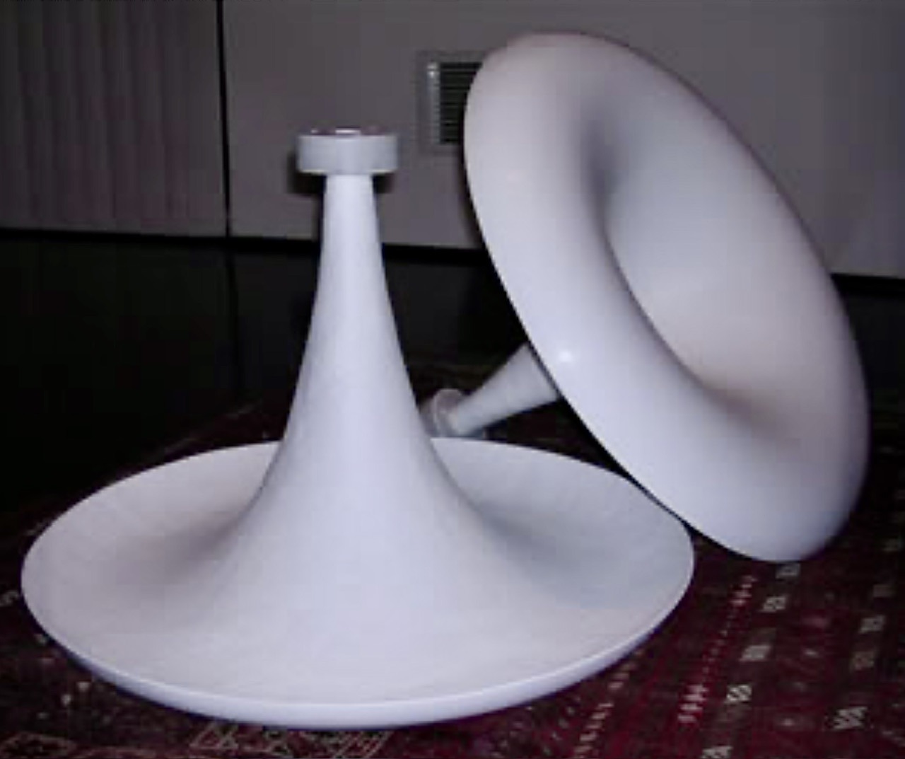

There have been some advances regarding horn design recently: http://www.at-horns.eu/exar-story.html
Controlled directivity, smooth polars, very low diffraction, good low-frequency extension. We can have all of this with the modern devices.

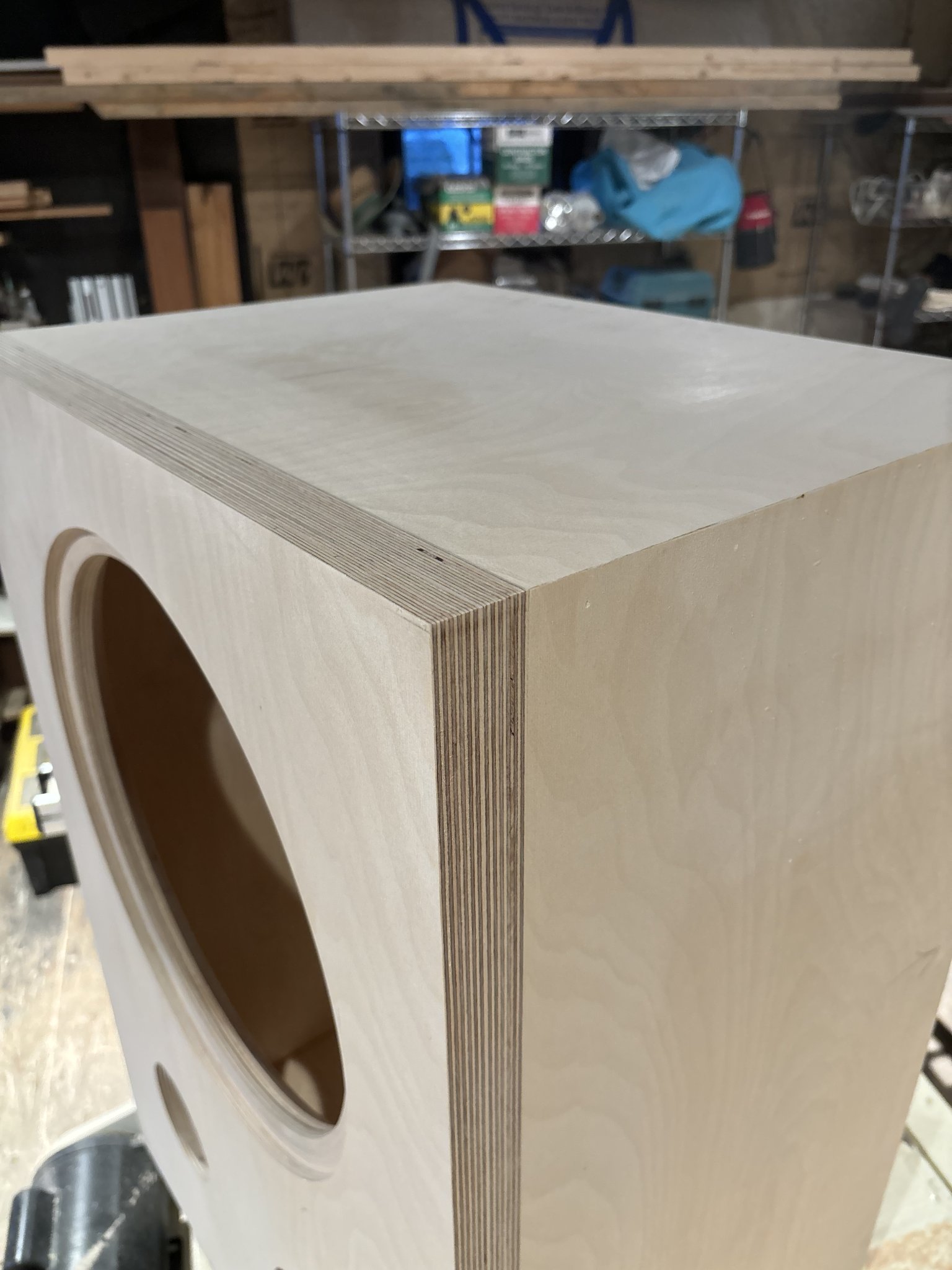

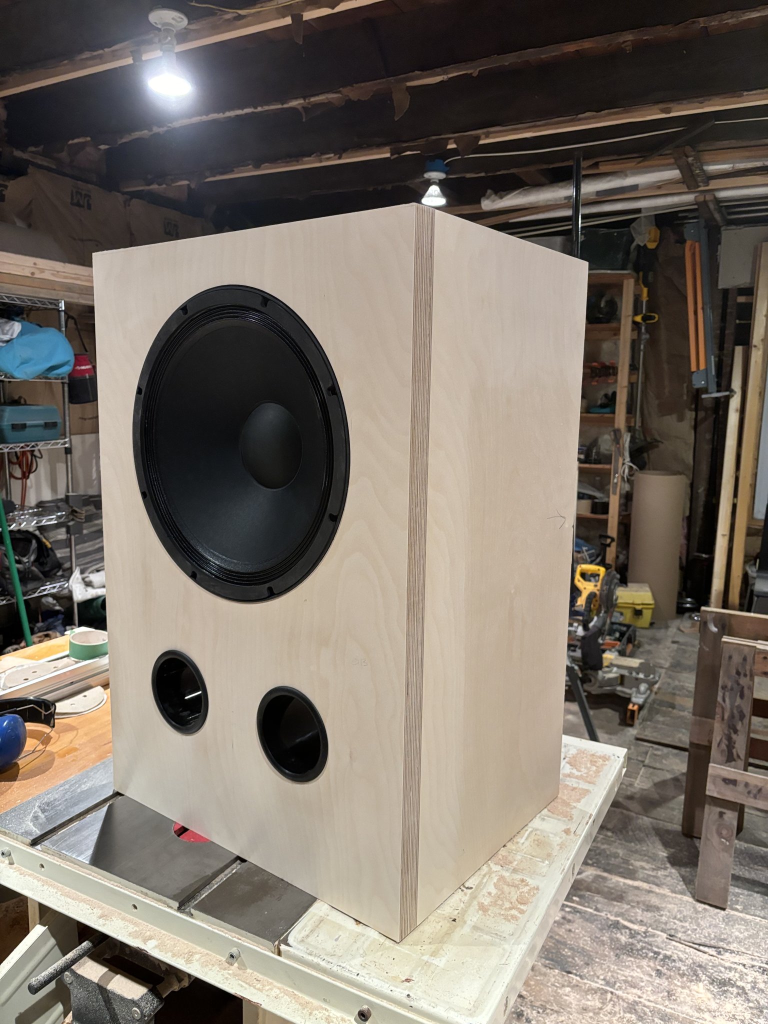

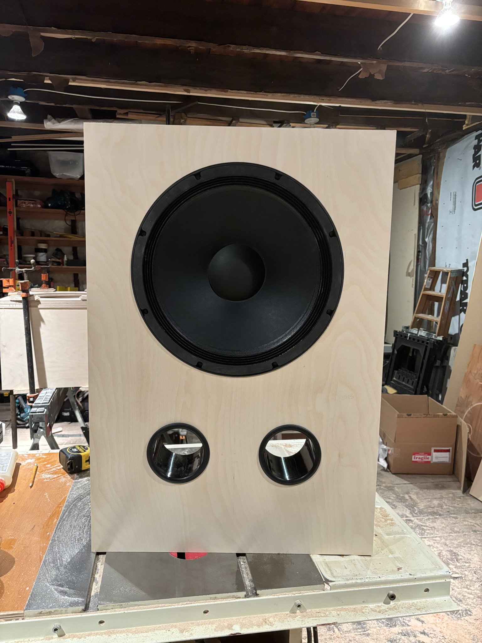

Is that pre-finished plywood? Looks amazing, simple,clean.OK so I have a question regarding baffle edge diffraction and large radii at the edges. I was able to knock out the cabs for my 15PR400/Rosso65CDN-T/AH425 build, and had planned to put a 38mm radius on the left and right edges, but the way they look with the 36mm of Baltic birch edge showing, I'm smitten and don't want to grind into it. I know Lynn has made a good point for large radii but I'm not ever going to do 3-4" as he did, and from what understand, lower midrange and bass frequencies really aren't that affected enough to even measure let alone hear. This probably explains why so many big drivers are surface mounted as well. What I'd like to do is spray everything satin black but leave the edge grain with a clear finish, make it a feature. Any good science on this from anyone? Thank you, here's a couple of shots:

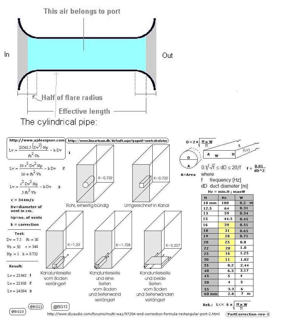

Yeah, consider the driver's pipe end correction on a baffle k = 0.732r 😉Any good science on this from anyone?
15PR400's Sd = 857 cm^2
radius = ((857*4)/pi) = ~16.52 cm
k = ~16.52 cm*0.732 = ~12.1 cm
driver eff. dia. = (2*16.52)+12.1 = ~45.12 cm/17.77 "
baffle eff. dia. = pipe end correction on a baffle k = 0.732r = ~9.52" + 26" = ~35.52"
baffle frequency = ~13543/2/35.52 = 190.7 Hz, down in the 'boom/punch', 'warmth' BW, so IME a good place to 'hide'/'blend' in a bit of driver/baffle (euphonic?) 'ripple'. 😉
Just Baltic birch, the exposed edges were trimmed down with a giant bottom bearing trim bit, like you'd use for veneer or laminates, except scary big. Just a quick clean up sand to 120, there will be a lot more fussy sanding then spray with black lacquer, but the edge grain will stay visible with clear finish. Now I"m going to go spend a few hours figuring out what GM just said and learn something 😳Is that pre-finished plywood? Looks amazing, simple,clean.
OK GM I'm stumped again. This calls for a list, apologies for my density. I added numbers to your lines above, and will use them to call out my questions:Yeah, consider the driver's pipe end correction on a baffle k = 0.732r 😉
1. radius = ((857*4)/pi) = ~16.52 cm
2. k = ~16.52 cm*0.732 = ~12.1 cm
3. driver eff. dia. = (2*16.52)+12.1 = ~45.12 cm/17.77 "
4. baffle eff. dia. = pipe end correction on a baffle k = 0.732r = ~9.52" + 26" = ~35.52"
5. baffle frequency = ~13543/2/35.52 = 190.7 Hz, down in the 'boom/punch', 'warmth' BW, so IME a good place to 'hide'/'blend' in a bit of driver/baffle (euphonic?) 'ripple'. 😉
3. So you add the corrected baffle radius to the true baffle diameter?
4. where is the 9.52" coming from?
5. Fine with the math, but I don't catch your Georgia humor, how it relates to whether to add a radius to the baffle edges or not? And my baffle is only 22" wide, so using your formula I get 214.8Hz, still not too bad, I'm hoping the ports will prop up the FR enough to avoid BSC and loss of sensitivity, but there might be a sag in the midbass range, I'll know soon enough when I start measuring 🧐
Hmm, humor? What humor? Methinks I'm using too many winks and/or maybe misunderstood as too cavalierly when not my intent at all. 🙁
No, I take what you write seriously, I just don't know what conclusion to draw about what you mean when you say "so IME a good place to 'hide'/'blend' in a bit of driver/baffle (euphonic?) 'ripple'. 😉"
My conclusion is that any audible discontinuities a baffle's sharp corners/whatever might generate will at worst be lost in the speaker's musical output primarily due to its low amplitude and perceived in a part of the human hearing BW where we would have a hard time noticing it unless considerably louder than the surrounding music/noise.
