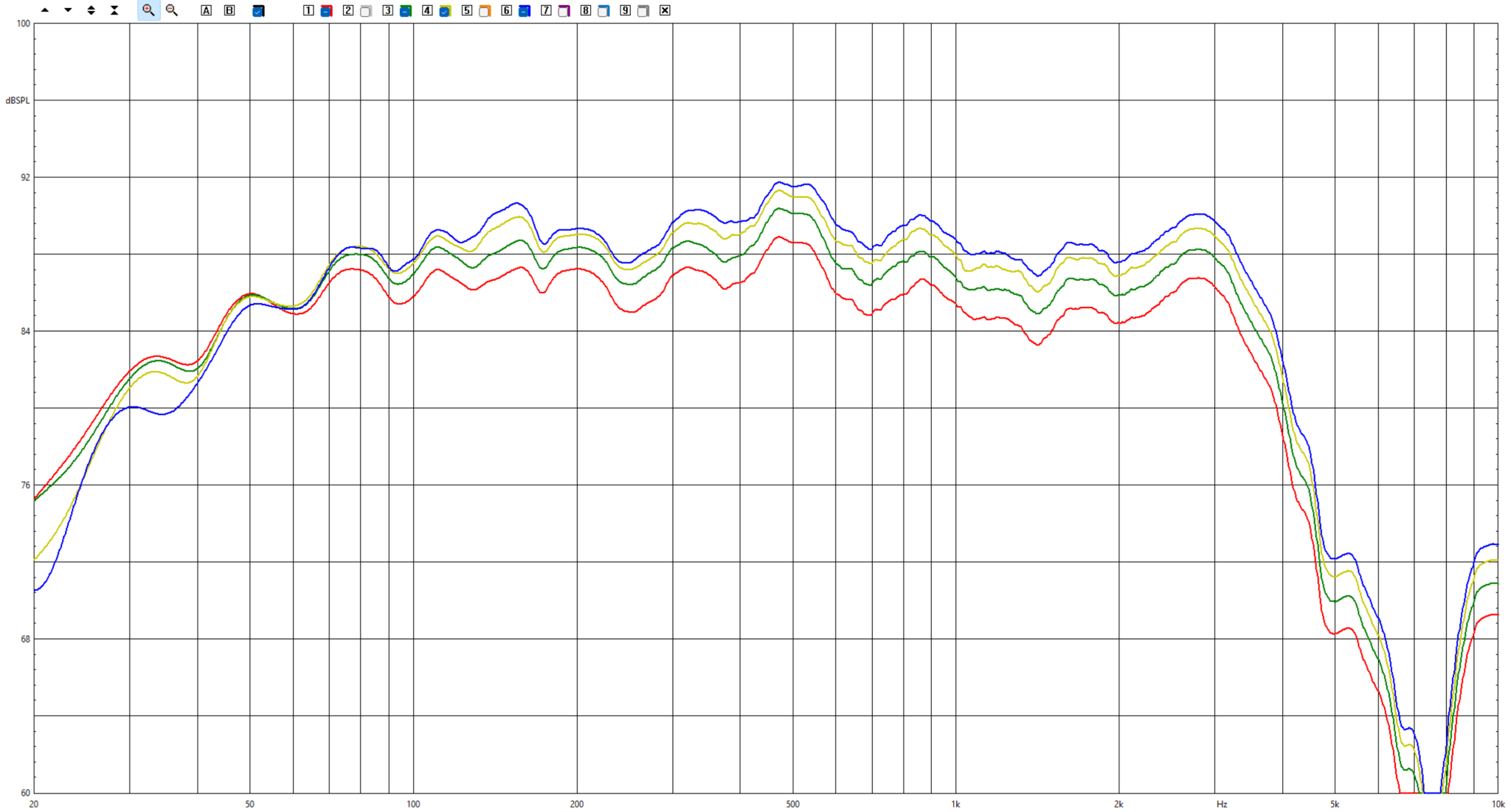

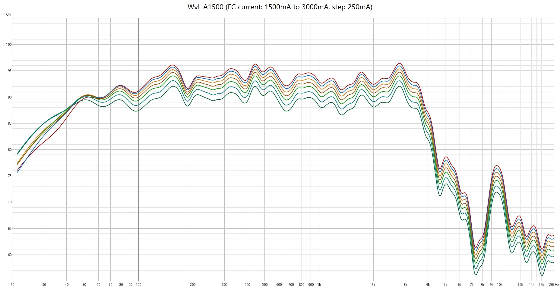

The advantage of FC drivers is that you have many drivers only by adjusting the current but it burns away a lot of heat.
I have found some older measurements of the A1500 simply varying the FC current 2.0A, 2.5A, 3.0A, 3.4A (no damping in a large open baffle wave guide).
With less current = less efficiency there is a more even fr. If you use a stronger motor then you gain level in the midrange but loose level in the lower registers.
some more data:
With 1500mA you get a low efficient open baffle woofer and with 3000mA a higher efficient woofer for a closed box or bass reflex.
