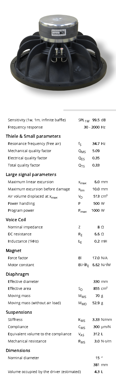

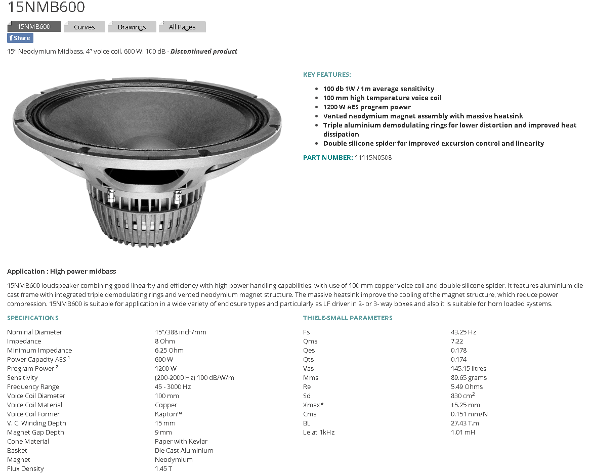

I've never seen much IMD info on woofers but I wonder how much difference there is between a 15" from each pro manufacture with a similar specs;
Qts/Qes <0.3
Mms <89g
