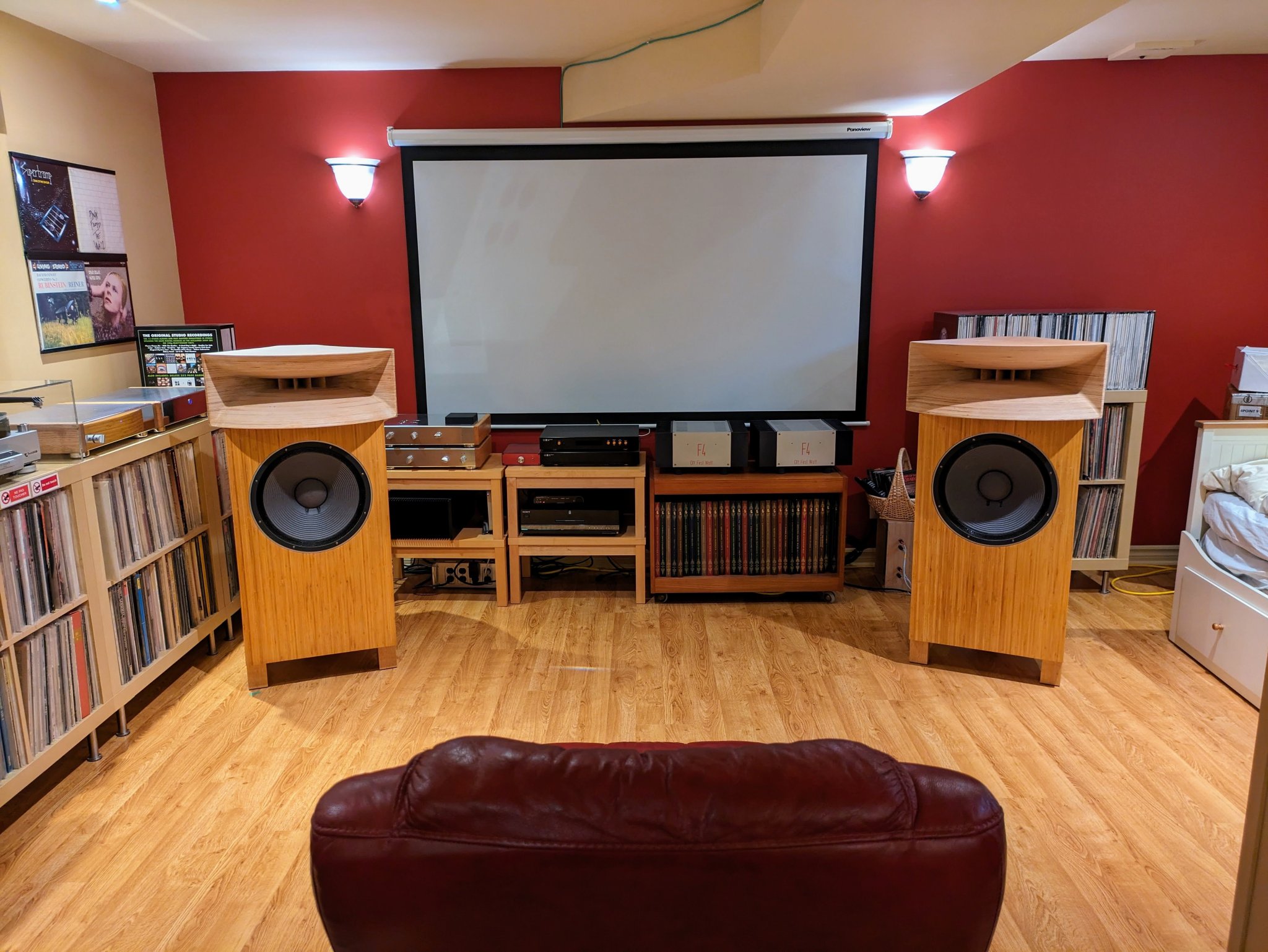

First, many thanks again to Lynn and friends who, a decade ago, got me started on this large two way, passive filtered, clean transient DIY speaker design journey.
The drivers I purchased then are the 15 inch TAD TD1601B midwoofer and Radian 745NEO Be 1.4 inch tweeter. I designed a high order low pass filter with a few dBs of baffle step compensation to drive the midwoofer in a sealed bass enclosure. My brother cloned my speakers and has been using his in a room larger than mine. Last year, although satisfied by Martin's JMLC AH425 horn, I could not help myself and acquired gently used Athos clones of the TAD TH4001 for hearing myself how a good sectoral sounds. The TH4001 is a slightly smaller version of the Yuchi A290. I found that I had to tailor the high pass filter to match each horn (for level and EQ) although the driver is the same.
As a side note, in a separate thread I explained the struggle finding a proper adapter for my driver and TH4001 horn. I ended up writing a CAD software to generate the desired throat expansion and got my own adapters 3D-printed. I am satisfied with the result and find that it levels the playing field between the two horn designs. Custom adapters are available made-to-order if anyone is interested.
Listening impressions.
The JMLC and sectoral horns sound superb and I have happily lived with both. The interaction with the room is where differences arise, but I honestly believe that either horn design is well-suited for a high end two way speaker.
JMLC (AH425): One hears very little room reflections when listening inside the sweet spot "cone". It feels a little like wearing headphones, but with all the benefits of a whole body experience (feeling bass, etc). In a typical sized room the sweet spot is wide enough for one or two listeners, but beyond that the tonality starts degrading. One should be aware of this if intending to position listener off axis (e.g. near side or front walls) . The ceiling reflection can add some "height" to the stereo image, which can sound pleasant on some recordings (pipe organ) but otherwise smears details. The JMLC horn sounds even better in my brother's large room than in my own which is of typical size but has a low (7 foot) ceiling. Still, while I use the TH4001 I miss the JMLC experience.
Sectoral (TH4001, A290) : These horns with vanes provide horizontal dispersion wider than is typically needed in a home setting. In practice side wall reflections are alleviated by toeing-in the speakers and haven't bothered me. The sweet spot is very large (width and depth) and the speakers can be listened to closer and further off axis than the JMLC, without noticeable tone degradation. By virtue of its low profile, the sectoral horn allows positioning the two drivers closer together. At short to moderate listening distances one can hear this as tightening the image. A benefit in my room is that the narrow vertical dispersion attenuates ceiling reflection.
If I were to start today, I would be considering the drivers that Lynn mentioned, because we now have extensive measurements confirming their quality (thanks to Troy), as well as their lower cost. A decade ago, jumping in required a leap of faith. Kudos to Gary, Martin and others who led down the path!
In the near future my brother will bring his AH425 and drivers for back-and-forth comparison with the TH4001. I will report any new impressions. In the mean time, I just wanted to share that the JMLC and these sectoral horns don’t sound coloured, and are fun to own and compare, just like fine wine.

I have heard the TH4001 and AH425 at considerable length. Both are superb, and large format compression drivers have a quality of ease and effortlessness you don't get with other drivers. Just stay away from mainstream PA stuff, which is designed for SPLs and durability, but not much else.
It was hearing the Altec A5's in San Francisco, and the Blue Thunders in Zurich, that made me "get religion" about large format horns. So relaxed compared to their little brothers, what a difference.
As transparent as electrostats, but without that slightly nervous quality that makes you tense up when the guitarist really cuts loose, or the singer reaches for that note. (That was the material at the PAF show that made the Class D amps stumble once or twice.)
No matter what you throw at the TH4001's or AH425's, there's always miles of headroom. Once you hear it, even for few minutes, you can't go back.

Allow me to help Lynn, if he and you do not mind. Lynn can always correct me.
The TAD horn is proprietary but has been measured and copied by Athos and others. The Yuichi horn profile is public. The TAD is slightly smaller and has a 40 x 50 mm entrance versus the Yuichi's 50 x 50 mm. They both have vanes and their surface area expansion profiles are very close. These horns are so similar that I doubt I could hear a difference between them. Measure one yes, hear one...
Splitting hairs... The Yuichi might have a small edge by virtue of its larger size and I would lean towards it if using a 2 inch driver. Go big!
On the other hand, if using a 1.4 inch driver the length of the adapter would make me lean towards the TAD: an adapter for the Yuichi would possibly warrant some kind of support under the driver depending on the driver weight. Still, it is doable. The optimal adapter length for a 1.4 inch driver is 3 inch for the TH4001, and longer for A290 because of the larger surface area difference.
As for depth perception, I have not noticed an issue since using the TH4001. I will be happy to check when doing back-and-forth comparisons with the A425 and report back if I notice anything funny.
