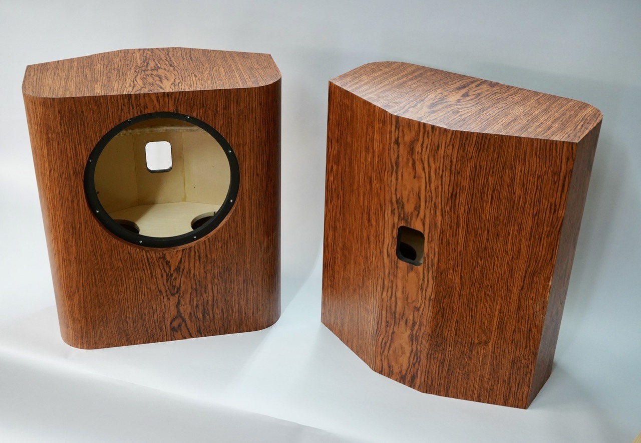

Thom Mackris (Galibier Designs) and I are following in Gary Dahl's footsteps, with a 4.2 cubic foot closed box for the Altec/GPA 416 bass driver. The HF driver will be an Athos Audio Yuichi A290, with an adapter for 1.4" exit compression drivers.
The bass cabinet is 26" wide, has 4" radii on the left and right sides, and two internal shelves, partly visible in this photo. I have a pair of AH425 Azurahorns, as well as a pair of Athos Audio Yuichi A290 horns. The candidates for the 1.4" format compression driver include the RCF ND850 1.4, RCF ND950 1.4, Eighteensound ND3N, and the Faital Pro HF1460 carbon-fiber driver.
Crossover will be in the 700 to 800 Hz range, and the starting point will be a simple Altec N-800F/Heathkit AS-101 second-order crossover.

Hello Lynn,
Does the 4” radii on the baffle sides mitigate diffraction issues better than, let’s say, a smaller chamfer on all edges of the baffle? Thank you..

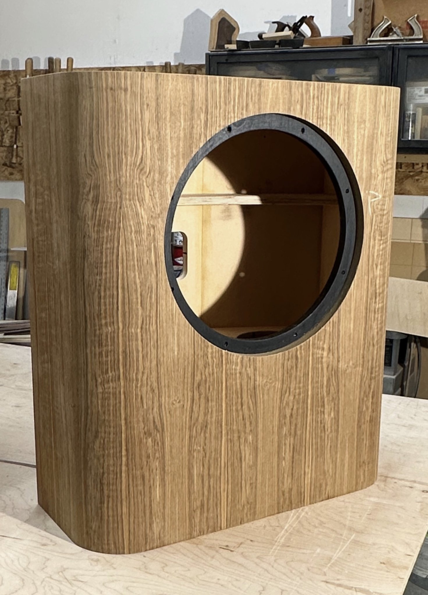

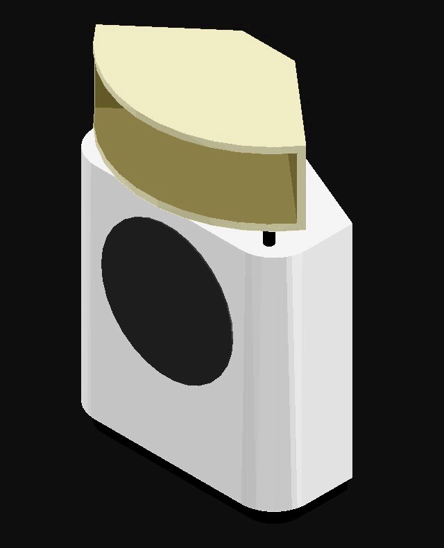

These are my bass cabinets for the Altec/GPA 416 bass drivers. They look smaller than they really are: they're actually 26" wide, so they match the width of the Yuichi A290's almost exactly, and are 30" high. There are two internal braces, with one just visible just below the woofer cutout. The other is a crescent-shaped brace just above the woofer magnet.
With the Yuichi A290 horn 11" high, a 2" spacer between the horn and the bass cabinet, and the bass cabinet on a 2" riser, that puts the centerline of the horn 39.5" above the floor, right at listening height. Overall height is 45".
They are 4.2 cubic feet/200 liters in volume, and are closed-box alignments intended for triode amplifiers with moderate damping factors. It's basically a modern version of the Altec Model 19, optimized for triode amplifiers.
