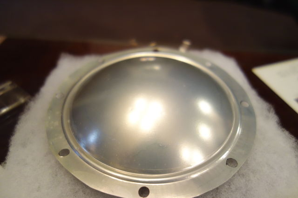

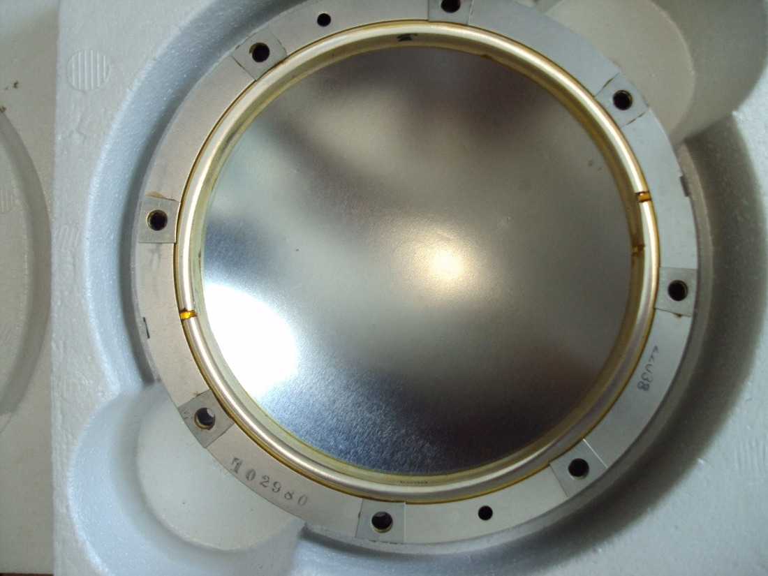

This is a NOS diaphragm for the JBL 375:
You can spot the surface structure. The 'alloy' is probably very similar, if not identical, to what Jim Lansing used to 'form' (with his finger!) the diaphragms of the 284E for the Shearer Horn.
This is a Japanese Duraluminium remake, similar to the diaphragms of the 594A: lighter, stronger, BETTER:
But this diaphragm won't reach 24 kHz, certainly not without major 'issues'. So something more refined is needed.
