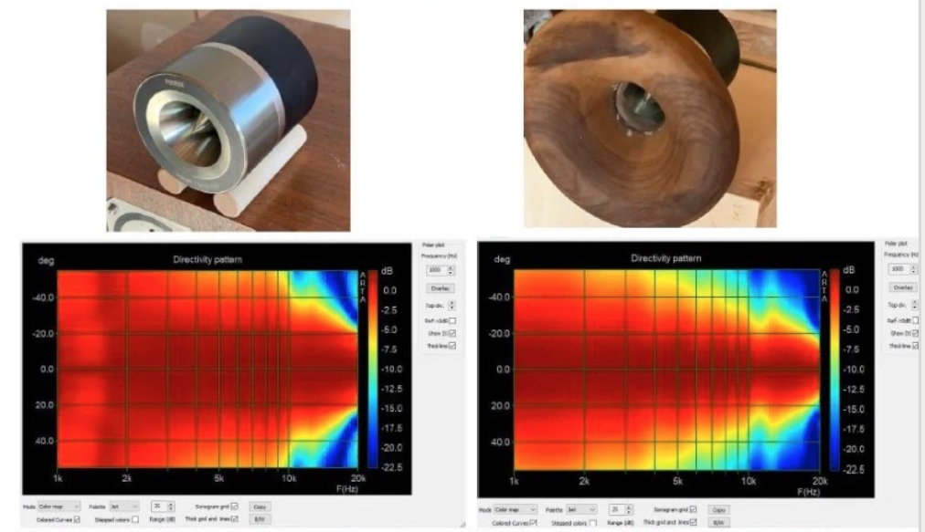

Or in Nico's improved version of same?? https://audiohorn.net/next-gen-bi-radial-horn/
Or this https://audiohorn.net/x-shape-horn/
Or Troy's ES290 horn.
Or go with a 2" midrange like the Commmunity 200 , BMS 4592 or B&C DCM50 and an AMT or Fostex 925A horn tweeter in one of Troy's waveguides. Most here and elsewhere insist on two-ways to better ensure coherant soumd, saying that mulitple drivers are rarely their equal. Troy seems to have good success at selling three-way systems, though it's sad that there seems to be very few sensible alternatives besides the JBL 2450J for two-way systems.

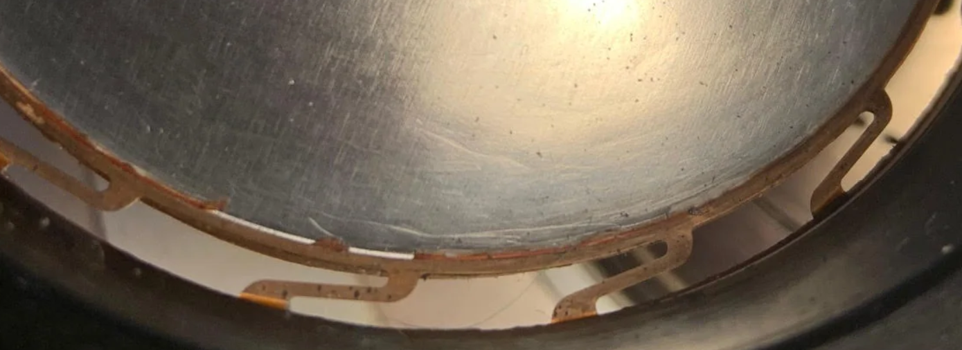

Here is the JA6681B's suspension up close.
It is not very hard to imagine how it will happen on a 30 year old driver.
But would not overloads be the only cause of that? And how likely would that happen in a passive crossover designed to prevent this?
Ideally yes, but this is very thin, flat stock BeCu, (my general experience with that material is in flat stock like this).
Not circular rolled springs etc.
My experience with the material is that at some point it will have a fatigue crack eventually, where the material is bent, and the bending force have been applied continuously, when talking about flat stock.
Like the battery holders i mentioned, the bend on them is where it breaks from fatigue 99,9% of the time, although it tends to be old and well used long before that happens.
Just like any spring that's under tension for long enough, there will be some effect on the materials property over a long time, and the resoring force will be diminished. And these drivers are not exactly factory new made in the 2020's. Remember this is a 'spring' alloy often used for electrical/electronics purposes to begin with.
Ideally and looking from the spectral decay, Yamaha have used a tempering/heat treat that gives the suspension the desired flexibility to kill off and avoid secondary resonance in the useable bandwidth. That will not always give you the most mechanical sound result as it has been optimized for a specific purpose.

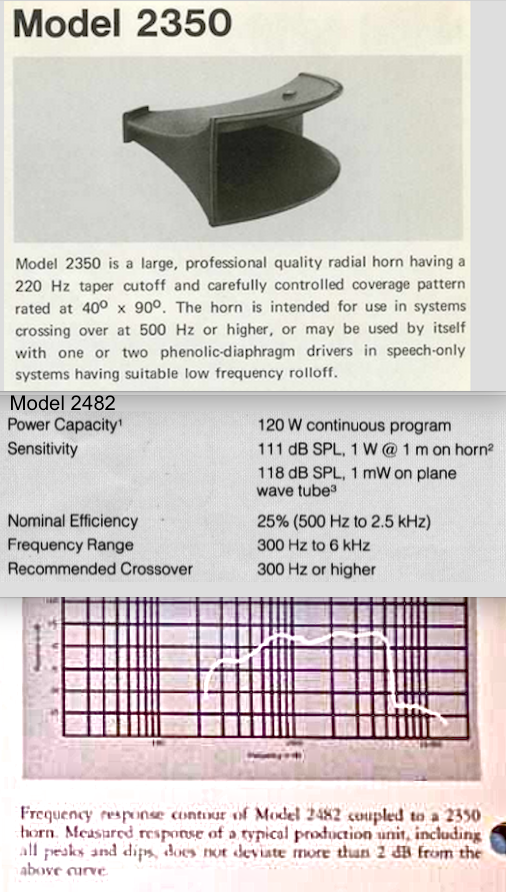

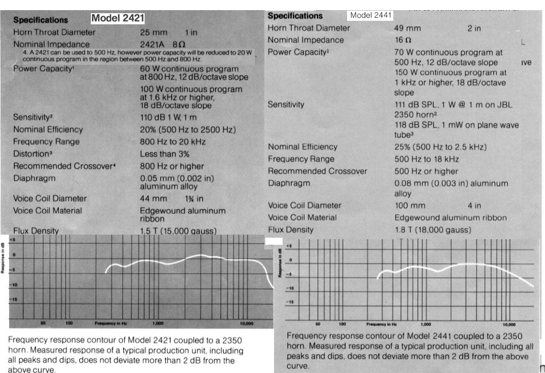

JBL specifications from the 1980s show how various drivers perform on their large 90x40 degree 2350 radial horn, usable to 300Hz.
The driver’s “continuous program” rating is double (+3) their RMS rating.
JBL 2482 49mm/2” exit, 100mm/4” phenolic/linen diaphragm mid-range driver
120 watts at 300Hz or higher (no slope specified).
JBL 2421 25mm/1” exit, 44mm/1.75” aluminum diaphragm
20 watts at 500Hz 12dB/octave slope (over 120 dB at 1/m)
60 watts at 800Hz 12dB/octave slope
100 watts at 1.6kHz or higher, 18dB/octave slope
JBL 2441 49mm/2” exit, 100mm/4” aluminum diaphragm
70 watts at 500Hz 12dB/octave slope (around +6dB more than the
150 watts at 1000Hz or higher, 18dB/octave slope
JBL 2421:2441.png
The little JBL 2421 is slightly more sensitive at 300Hz (due to the extra throat length from the 1" to 2" adapter) and far more sensitive above 5kHz than the 4" 2441 (which is a bit smoother than the 2450).
The 2421 would peak around 120dB at 500Hz without exceeding it's 10 watt RMS rating.
That's similar to the level of a player blowing their lungs out on a tenor sax, it's bell one meter from your ear.
Your Radian/AH425 combination has far output than that.

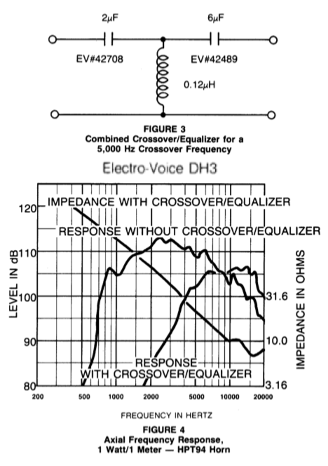

I doubt that would be much of a concern given my room size.
If you do want the SPL of standing on stage in front of a rock horn section from the compression driver, dividing the upper range in two might be advisable.

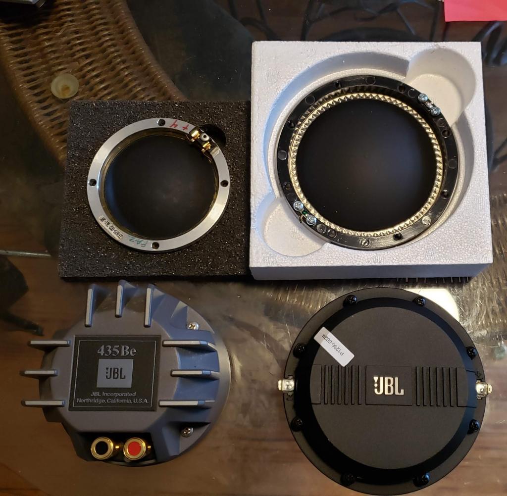

The 3" diaphragm 745Be has better high frequency detail, smoother frequency response and dispersion than the 4" diaphragm 950Be. The larger diaphragm can go louder.

Yes, I’m quite aware of the HF penalty by choosing the 950Be over the 745Be, which was why I asked for opinions on adding Troy’s Fostex 925A/waveguide.
Both the BE drivers have enough HF response to be passively equalized flat to 20kHz.
Either are capable of more HF output than the 925A.
Troy's 925A/ES-4000 takes a "twin peak" beaming bullet tweeter and turns it into a more beamy tweeter with a pretty wood surround:
