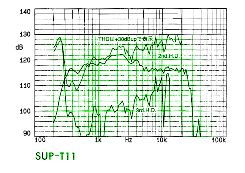

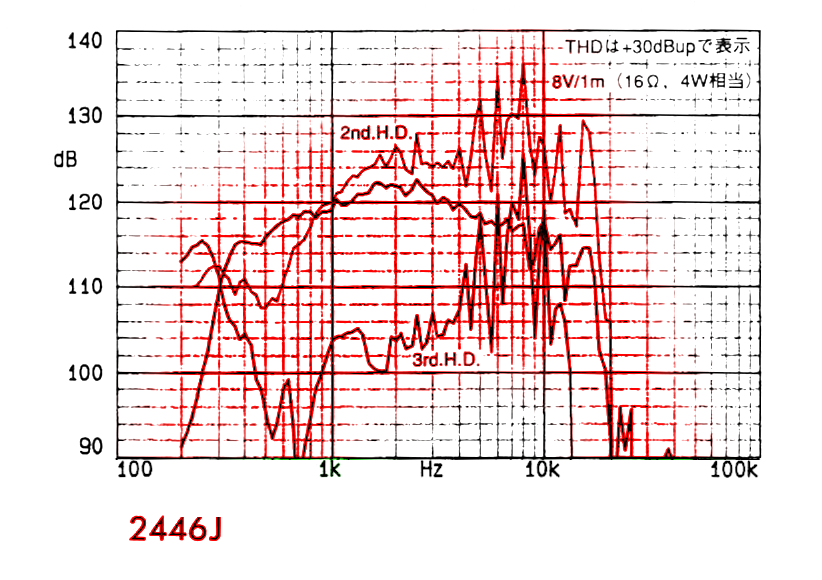

marco_gea already posted the plots from a Japanese comparison test in the past, in which the Sony SUP-T11 proved superior to the TAD TD-4001 and the JBL 2446J.

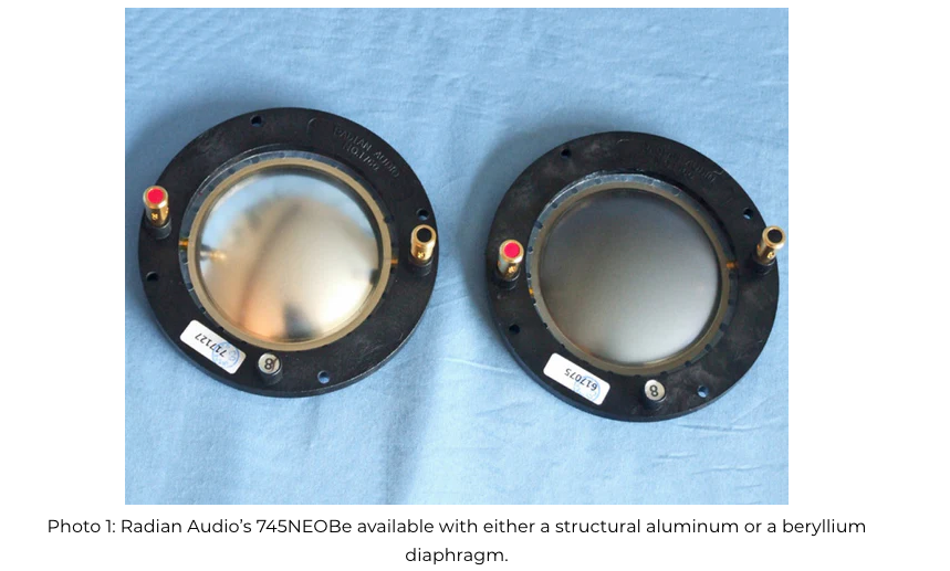

Duralumin is just a old fashioned/fancy word for what is today commonly known as: 2024 Aluminium alloy.This is a Japanese Duraluminium remake, similar to the diaphragms of the 594A: lighter, stronger, BETTER:
Might have been used another variant of the 20xx family of alu alloys for some mfgs.
It is lighter only because it's thickness is less, likely stiffer due to different heat treat, but higher stiffness generally also means more prone to fatigue.
The main alloy material is Cu (4-5%) which heavier then Alu., so Duralumin is actually heavier then aluminium by a slight bit.
The other additives is Magnesium and Manganese 0,5-1%.
It's main benefit is that is is stronger and tougher mechanically, then a pure Alu.. diaphragm would be, it will also take longer to fatigue, and it take well to heat treatment for adjusting ductility and hardness.
But it is a hell to solder or weld.
If you dig around that is the same material JBL used in they're old "Aluminum" diaphragms, used in the 2420, 2440, 375 etc. Which they eventually coined Aluminum alloy (old JBL datasheets 2420 for ref.)
Also note the 375 used the D16R2440 diaphragm.
And likely Radians aluminum alloy diaphragms are of a similar alloy.
So both of those diaphragms are made from the same material in fact🙂
Different foundries will have different trace elements and slight % change in the alloy as usual.
The newer Japanese diaphragms are better finished/polished and maybe coated for longevity, as Duralumin is more prone to corrosion due to the added copper and MG then regular aluminium.
The suspension is made from BeCU = Beryllium copper, which contains ca. 97% copper, and 1-3% beryllium.Yamaha 6681B (aluminum diaphragm/beryllium "finger" suspension)

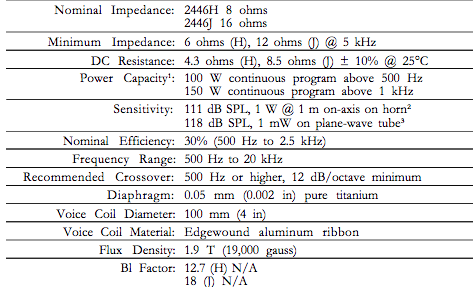

Corrected for Re (I used the specified minimum impedance for the RCF = 8.5 Ohm) the motor strength of the RCF is even higher than that of the GSU-D04R, a 12.5 Ohm driver.Would need to increase the RCF ND950's Bl from 17.6 to 20 and double the back chamber volume to get there.
It was a mistake for me to equate Bl of coils with different impedance and lengths.
According to the specifications, the RCF ND950's neodymium magnet strength is 2.0 Tesla, the same as the much heavier Alnico magnet GSU-D04R's 20,000 Gauss.
If we look at the JBL 2446, a driver that uses the near same magnet strength (1.9 Tesla/19,000 Gauss) available in an 8 ohm ("H") and 16 ohm ("J") version, we find motor strength is equal for both, even though the minimum impedance and Bl are not:
Corrected for Re:
Bl factor for the "H" squared, 12.7x12.7=161.29/6(minimum impedance)=26.88.
Bl factor for the "J" squared, 18x18=161.29/12 (minimum impedance)=27.00, only 0.12 difference in motor strength.
Corrected for Re:

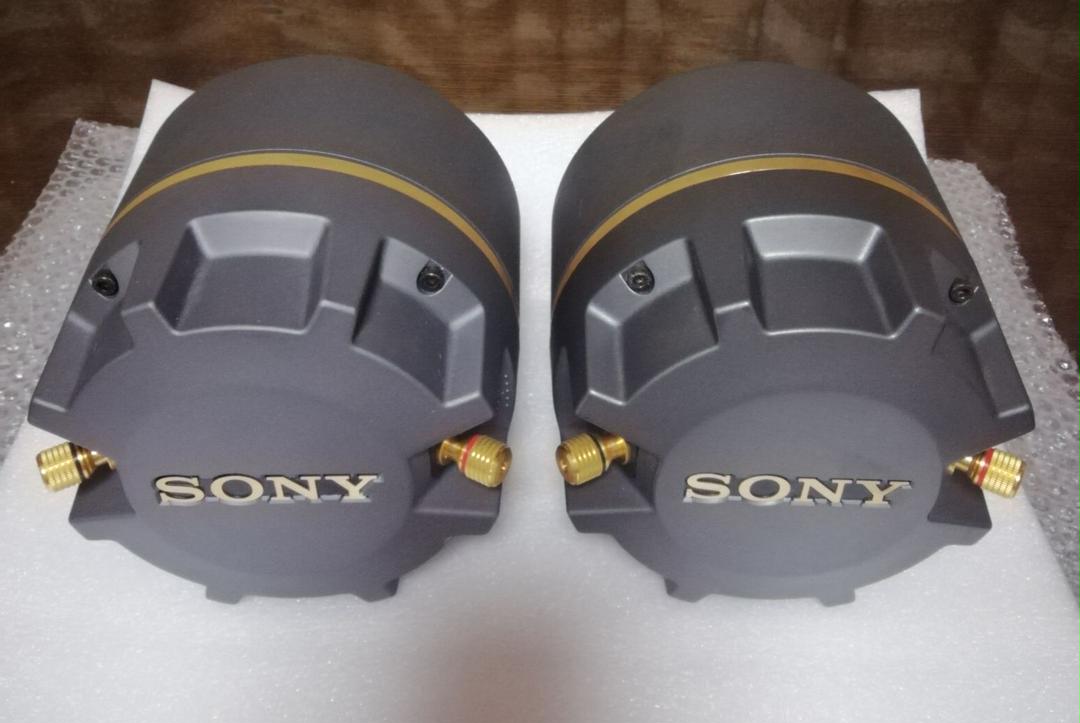

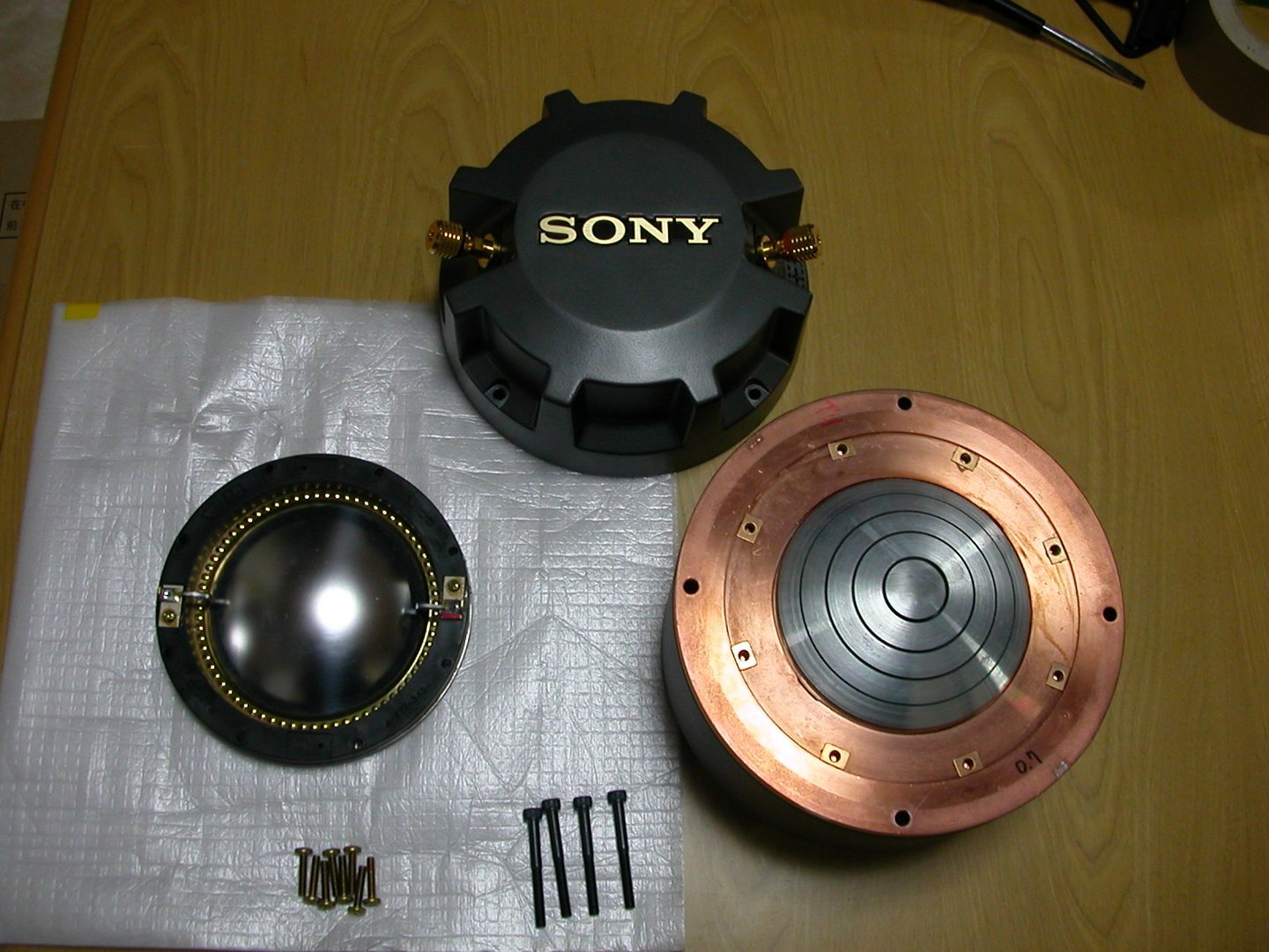

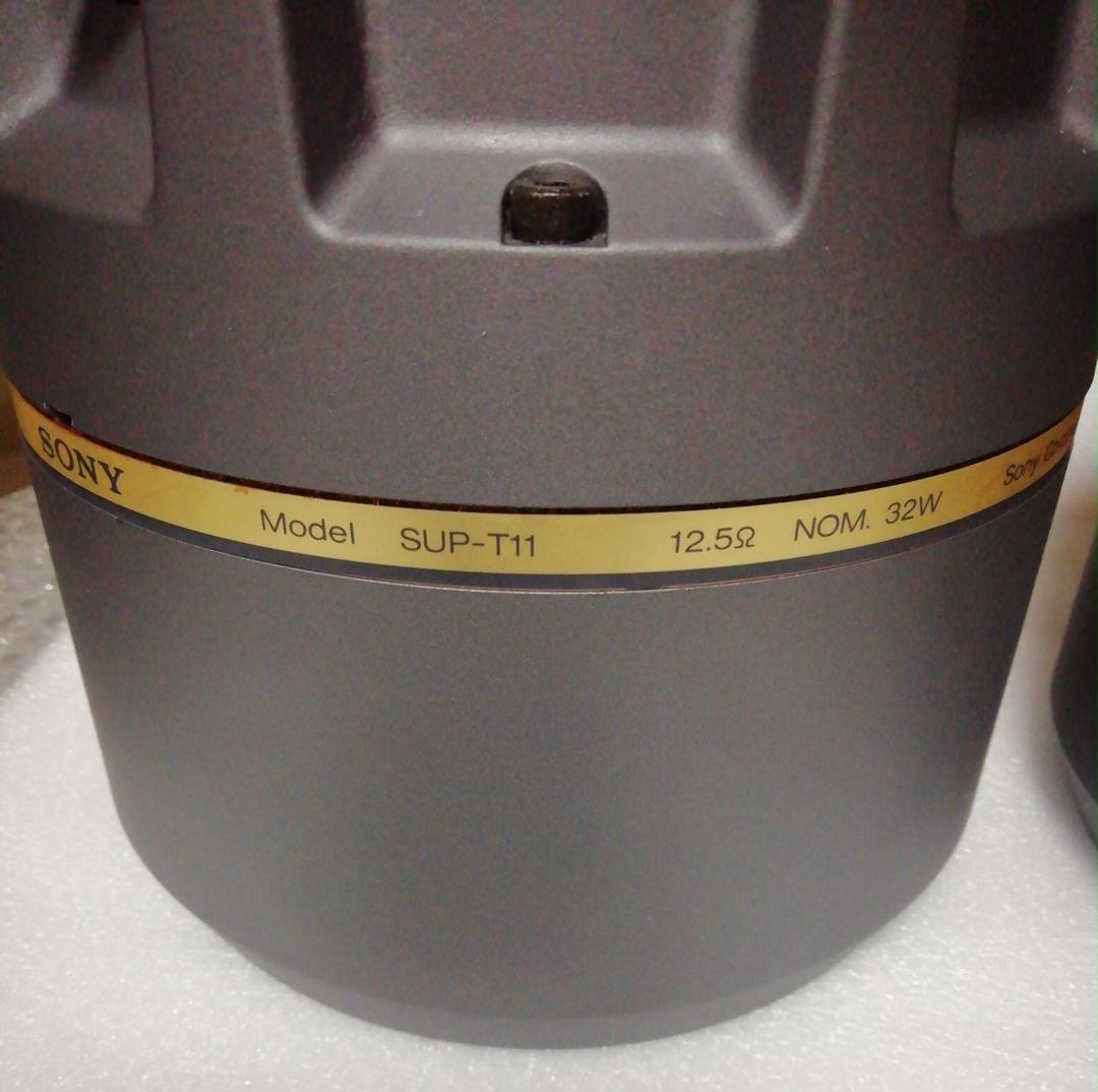

In the meantime I've found some additional details of the Sony SUP-T11.

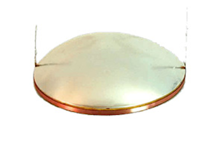

As expected, the diaphragm is the most important part, although the entire driver is carefully designed.
Many diaphragms are integrally formed with a suspension consisting of a metal sheet. In order to maintain a degree of durability and rigidity required by the suspension, the metal sheet is thicker and thus heavier than that of a diaphragm with separate suspension. This often leads to poor frequency and response characteristics.
The aluminum dome + titanium suspension of the SUP-T11 weighs only 2.3g.
The engineers found that the thickness of the dome and (integrated) coil (bobbin) must be 70% or less of a thickness equivalent in mechanical strength to the thickness of the suspension material in order to achieve the improved frequency characteristics.

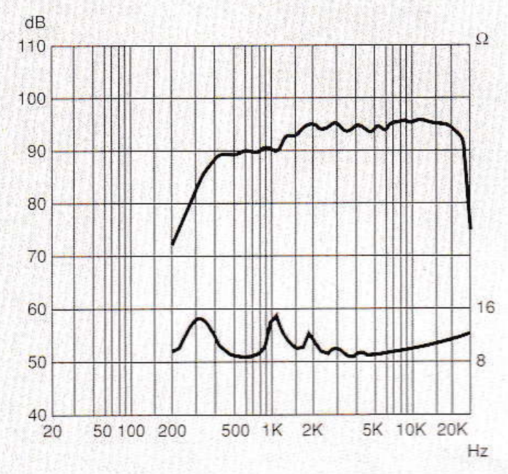

The response in the Sony brochure looks similar to the factory plot of the GSU-D04R, despite the smoothing:
The diaphragm without suspension looks like this:
