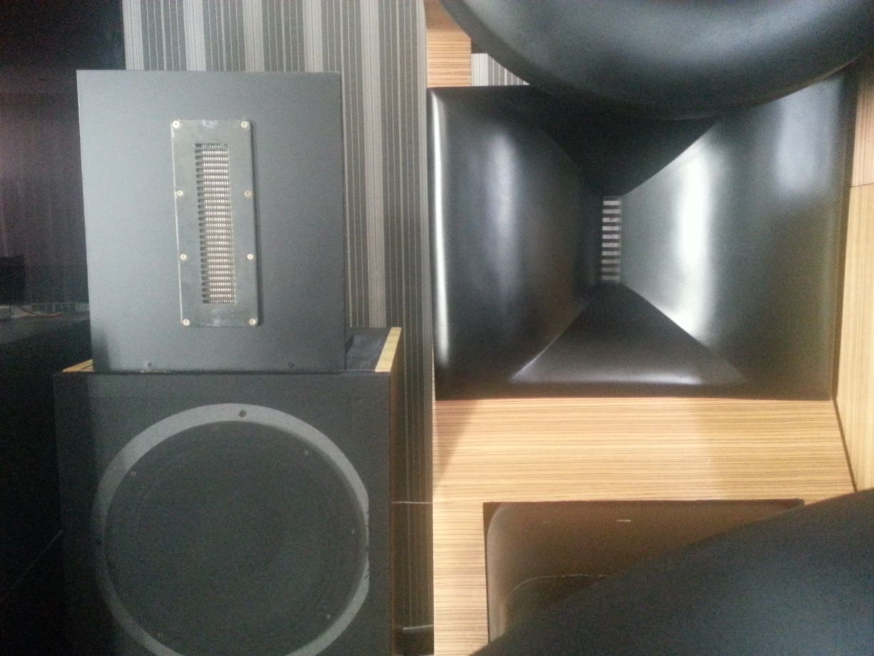

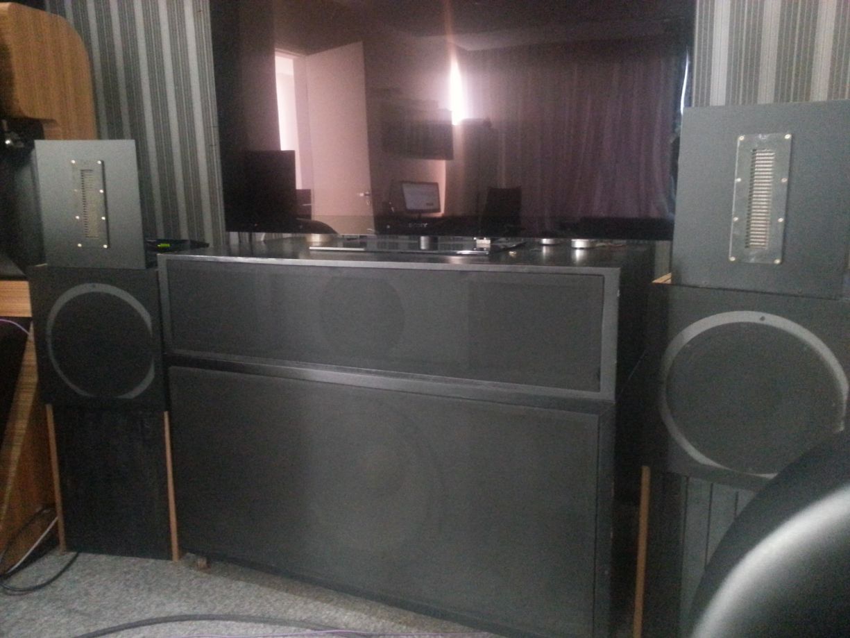

hi all
yesterday i sent Ray's prototype amt's back to him, as he will need them. Set back in place the Beyma TPL150, with Beyma TPL12p80nd, 1600hz crossover and listened some tracks . The difference is quit dramatic. I can immediately hear the coloration of cone speakers now. Something, i was not aware of, before listening to amt's. So amt's are really quit a improvement, and its naturalness is striking and awesome. And his prototypes are not even fully finished, and some issues he will have to improve, and work on. Once, a full range amt is ready, it will set a new benchmark of audio reproduction. 🙂
Angelo
Angelo

it would be great if you could come up with some pictures.

uh thanks for the snapshots
