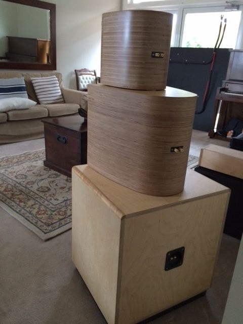

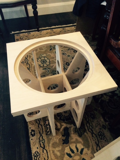

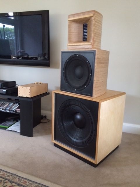

I built a three way using Beyma 12 p80, plus Beyma TPL150 with horn, plus 18 inch bass from Faital Pro. I took cues from the Mark Levinson / Daniel Hertz M1.
Quality Mundorf xover for the mid/tweeter (1700Hz). Amps were monobloc KT88's.
800 watt MiniDSP amps for the bass.
Over engineered cabinetry using euro birch ply. Tweeter had custom shaped horn to mirror the Beyma standard product.
Pretty happy with this "world beater."

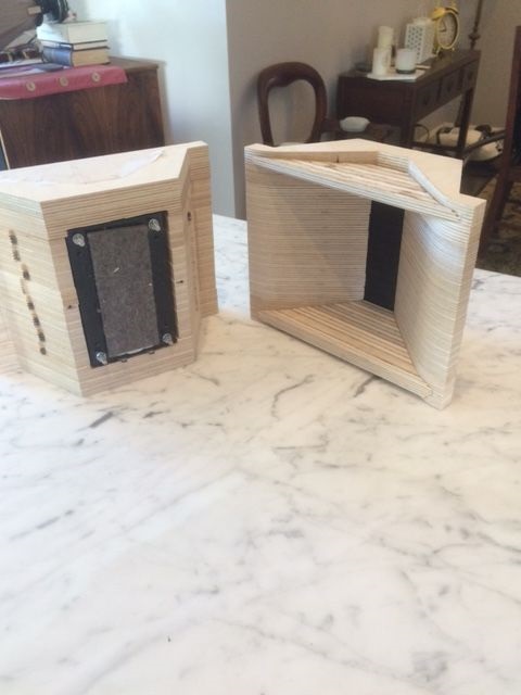

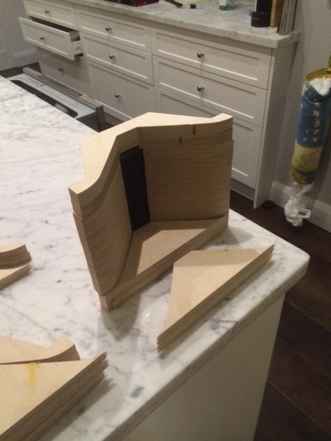

Hey atilsley!
I remember this build when you were on it. Sounds like you are liking the sound. That is great!
My recollection of your tweeter section is that is was wider than the original Beyma waveguide while maintaining shape and extending the straight section. And you took off the plastic back (as seen in the picture) and allowed it the breath into the whole back cavity which is pretty large. Maybe the larger waveguide allows the TPL to go lower than stock without the resonance reported by others.
Would you mind sharing details about the tweeter section, like waveguide width and height, approx volume behind the TPL, what kind of filling you are using in the back chamber? BTW, how loud do you listen to music?
Coincidentally, I also run KT88 for mids and treble and active midbass with class D amps (plus subs in my case).

Thanks.
The tweeter flare extended only by 10mm or so.
The larger flare was not intended to lower the frequency response, although that would be possible. However, it’s academic, as the mid bass easily covers the higher frequency.
The tweeter chamber was not damped. I didn’t see any benefit in that.
The volume of the tweeter housing is also academic...no material affect on sound, as it is sealed.

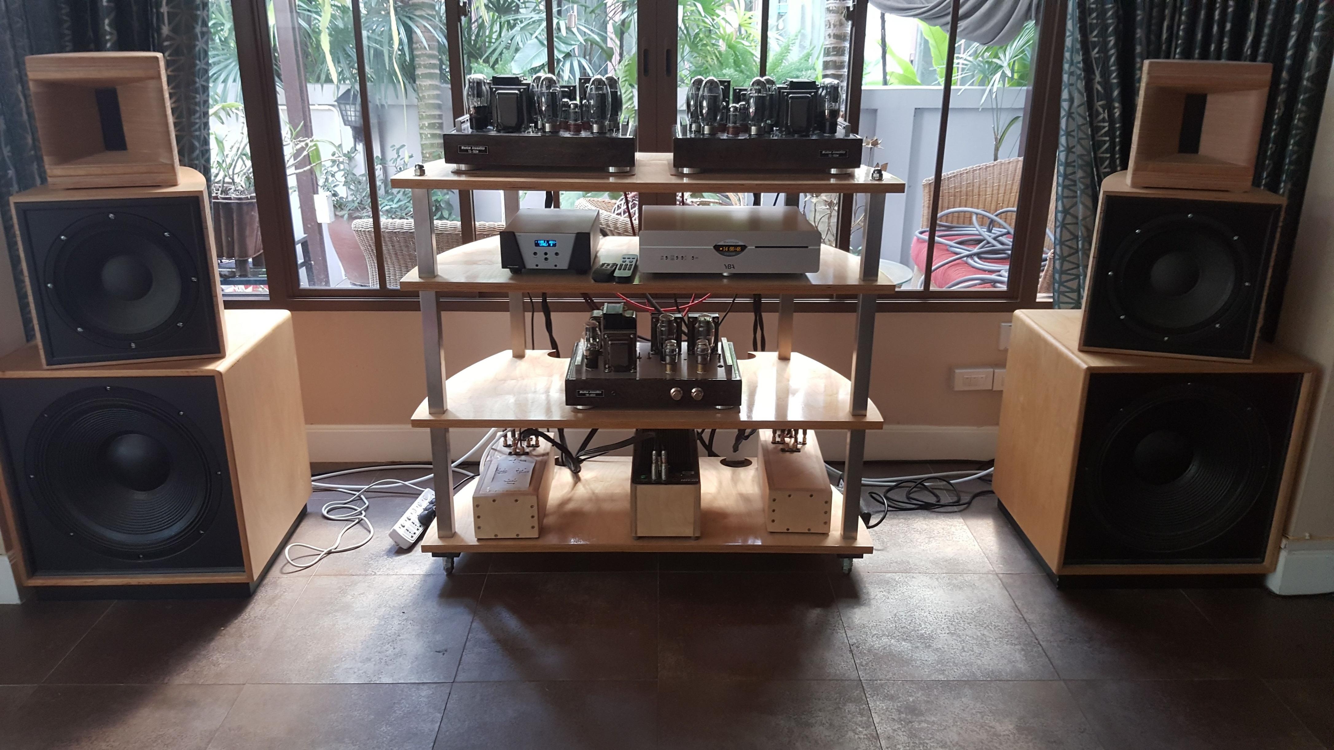

Nice build. Try with a dampening pad on the wall behind. And some linseed oil. 🙂
Edit: Glass windows is I bad idea, IMHO, if you are using it as open baffle. But it may not be your room, I now realize.
Thanks...I agree about the sound pad behind the system....but it's not my room!
The pic doesn't quite show it...but the cabinets have been finished in satin two-pack polyurethane...see different pic to give you an idea. Regards. Andrew.
