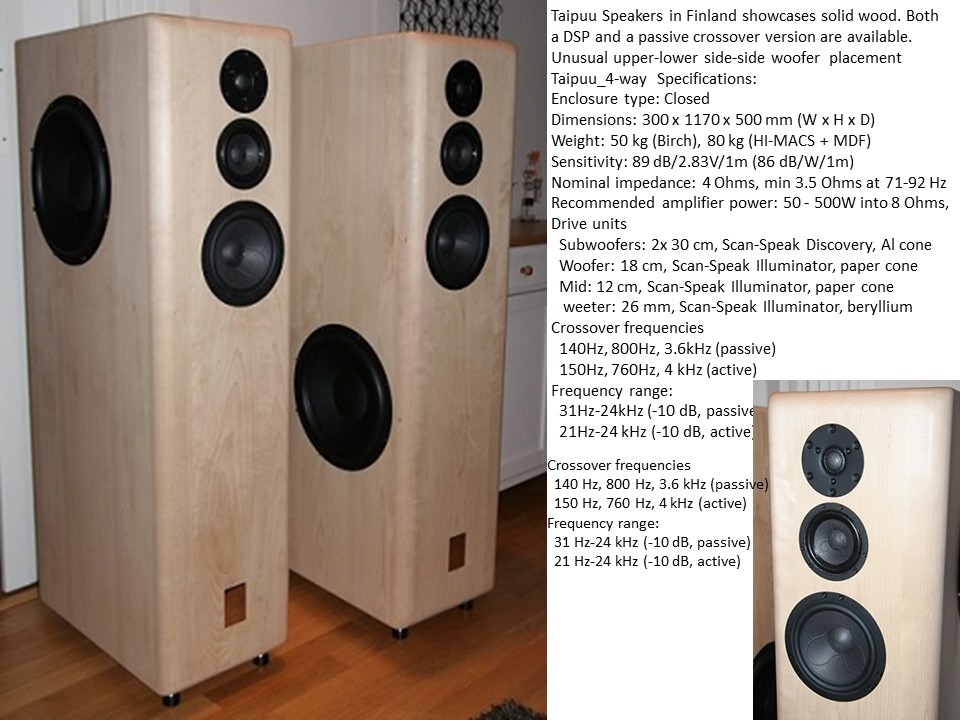

You might get some ideas from:
Taipuu Speakers DSP active speakers - Taipuu Speakers
Taipuu Speakers in Finland showcases solid wood cabinets. Taipuu Speakers are a unique combination of carefully finished carpentry and state-of-the art audio made in Finland. Taipuu has a 4-way design using Scan Speak Illuminator drivers with performance data on their website. The VituixCAD2 cadtool website also models this speaker. This is a proven (passive and DSP) design with extensive CAD modeling.
