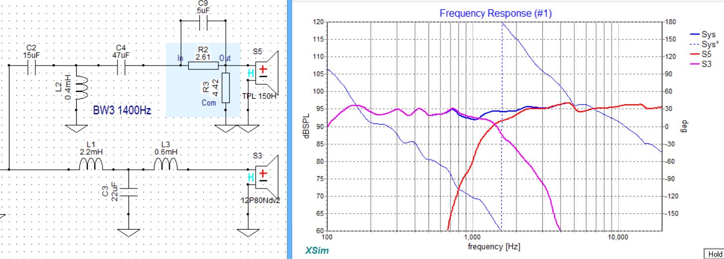

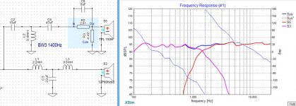

What crossover frequency and electrical slopes(circuits) are you using?
With the horn loaded TPL-150H crossovers between 1300Hz and 1600Hz are considered the "best compromise" range with the 12P80ND-V2.
At 1300Hz the 12P80ND-V2 polar pattern is close to the 80H polar on the TPL-150H horn, but some listeners believe that high frequency details are negatively affected. A steeper slope BW3 or LR4 crossover helps.
At 1600Hz crossovers, very few listeners complain about the TPL-150H sound quality, but as you noticed, the 12P80ND-V2 polar dispersion is below the 80-degrees of the TPL-150H horn. A steeper slope BW3 or LR4 crossover also helps.
BW3/BW3 at 1400Hz models well in simulation, only good ears can judge.

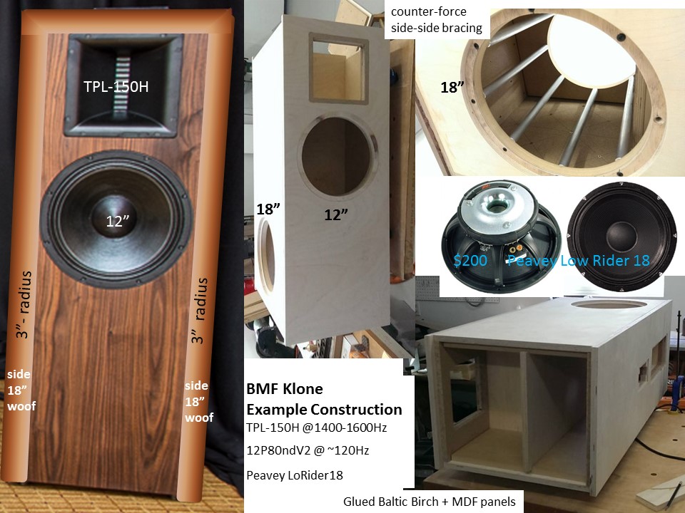

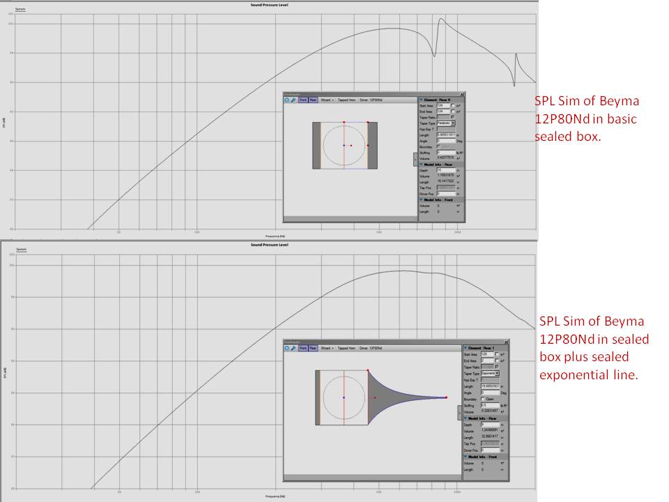

Consider using the 12p80nd with its Qtc=0.15 as a true midbass in a sealed well stuffed enclosure, and adding a large efficient woofer at 80-100Hz. This type of 3-way would optimize the midbass(sealed) while minimizing Dopler type IMD from mixing 1.2Khz with any bass cone movement. Mark Levinson uses the 12p80nd with the similar constructed Beyma 18p80nd in his Daniel Hertz M1 $100K speaker. Using your TPL 150H 80 x 30 horn HEIL would deliver good controlled directivity over the 1200Hz Xover range to the 12P80nd.
Large radius cabinet edges that minimize diffraction would allow you to beat the $100K M1 sonics.
An interesting thought and idea
Use a small sealed box with mechanical rollof for the mid / mid-bass, then an active plate amp on the bass with some tunability in room, this could be an excellent system
Hmmm.
Use a small sealed box with mechanical rollof for the mid / mid-bass, then an active plate amp on the bass with some tunability in room, this could be an excellent system Hmmm.
The "BMF-1" speaker from Tweek Geeks is one example of a similar TM-W bi-amp design. A sealed tapered volume behind the 12" midbass significantly reduces box resonances. The BMF uses side-side counter-force woofers for reduced vibration. A high power bass amplifier with good equalization supports the excellent transients of sealed woofers. It takes two 18" woofers like the Peavey LoRider18 to match the efficiency of the Beyma 12P80NdV2!

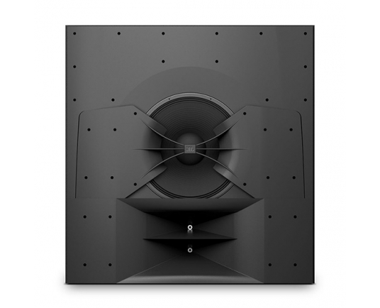

here are 2 designs from JBL to reduce beaming of midbass
Interesting designs, I feel I should try one out on my JBL 15".
I have the JBL E-120. I did not think much of it since it doesn't produce enough solid midbass down to 70Hz for my taste. And its mids is pretty garbled compared to a compression driver. The TPL-150 has benefits over a dome tweeter, but sounds a bit plastic in direct comparison with a RAAL. I will save the JBL E-120 for an electric guitar cabinet and the TPL-150 for... future kitchen radio?
