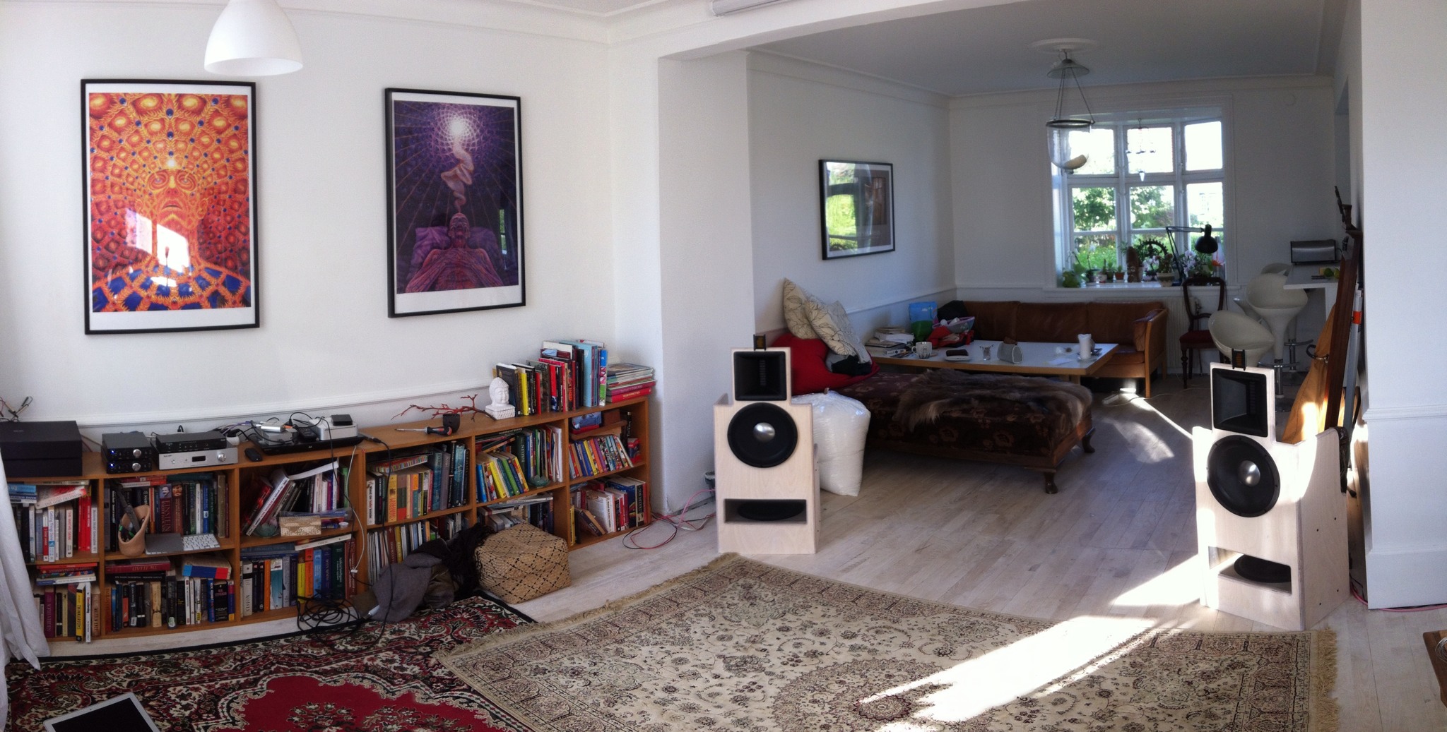

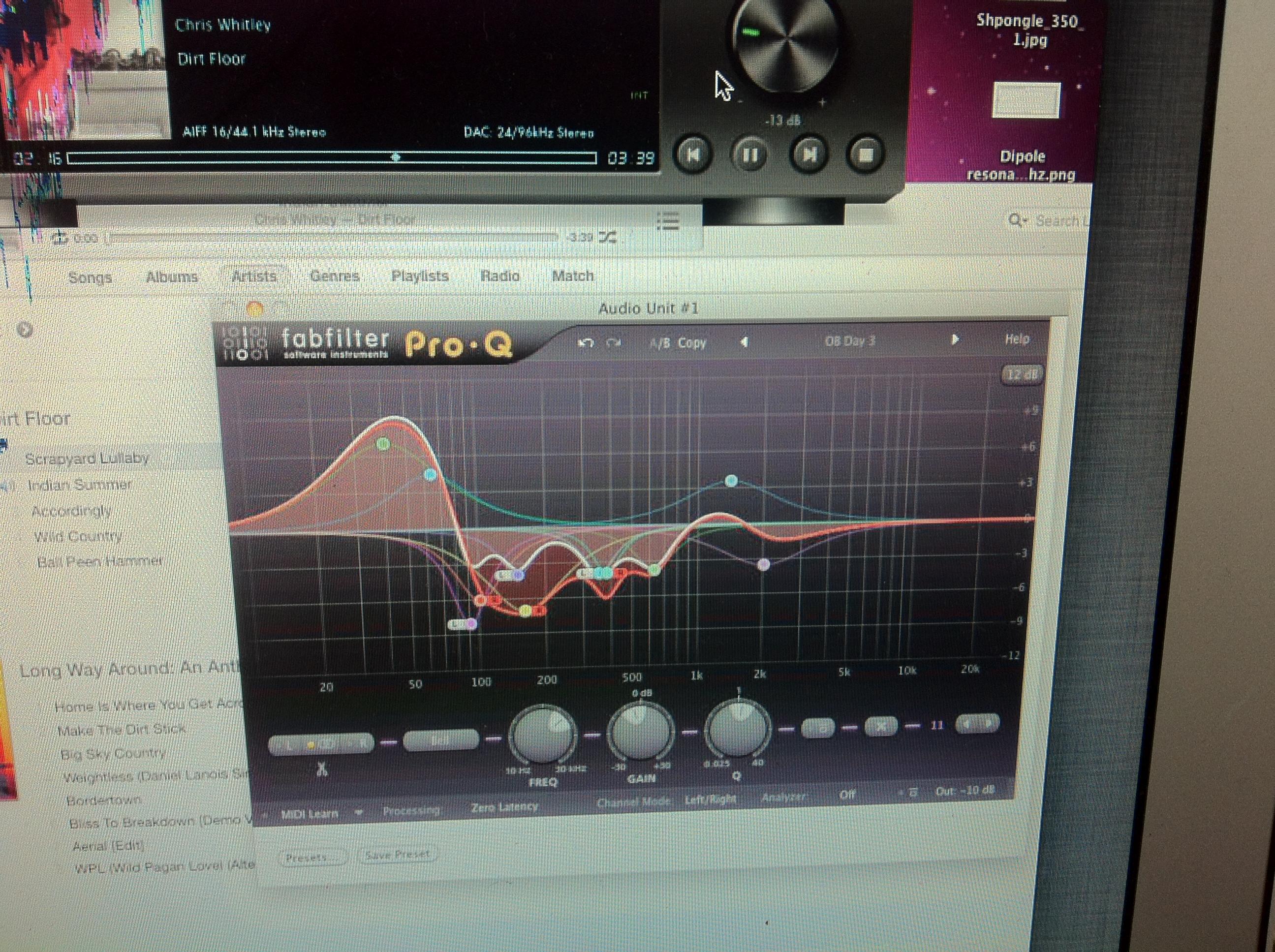

Rewind, really liking the system, but I dont feel confident comparing the Liberty to the AE given different rooms, sealed vs OB, passive vs active, etc. Some Eq needed as expected.

About the Liberty8 specifically, I find it hard to say anything without something to compare it to, and because it integrates seamlessly and seems to make no mistakes at all. I struggle to imagine a better driver for the task, but how it compares to the next-best option (12p80nd ?) I cant say.
Who's heard both in the same system and could say, I'd be interested?
