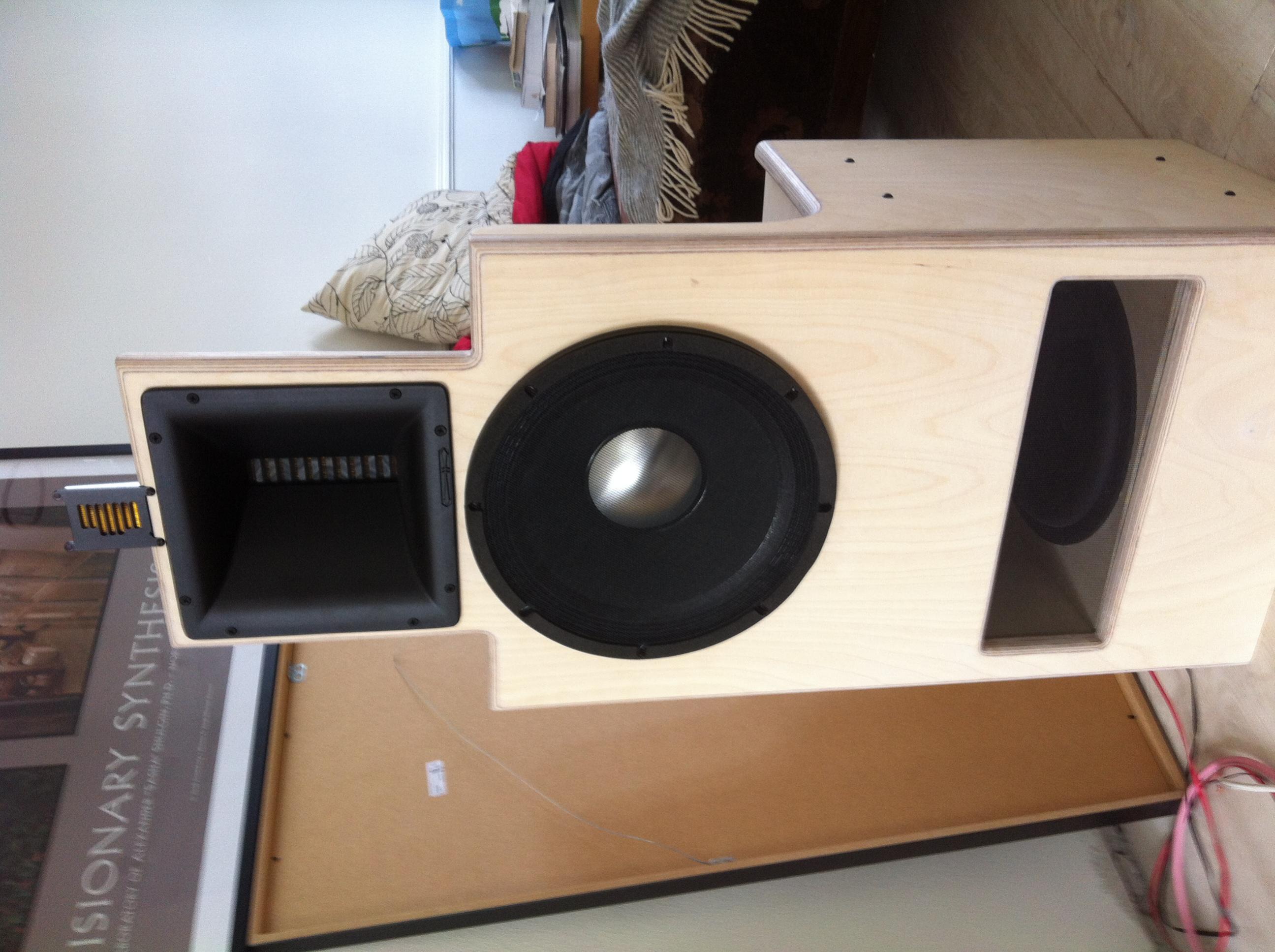

I want to use TPL-150H. if the efficiency of 12P80nd is 95db@1m, why Daniel Hertz M1 claims to reach 100db?! 12P80nd is used in M1 speaker as a midrange I think. in the datasheet it is stated that frequency response of 12P80nd is 25hz - 4Khz so why does it go down to 50Hz only?
I'm confused! 😕 I thought I could build a 100db efficient two way speaker with covers at least 40hz - 23Khz. TPL-150H performs soo good and sound good to my ears, no honkiness of horns, no ringing or resonance
does anyone has any suggestion for me? I have access to all Beyma Products and I want to have build a good speaker, I mean a world class speakers which can compete with expensive brands. how about building something like M1 but TPL-150H instead of horn + CD. that would be something fun
Because Beyma claims it as well. But if you check their data sheet, you will observe, that it reaches 100db/wm only at a small peak, above 1,8khz :

I don't think you should care so much about data sheets. The 12p80nd is a great match with the TPL150(H). If you think you do not have enough low bass, you can still add a sub afterwards.
Or you can go a other route, and use a MTM design, with PHL 2460 , which seems to be great midrange, and use a 15" below :

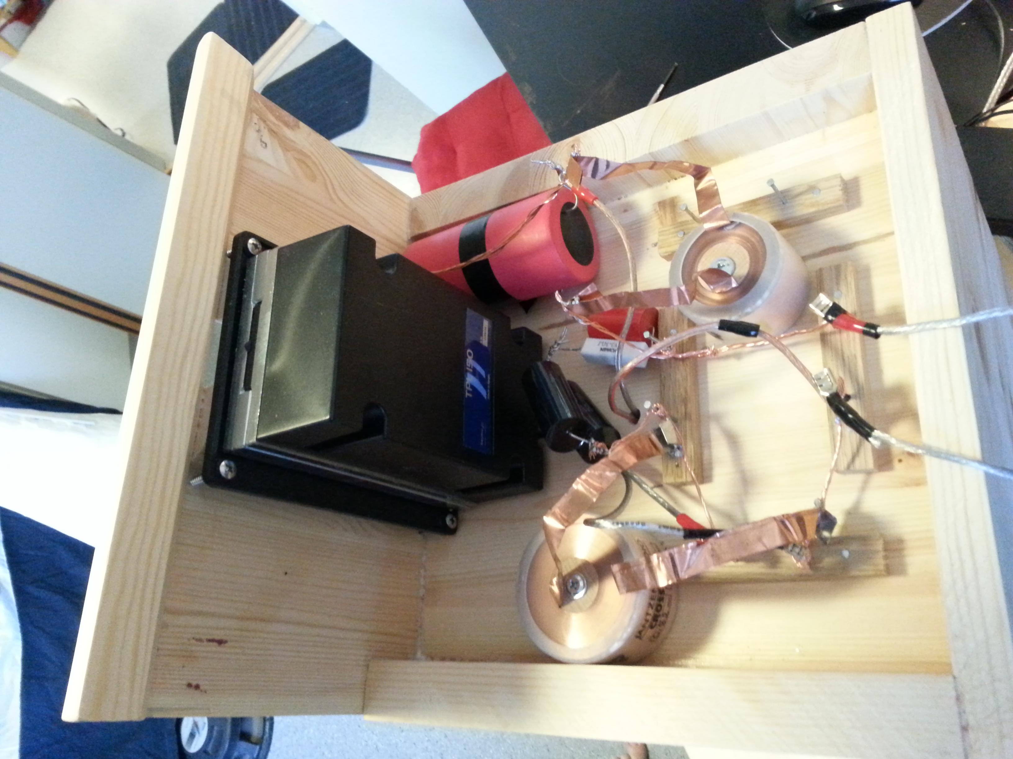

Here is something I threw together in a few days for a party we just had. Neighbours eventually called on Securitas which I just take as a compliment. One would think student houses on a Saturday night before 23:00 would more lenient. My JBL E-120 with 2204H recone lie sulking in a corner next to these 1950's green delights.
One horsepower bass is every man's God given right.

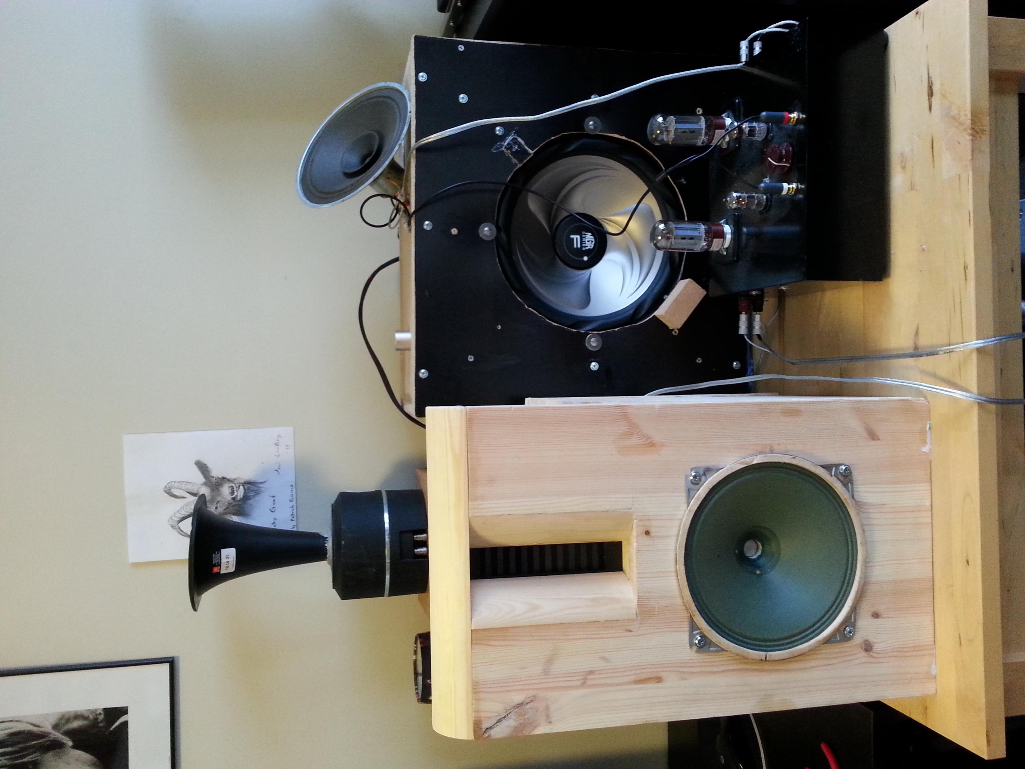

is this match of vintage midbass and TPL-150H made on purpose (like to marry a tonally rich cone driver with precise but dry uppermid/tweeter)? this is exactly what i've though beyma needs to avoid a too forensic sounding speaker.
I fell in love with both drivers on separate occiasions and just felt they would be a neat fit. At a subconscious level I may have thought in the way you describe. I could not believe my ears when I first heard it. The crossover is 1st order at 2000Hz. I made a very cheap but powerful subwoofer by connecting a HX 1000 watt PSU on one rail to a 600W car amp. The other rail still has enough juice to power my Intel i5, GeForce GTX 560 Ti computer that played Spotify yesterday night at the party. I ended up with wire thickness of 0.8 cm from the PSU so the cables do not get hot at all. It has 30A fuses in the cable, the one rail from the PSU is good for 40A and the amp has rated 25A fuses, so I feel safe. I started smelling burning plastic last night when we were playing at 50% of what the car amp can produce, but the sub driver is pretty cheap. It must be broken in now! Just built this for a party, and I am usually really into horns, but I will keep it because it sounds so good. GF can have it.
Annoyingly the black cone that is sitting on the sub in the photo is producing equally good sound, if not cleaner! Without Jantzen coils and without a fancy cabinet. The big difference is the ultra-smooth highs from the TPL-150.

I like both hornloaded compression driver tweeters and the TPL 150. In a hornless system the TPL 150 really shined. In a horn system I still preferred a hornloaded compression driver because they blend in better with the other horns.
I agree that a colourful mid driver sounds great with the TPL. A light weight vintage fullrange driver below 2kHz is wonderful. I did miss the brutal power and ruggedness of the JBL E-120 at the party when sound levels reached PA. Almost abusive to such a delicate driver as the greencone.
happy to hear that, it goes along my findings. i've even bought 4 60s oval drivers to see what i can get out of them with TPL. in fact, as it seems that a dipole operation is preferred for TPL driver, all those vintage mid drivers are designed to play in some sort of baffle so i would be curious to hear saba greencone mid/bass naked with TPL.
