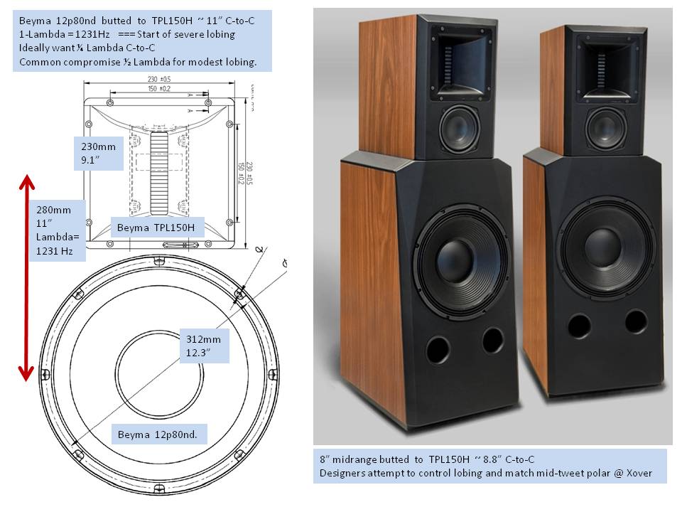

Center-to-Center distances required to remove/reduce lobing are a challenge with large area speakers. Commercial speakers with the TPL150H typically butt the two mid-tweet speakers together.
I still like the old school Altec/JBL formula of 18" woofer + 10" midbass + TPL150H, or 90x40 SEOS with compression driver. With a room multi-woofer swarm, using 15" woofers becomes more attractive.

Besides the TPL 150, what drives are used in that speaker on the picture.?? Any info would be nice, thanks.
RD75 was 10+ years ago. Not the same system or level of hearing expertise at that point. TPL was only cross auditioned with compression drivers, the Fountek Neopro5 and the Raal. In that comparo, Raal wins, but TPL was chosen for higher native SPL and durability for commercial studio use. If it were for private studio or home hi-fi as in my system, Raal is the king.
check the website of the manufacturer :
max
i like the design a lot. Just don't know why they used a low efficiency mid/bass unit for midrange duty. I'd certainly try a 8 or 10MI100 from Beyma.
max
