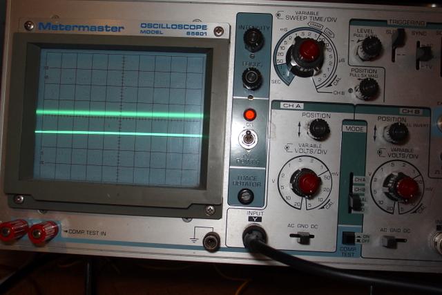

It is indeed a power darlington. And in that circuit it gave me the best performance, in reality, as you see the attached scope pic, of the regulator output when attached to the phono preamp, sadly just a prototype without a good layout, etc. There is room for improvement. Lower trace is the scope channel on its GND setting (thinnest trace possible), upper trace is the regulator, scope on 5mV/div. I expect even better results from a Jung regulator.

Out of curiosity, I run your test too, setting my scope on dual channel 5mV/div. Channel one is the output of my standard LED MOSFET CCS shunt @ 200mA when feeding my NJFET phono (upper trace). Lower trace is channel two, just on scope's own GND. I don't see any difference in thickness or any fuzziness. Maybe you pick up some spurious noise?
salas, that looks very nice; I have yet to get such a clean trace from any of the regulators I built, including the schematic you have shown.
Getting a visually much thicker and fuzzier line even with your ''turbo'' version is suspect IMHO. Points to some grounding issue or noise pick up possibly. In page one there are some analogous scope pics from a CRC pre filtered Jung in a Marantz. It thickens there too when applied to the machine. Environmental noise or total loop gnd issues again maybe.

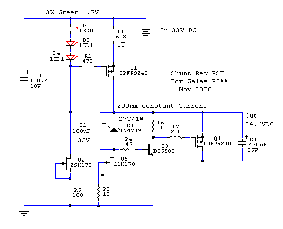

Giasou Salas,
I like your shuntreg from post #103 but one thing is not entirely clear to me: you bias JFETs (Q2 and Q5) at Idss and you use R5 (100 R) and R3 (10 R) just to lift JFETs a bit from the ground. What is it good for (using R3 and R5 like this)?
Gave me quicker transient response in this particular implementation.

Its difficult to ''see'' subjective impacts between very well performing regulators just by modeling or measurement. Most are technically more than adequate for their main mission. But if not actually implemented and subjectively tested they can't really be selected. Of course this will sound weird to all engineers, but what can I say more? Its my practical experience or illusion 🙂 . I have promised you better highs with the LED Mosfet CCS, remember? Those subjective things magnify if in phono circuits. Yours is line if I remember correctly?
P.S. That 27V/1W over the zener in the circuit under the scope pic is a typo. Its actually a 24V Zener, and its part number is correct. It can be made for different voltages by changing the Zener and feeding about 7-8V more Vin than Vout. The limit is about 43V DC Vin due to the 40V max of the 2SK170 on the left. I change that to a ring of two higher voltage pair if I wanna go higher. I use about 10mA Idss or I set the ring of two at 10mA so to help the LEDS work at their good region. Red or green under 2V ones are most adequate.

Only thing that worries me is Pd of Q2 - with 10mA Id Pd is more than 250 mW
It might be solved by using the R5 of higher value - like 1K maybe ?

Salas,
I'm not sure I understand your shunt reg. How much current is there going through the zener? And where is that current going to?

juma said:Only thing that worries me is Pd of Q2 - with 10mA Id Pd is more than 250 mW![]()
Otherwise![]()
Its a 400mW part and none have failed in 5 months 24/7 power on. So no worries.
No that's not my point. How much current does it run, and where is that current going to? Into the base or into the current source?

janneman said:No that's not my point. How much current does it run, and where is that current going to? Into the base or into the current source?
Jan Didden
Sorry, that was going to Juma, but you posted in meantime.
Q5's almost Idss current runs through the Zener. Its not going to the BC550C's base.
