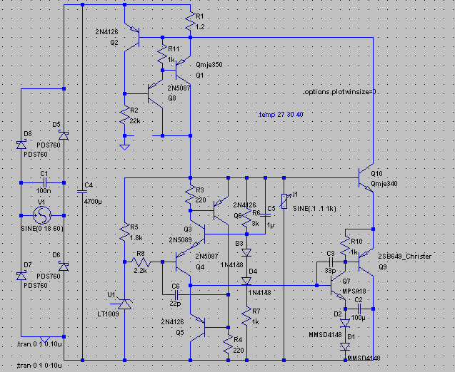

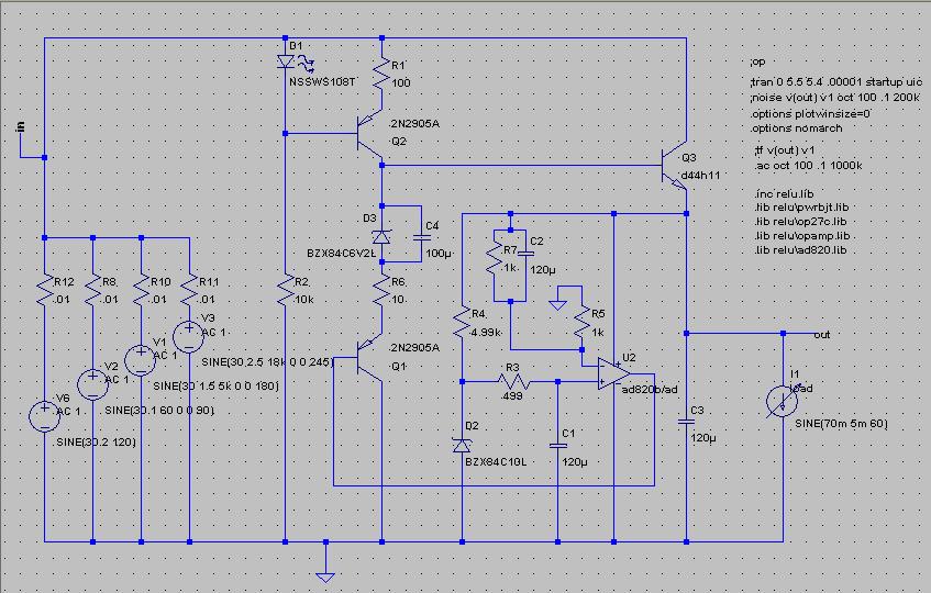

jwb said:As long as we're simulating things, I thought I'd have a look at the improved Jung regulator. The output impedance is nice: below 1mOhm from DC to 4kHz, rising to 25mOhm at 96kHz.

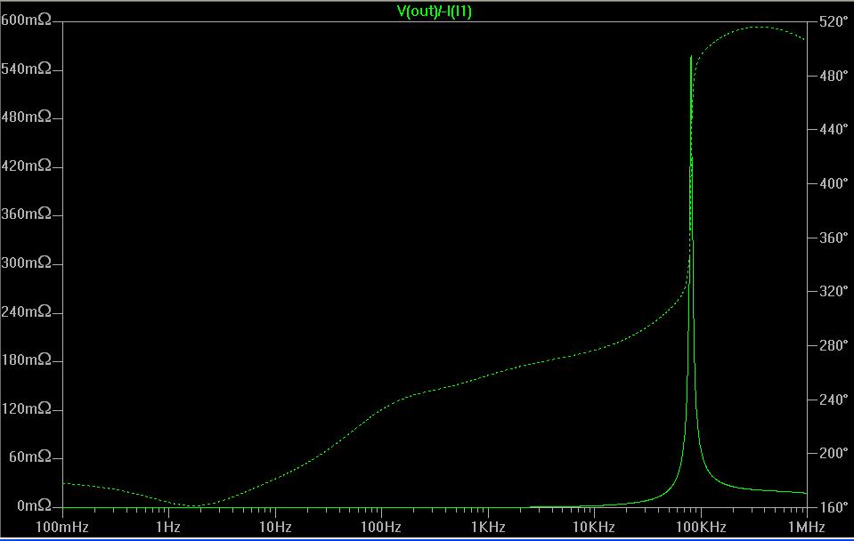

Hi jwb, I've simulated the Jung regulator in the past, various versions, but never got such good results as you. I tend to never use perfect current sources and such, in an effort to be as close as possible to the real thing (such dreams eh?). Even so, I take my own sim result with a large grain of salt. However, I would be interested to see if your results turn out as good if you replace the perfect current sources with the proper parts. Thanks in advance.
ikoflexer: according to your simulator output, I'm sure your version of the Jung is oscillating. Try adding about half an ohm of ESR to C3.
I'm not sure how to model current diodes like Vishay J506. Those are the ones I use in practice. I shall look around for some canned spice models.

Here's the result with a .5R ESR on the output shunt cap.
As I said, I am pretty sure that the Jung regulator does an extremely good job in practice. My last attempt at a prototype was not very successful, as it oscillated like crazy. I'll probably do it again with some care as far as the layout goes.

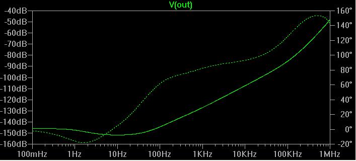

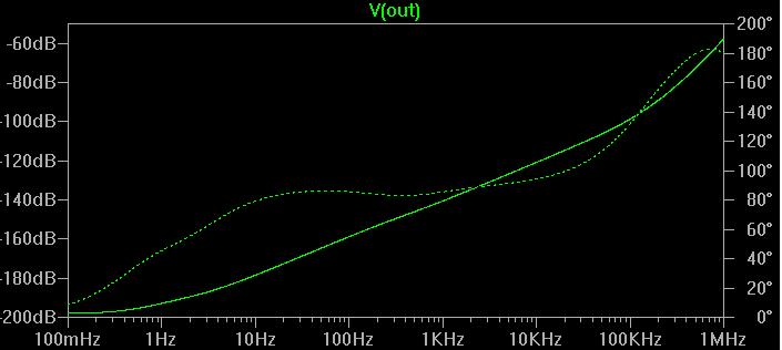

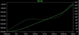

Yes, it is ripple rejection. A couple of posts back I plotted output impedance as well, shown as V(out)/-I(I1), with the Y-axis in mohms.

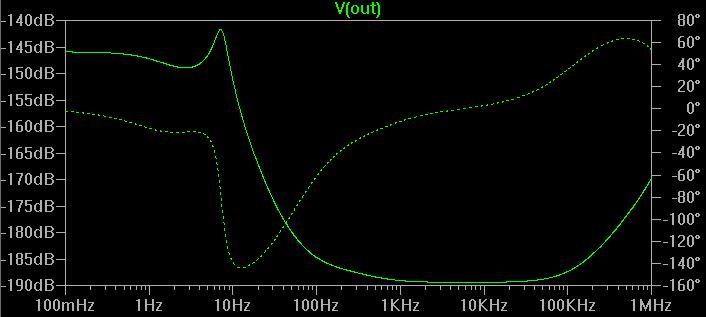

I'd like to mention a little detail which a lot of people may not realize. A humble low-pass filter at the input can make a big difference in practice. The Jung regulator especially might be a good candidate since its psrr curve raises as frequency increases. Here's the psrr plot for the ad820b version, with an LC filter (L=100mH, C=4700u) at the input.

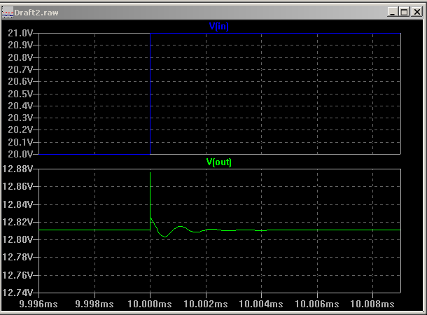

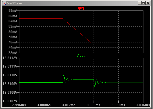

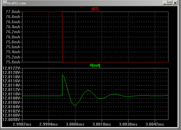

That said, I think the Jung has creditable transient performance. Here, for instance, is the response to a 1V transient with 1ns rise time on the input.
Looking at your last post, if I'm reading it correcly I'd say you have problems. There should be no overshoot or ringing.
Using a rise time of 1ns is not practical.
Use a few u seconds.
The reason to test with a step or square wave input is to se e how th e circuit behaves wrt to line noise - and you do get spikes and straight HF noise coming through much more than you would believe. How does your cuircuit behave unde r thes e conditions - does it pass th e nois e straigh t through? does it oscillate? Its easy to deal with DC or low frequncy input voltage shifts, but at higher frequncies this is another matter.
Bonsai said:Looking at your last post, if I'm reading it correcly I'd say you have problems. There should be no overshoot or ringing.
The last post is with a 10us rise (fall) time.
