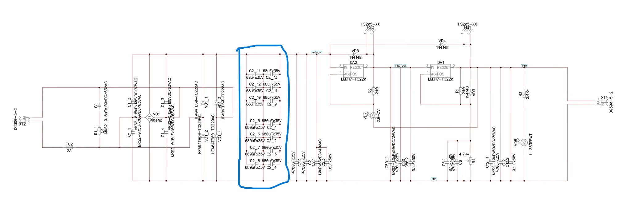

Prerequisites are large capacitances at the voltage input of the OP amp and a current through the shunt that has approximately the same value as the current through all OP amps that are in use.
What is the performance of this power supply?
What does the circled part on the diagram represent, what is the role of those capacitors?
I guessed what their role was there, but the diagram is drawn less professionally.
As for the quality of the project, I'm waiting to see what the author says.
Various electrolytic capacitors (capacitors dimensions) in PCB.
See attached file.
Solders follow capacitors.
C2, C2_11, C2_12, C2_13, C2_14
or
C2.2, C2_9, C2_10, C2_11, C2_12, C2_13, C2_14
or
C2_1, C2_2, C2_3, C2_4, C2_5, C2_6, C2_7, C2_8, C2_9, C2_10
See attached file.
