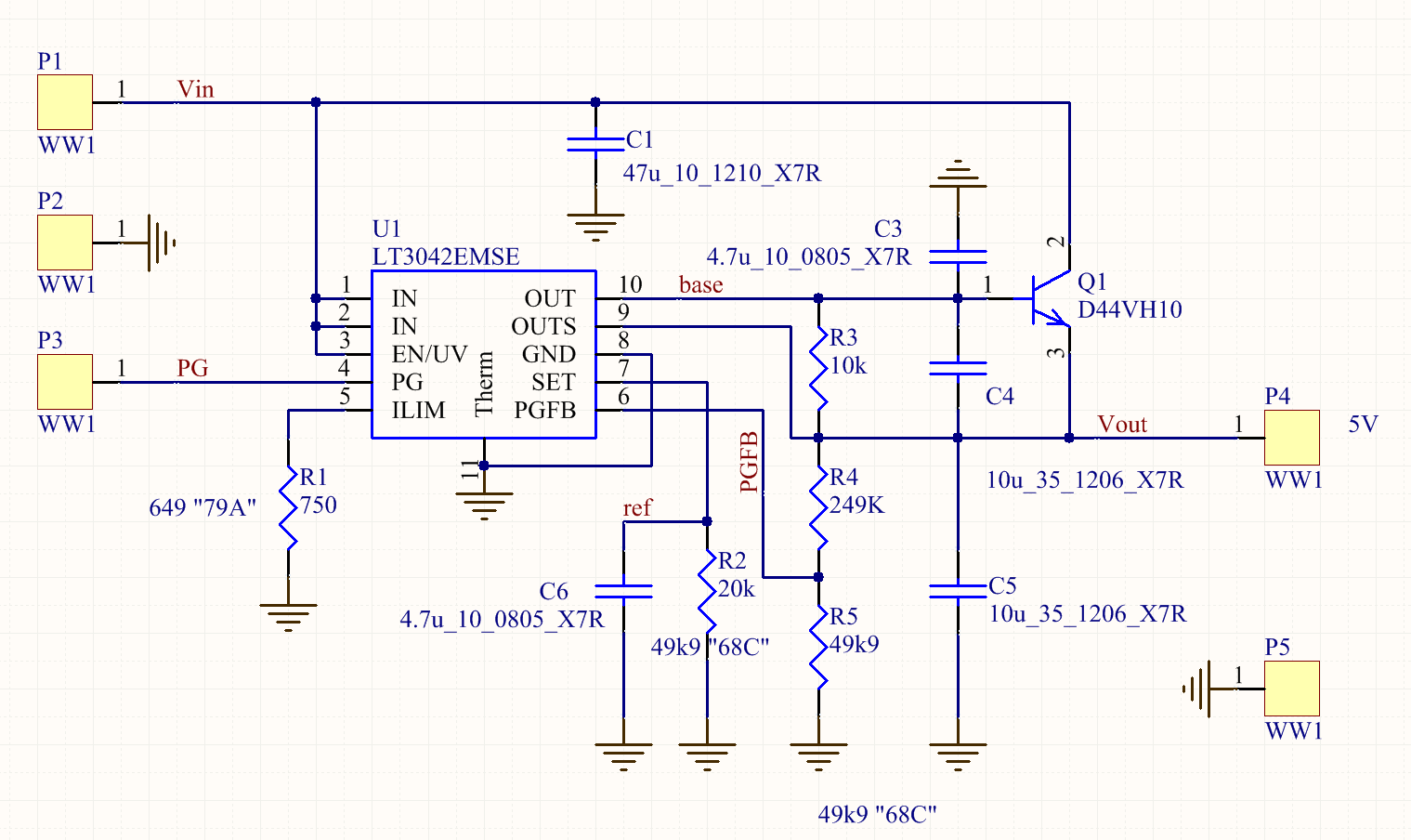

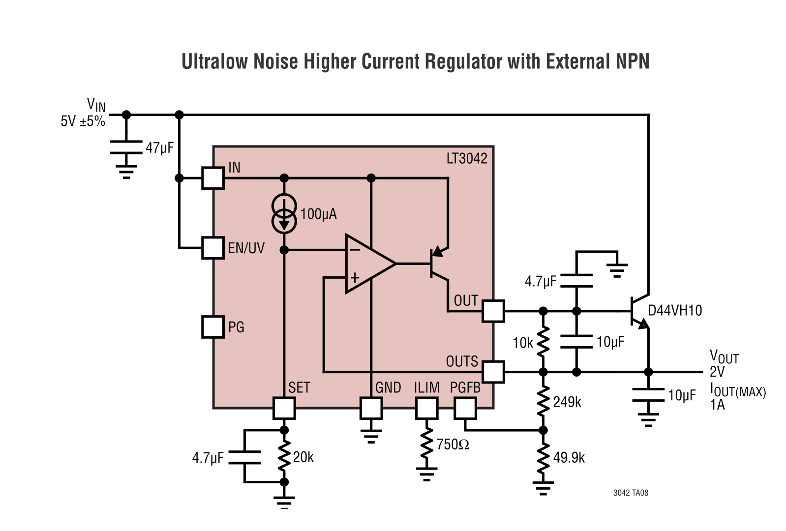

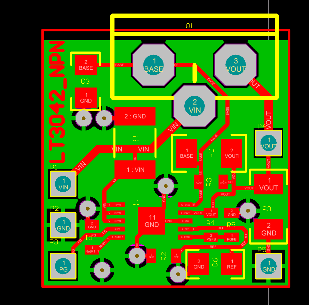

I have made a tiny layout for the npn circuit in the data sheet.
I have no idea of a negative version that does not have at least
2 op amps.

OK, I gave it a bypass. I might need it for a 3 GSPS ADC.
< https://www.flickr.com/photos/137684711@N07/29197476530/in/dateposted-public/ >

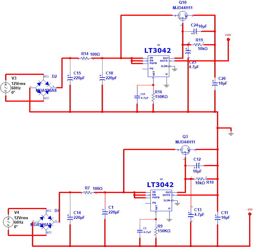

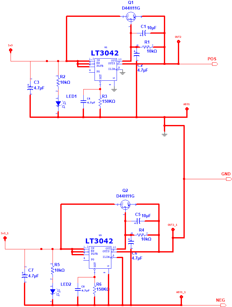

Hi, Can this work?
Dual 3042 with external NPN for higher current demand.
Hi, Can this work?
Pretty sure the negative regulator will blow up. The positive-side regulator is fine, of course. But you have not properly translated the positive circuit to a negative one. On the negative regulator the ground is now positive--which is wrong. The most negative point is the -15v rail so that would need to serve as ground for negative regulator. That is my understanding. In particular, Gnd, ILM probably need to be tied to -15v. Googling "positive regulator for negative supply" or similar reveals this to be a bad idea.

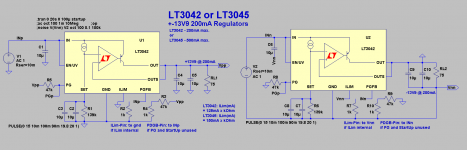

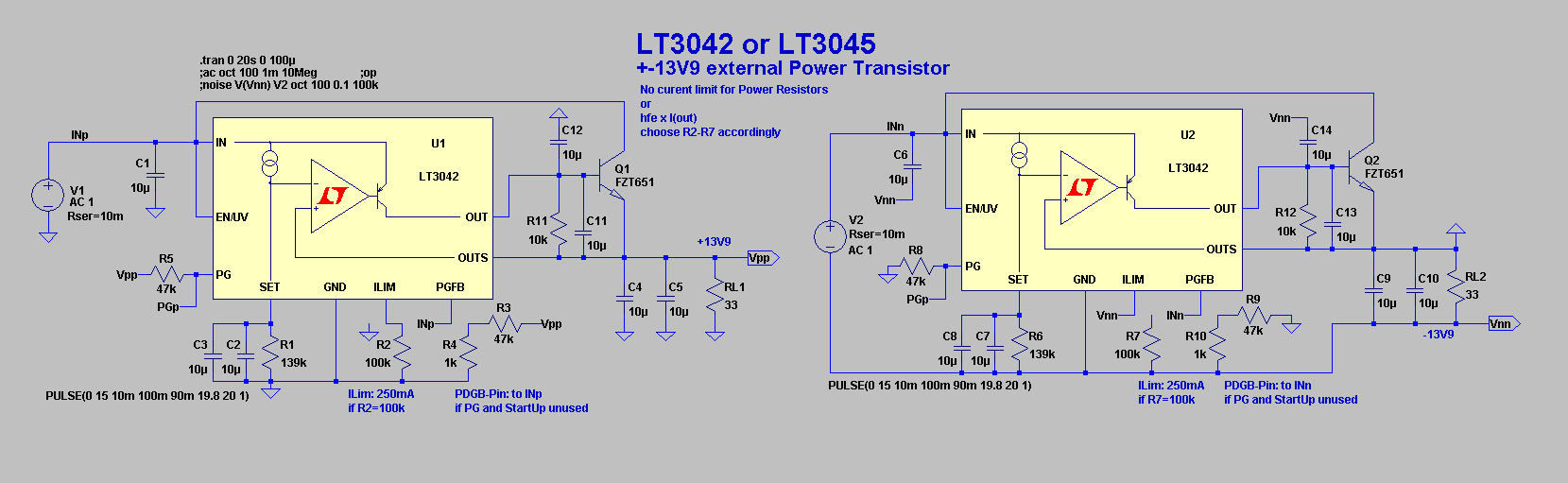

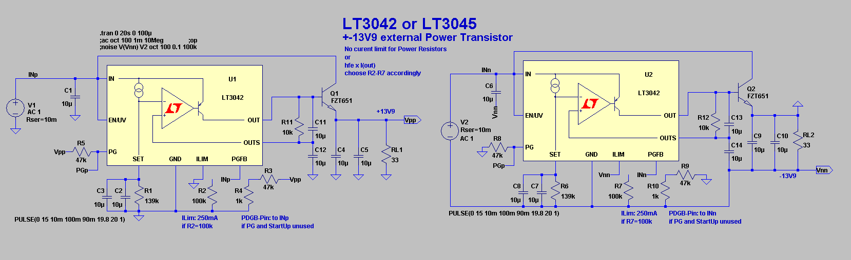

zip-file attached ;)
Using a external transistor one needs to either omit with the current limit feature and risk a possible damage of the power transistors in case of a failure situation, or one needs to reavaluate the ILim-Resistor values.
The sim results in +-13V9 output voltages as the setting resistors are chosen to be 139k (100+39k).
This is done as the input voltages are assumed to be 2x 15V.
A Input-Output differential of 1.1V is sufficient for the non-boosted circuit but on the edge for the boosted ... a bit more voltage differential should be beneficial.
jauu
Calvin
