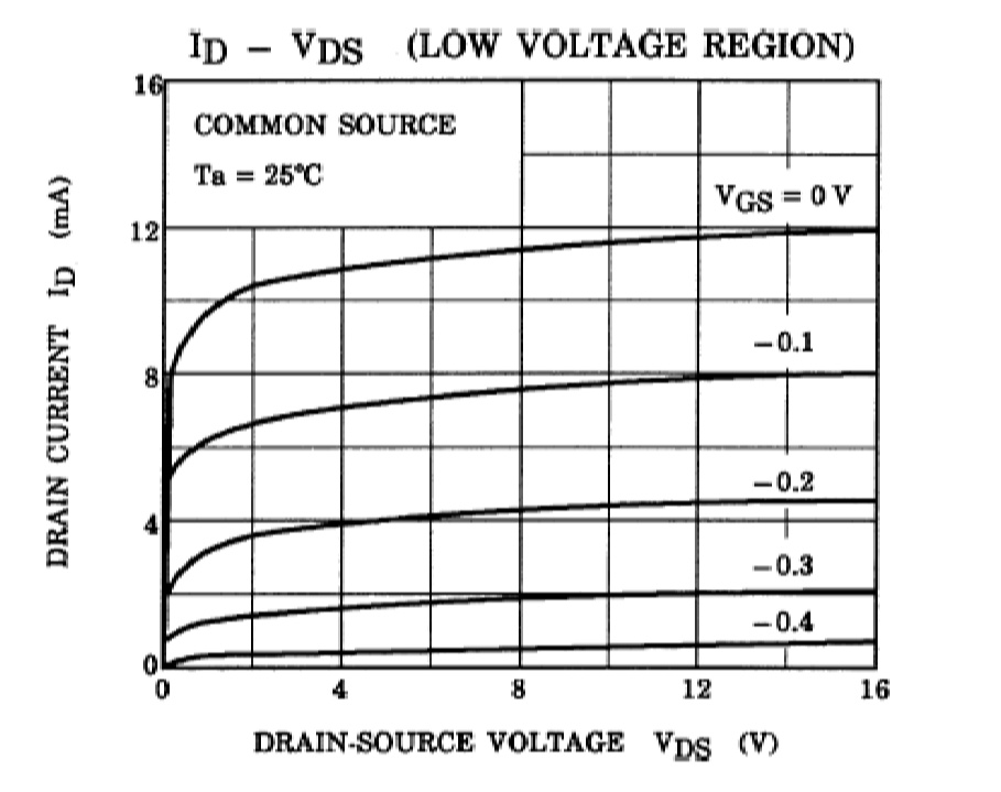

This is what we are talking about, right? Vgs=0, Id=10mA. Seems that the Vds is higher than 1V anyway. Or am I missing something?
Jan Didden
janneman said:
So there's about 0.5V across the FET. Does that work as a cs with such a low Vds? I'm not a FET man, but seems quite low.
Yes. For Vds=0.5V a 2SK170 is most likely in the saturation region (where it acts as a CCS). Incipient saturation is defined as the region where Vds>Vp 2SK170 has Vp=-0.2...-1.5V so Vds=0.5V will do.

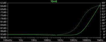

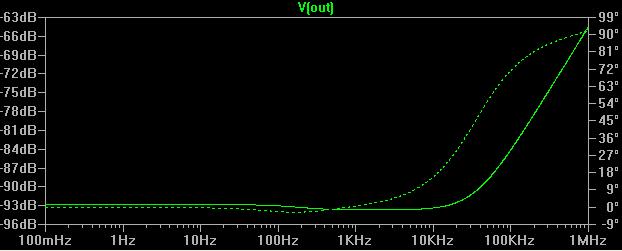

And while we're on the subject of simulation, if we're to believe any of the fiction our simulators tell us, who would like levels of line regulation like the attached?
Bonsai said:
Looking at your last post, if I'm reading it correcly I'd say you have problems. There should be no overshoot or ringing.

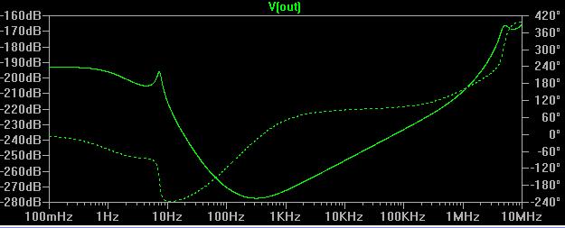

I think the entire power system needs to be addressed when looking at these regulators. For example, in the project I am working on today, there is a Jung-type regulator, but there is also an array of 8 39µF OS-CON caps, 8 1µF ceramic caps, and an 800pF capacitance due to the ground planes of the PCB. Output impedance of the whole system is < 100mΩ out to 80MHz and < 1Ω out to 400MHz, which I think is acceptable considering the passband only extends to 96kHz.
Regarding your comment, I agree the ringing was excessive in the plot I posted. It turns out that the AD825 has far better transient behavior than the AD820 (in simulation). I use the AD820 for low voltage outputs since it can swing rail-to-rail and run from a single 5V supply, and I use the AD825 for outputs ≥ 9V.
As you can see from this plot, the transient load response is rather good. For a (quite improbable) 25mA load step with a 10µs rise time, the output swings only about 10µV. That's -68dB @ 100kHz.
