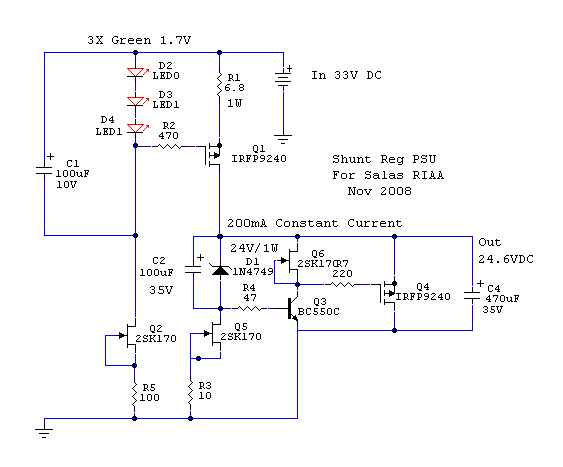

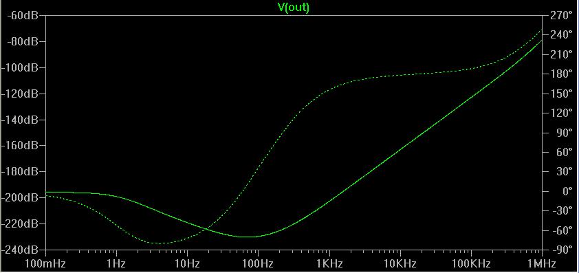

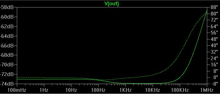

salas, see the curve with the resistor (attached) to infer db improvement. 7.43mA going through the bc550c. It is almost the Idss of the jfet above it (since I modified the 2sk170 model to simulate at about 7.5mA Idss).
So its about 20dB better with just substituting R6 for an Idss 2SK170 and absolutely no other changes? Like here in the attachment? If yes, OK no problem, I will mod it and listen carefully. The BC550C goes to 156mW with 7.5mA so it does not seem to be a problem.

I will listen to what the JFET CCS does instead of the resistor first. On the other hand you saw the shunt + phono scope traces for noise, and my FFTs with 100Hz buzz at -107dB of shunt+phono, so I don't know what all those nice additions will practically do. But I am curious. Make the super sim and listen to it too VS your second best, would be my suggestion.
Yes, that's the only change I've made. I'd say, while simulation is fun, please let me know what happens in reality.
I have to say again, this is all academic. I too, at the end of the day like practical solutions. But man, getting another 80db improvement in the simulator beats sudoku any day for me 😀 I will put this one through a battery of tests and if it survives I'll prototype it too, nothing to lose. And, you'd be surprised how well the opa134 works in a regulator :whazzat:
I like the soft trend of rise and phase that you simulated on the simple ones. Now if the resistor one that I have in use now, really does 74dB, if we assume 200mV peak to peak ripple from a wall wart DC in (not the fast bridge and 33R to 10mF Slit Foil that I really use), it will divide it by 5000 times. 0.04mV 100Hz ripple at the phono B+. If it only does 40dB then 2mV P2P. And then there are local RC filters...No wonder it does not buzz.
syn08 said:
Check the loop stability, I smell trouble.
Thanks Syn08. I will just install it instead of R6 and will check for real. If it burns a BJT and a Mosfet, no worries. I spend as much a day for cigs and they do me no good.😎 Instead I will inhale magic smoke.😀

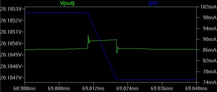

Could someone with experience please shortly explain what the desired behaviour is as far as transient response to changes in the load?
jwb, I tried a similar test to yours, with my simulation of the Jung regulator, attached, and then with a new regulator in the next post.

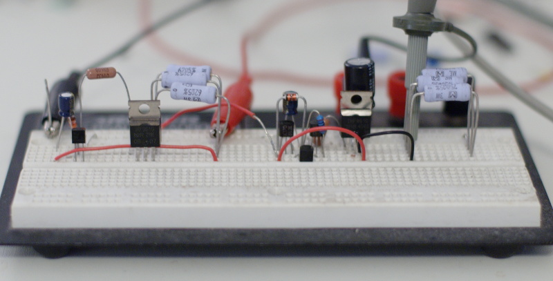

Here's my 9V version of the design by salas. I think it's brilliant.
I was forced to use IRF9610 because I don't have any power P-channel FETs on hand. The 9610 has Rds(on) about six times higher than the IRFP9240, so the line regulation is not as good. But it works! It doesn't oscillate at all, and whatever noise there may be is well below the ability of my scope to measure (also well below the noise from the bench supply input.)
I like it!:nod:

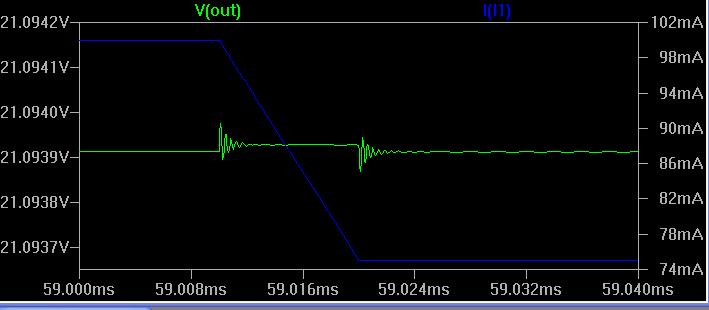

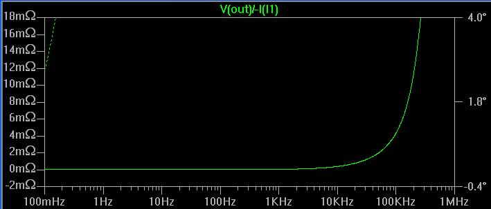

jwb said:
First, let me thank you for the stimulating conversation.
I think the entire power system needs to be addressed when looking at these regulators. For example, in the project I am working on today, there is a Jung-type regulator, but there is also an array of 8 39µF OS-CON caps, 8 1µF ceramic caps, and an 800pF capacitance due to the ground planes of the PCB. Output impedance of the whole system is < 100mΩ out to 80MHz and < 1Ω out to 400MHz, which I think is acceptable considering the passband only extends to 96kHz.
Regarding your comment, I agree the ringing was excessive in the plot I posted. It turns out that the AD825 has far better transient behavior than the AD820 (in simulation). I use the AD820 for low voltage outputs since it can swing rail-to-rail and run from a single 5V supply, and I use the AD825 for outputs ≥ 9V.
As you can see from this plot, the transient load response is rather good. For a (quite improbable) 25mA load step with a 10µs rise time, the output swings only about 10µV. That's -68dB @ 100kHz.
The real test, of course, is with the implementation: pcb trace resistance and inductance, parasitic capacitance, wiring inductance and so on. You may or may not recognize those waves in the real thing 😉
