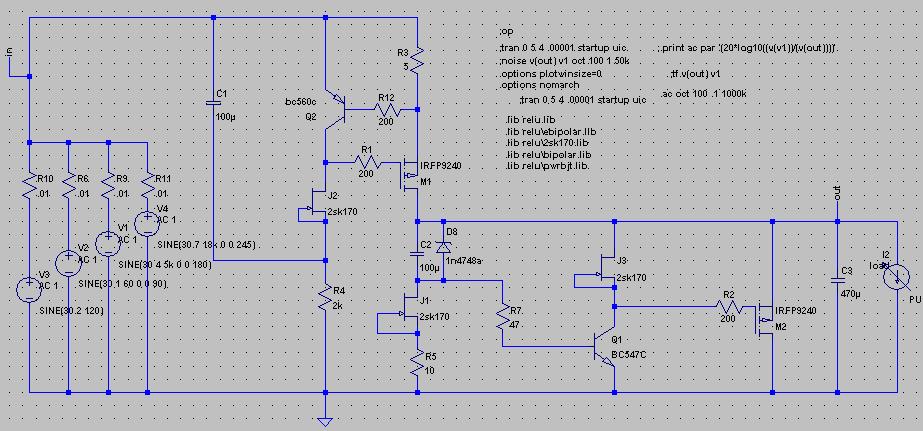

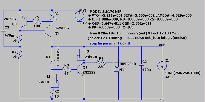

ikoflexer said:
Used .5 ohms ESR for all caps in the simulation, and no ESL. What value would you recommend I use for ESL? Thanks.
Edit: BTW, here's another result using the lm4562.
Various cap manufacturers spec their ESL from around 5nH for ultra
small size to over 30nH for large can types, then add some more for
pcb trace to cap.
I've been using 10nH for OP cap.
It certainly has a significant effect on the simulated load step
response, especially when using fast edge rates.
cheers
T

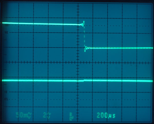

Jan, in my implementation it shunts about 80% of the 200mA CCS current at all time. The rest goes to the load presented by the 2 phono channels. Some goes to the Zener and BJT of course. Can this be of any consequence? VGS is 3.3-3.4V.
No I haven't listened to it yet. Transient performance isn't bad either. The top trace is the load signal into a 62R load (about a 25mA load step), and the bottom trace is the regulator output.
syn08 answered me that question in another thread. He said that except than in switching applications, in a linear regulator we will not drive a Mosfet (either in series or shunt) to conditions that will make this characteristic relevant. So jwb, no worries about less regulation due to more rds(on) with the Mosfets you have. I only subjectively favor TO240 IRF Mosfets in the shunt which happen to be relatively low RDS(on) too, I don't know if there may be some electronics explanation.
0.03 Ohm flat from 20Hz-20kHz I find splendid, since the output capacitor and cabling to my phono can easily mask that. I especially like the flat behavior.
