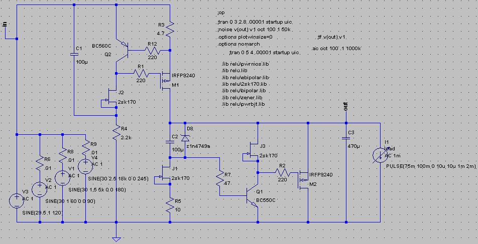

If you feel like it, would you please comment on the circuit attached? While it is not the most extraordinary in simulation it does have good results there too. However, in reality it performs very well. (For outstanding simulation results I posted a circuit earlier, unreal, really.) Do you see any possible areas where we could improve? Thanks in advance.

It's great to see all these nice simple ccts that do the job well and also sound good.
Perhaps the R4 could benefit from some more attention.
Add a small resistor (0.1 - 1 ohm) from o/p rail to M2 so you can actually measure the shunt current - won't effect the result.
IRFP9610, etc?
Have youb tried feeding this with a simple series reg (low ripple), or alternatively, with a Cmultiplier (high Z)?
Generally, good sound results for small number of extra components.

This other circuit, the "solid" one, you can blame salas for the original design 😀 I only tweaked here and there. This is the one I am using at the moment, it is appealing on many levels; in fact I couldn't stop using the prototype. BTW, have you listened to it with your "noise" headphone thingy? With a proper board layout and case should be even better. PCB layout design may be in the works soon (for through the hole parts), but I'm also personally thinking of going the smd route for this one; maybe.
I'm also thinking of putting together a Dennis Colins noise amp, as I'm having problems gauging the performance of this regulator.\
