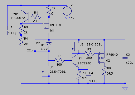

jwb, in these tests, were you using the exact circuit from post 214? It is important if we compare, to compare apples with apples.
OK, here's the exact circuit I'm testing.

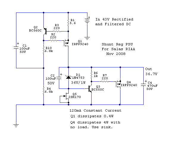

ikoflexer said:
I can confirm that pulling out J1 is detrimental; I left R5 in because I never got the time to experiment with it, but pulling it out probably will not affect much. However, I cannot say I've tried it.
It just helps a wee bit, especially with grounding. You can pull R5 off without any penalty.
But if you were really worried about that you could put a resistor and a capacitor on the emitter of the NPN and raise the Vds across the FET. Then you would not need to worry about the pinch-off voltage.
Actually I think that's a good idea, because then you have a way to trim the output voltage. 200R in parallel with 3800u would give you about 3V across the FET without sacrificing low-frequency performance.
The way it was I was naturally worried about pinch off. It got it designed under a minimal component idea and to recycle spare 2SKs remaining from the RIAA circuit matching process. This is a nice idea to lift the emitter. 2 more passive components, no big deal. How is the transient performance with the large cap and resistor lifting the emitter? How much ESR did you simulate for it?
I just measured the output impedance with a sine wave load of 9mA RMS on top of a DC load of 65mA. Output impedance was below 10mOhms from 20 to 40k. Anything lower is below my ability to measure.
Didn't simulate it, and when I built it I used an ordinary NHG capacitor (standard ESR).

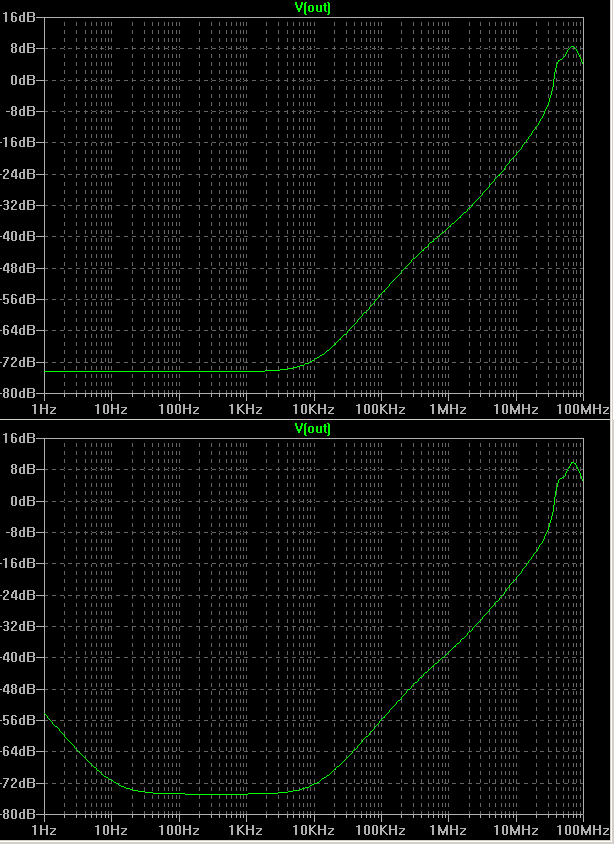

jwb, this latest moddification degrades regulation both in simulation and in the real circuit. Perhaps someone can confirm either case. I have applied the modification you suggested to the circuit salas presented earlier, and not to your 12V circuit (I don't have those parts on hand); at the moment my interest is in a higher regulated voltage (24-25V).
Define "regulation"? Output transient response or something?
Here's the simulator output for ripple rejection. The grounded emitter (original) on the top, the AC emitter lift (current) on the bottom. I agree that the simulator makes it look worse, but on the bench it measures better.
Any chance of showing the ripple rejection output with R3 (from post 241) replaced by a 2sk170 ccs?
