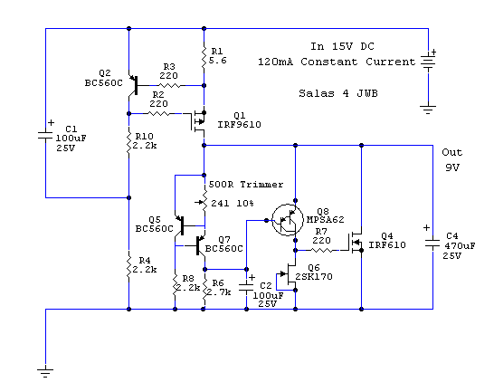

Onvinyl said:How about exchaning Q1 with a mosfet? You get more voltage drop for free, just add the drop the zener value. I've done it with 9610 and zvp3306 successfully in my own reg.
Rüdiger
Do you mean Q3?

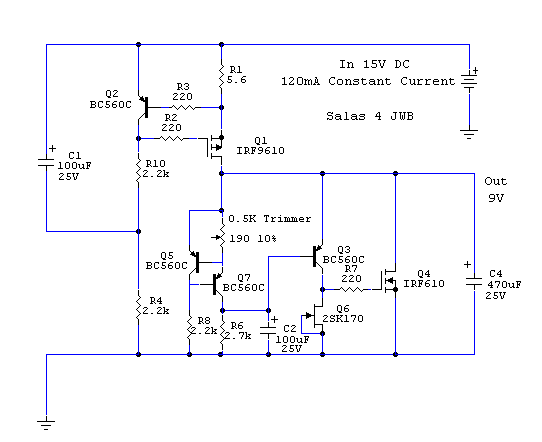

If you feel like it, would you please comment on the circuit attached? While it is not the most extraordinary in simulation it does have good results there too. However, in reality it performs very well. (For outstanding simulation results I posted a circuit earlier, unreal, really.) Do you see any possible areas where we could improve? Thanks in advance.

J1 R5 is overkill and seeing that semicondcutors generally operate better in linear mode when they have more optimum operating points then it is not optimal from that perspective and in this application. It can be replace by a resistor as Vbe of Q1 is relatively constant, Vbe/R = constant I.
The MOSFETS are over specified for the circuits parameters and intentions. Better performance can be gained by choosig a more suiably spec'ed part.
D8, C2 could benefit from RC filtering. You have the C there already, just need and R between D8 and C2 -ve to base Q1.
In Salas's post #255 it looks like the headroom for the current source feeding the shunt is marginal.
I feel uneasy with how the circuit balances the shunt current, but it is just a gut feeling. D8's biasing comes to mind.
I would prefer to use bipolars rather than MOSFETs.
R4 and J2 positions can be exchanged to improve what you are trying to do here. However, I see it as overkill and that the current source performance would not be degraded much by removing C1 and R4 and just using the J2 current sink. Of courxe a series R for J2 would be needed to keep its Vds in range if higher voltages are used.
J8 can be replaced by a resistor as in Salas's post #255. This ressitor will set the bias current for Q1. I.e Vgs(m2)/R(Q2)

Q5, 7 cannot operate properly with only 600mV coming from Q3.
In all of these schematics, they would have better DC operating conditions if the single transistor (Q3) were replaced with a Darlington.

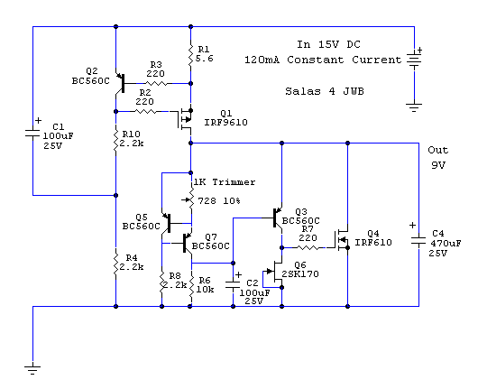

based on your posted values and voltages,salas said:Q5,7 they still work though.
Q3Vbe~620mV.
Q5Vbe~610mV and
Q7Vce~10mV.
Will it work with these values? Maybe, but how well?
How much base current is passing Q7?
What effect will this have on performance?
q7 passes 0.83mA to create the 8.3Vref+0.7VbeQ3=9Vout. Base 253uA.

how much current do you want to pass Q7, when Vce~10mV?
What is the base current of Q7 when you do this?
How much will this base current vary, as Q3 asks for more/less drive to operate the shunt regulator?
Edit.
I see you quoting 253uA IbQ7.
What effect does varying this have on the way Q5 tries to hold a constant voltage across the 1k trimmer?

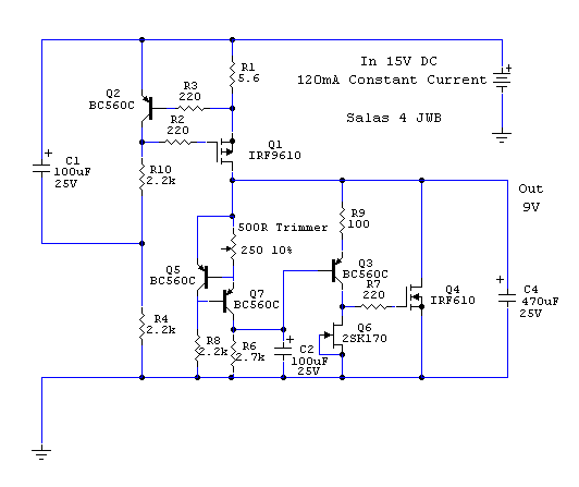

Babowana said:Could be better with Re inbetween 100R and 150R?

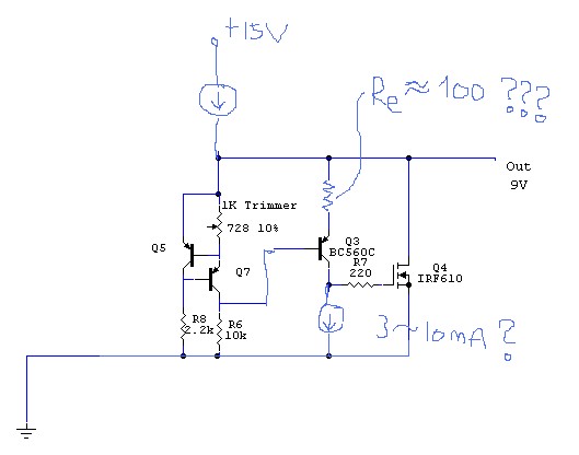

I am sure about it. Real best will show on bench. Simulators aren't for such questions especially when simulating simply and fast for checking some ideas. Is it really worthy to increase the DC margin for ring of 2? Will the Darlington oscillate in a practical layout? Need different stoppers? That is why I said it must be practically tested and compared. Good thing so far is that we saw we can lift the transistor instead if there is oscillation with a Darlington, and there is practical performance gain to have more voltage bracket for the ring of 2. If JWB likes it, he may test. I devised it with him in mind, since he uses such Mosfets and has it breadboarded.
