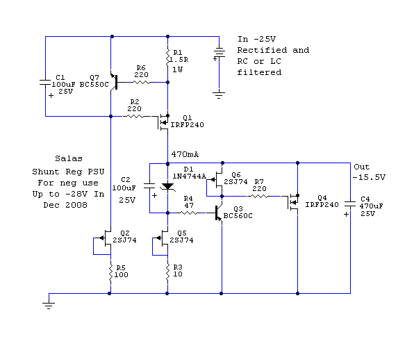

I do like JWBs cct as post #248 or #283 and will try this, but not sure about neg rail version and if there is provision for slight rail voltage trimming (avoids using servos, etc).
Could I ask if either of you find some spare time in your busy schedules to knock up a -ve cct for +/-15Volts @250mA for the "perfboard plumber"! [supply is +/- 28V after Cmx @ 1A - have the 9610/610s and also the H44/45s]

I routinely run its CCS at 250mA to only consume 40mA plus swing on the phono, plus what the shunt circuitry consumes. Why I run it so hot? Because it delivers better firmer tone to my ears that way. I had chosen the IRFP9240s for current waste, and low oscillation possibility for easy variations. Its also things I hear between smaller or heavier Mosfets, I also don't like BJTs as CCS or shunt elements no matter how better they can regulate due to their superb current gain. But don't mind me, this is deeply subjective. Also I find the issue between some more dB or less performance here and there not a real issue because I can always passively pre filter the shunt's input for ripple and HF or RF garbage. This does good to all regs. To the contrary, I don't like the tone when wrapping a Mosfet shunt in an IC pre reg.
The hotter it runs the better, 2 times what is consumed is good, but I prefer more. To get to what is consumed, Andrew gave a very correct way to calculate. My simulator shows it OK in heavy currents, and It is running at 3A, 13V for a 10W T class amp for about a month now. Sounds like a million dollars.

It looks like adding the bigger IRFP after all - no problem and running a good bit of extra power thru the whole thing for 250mA O/P, needs to sink the same amount, or more (thanks Andrew) thru the Shunt (250mA+) for a total thru the reg of 500mA+ - and with a reasonable heatsink (total 500+mA load, both IRPFs), keep the temp below 50*C. No problems, will do.
It appears that this design is quite happy with the heavy working conditions (3A, 13V) - This is good to know, particularly as this simpler cct, or variations, will become widely accepted.
So it looks like the specs for the + and - reg for my "oh so nice" DOA headamp looks like total current of 500+mA with 250+ thru shunt at +/- 15volts.
I'm not sure that simply converting the components to -ve will actually operate the same (j74, etc, IPRF9240, etc) so if it's possible for you to run this thru the SIM, it will save quite a bit of "stuffing about" before putting the "perfboard plumber" back to work!

G' day James. Here's your -V one. You know how to work out the positive from the other schematics.

Don't waste your precious J74's on these CCS's, use K170's but
remember to put them in the right way 🙂

6:55 AM here. Use any JFET simply available that comes near, except for Q5, gave the circuit as a guide.

K170 is a (slightly) better choice than J74, it is cheaper, has lower
capacitance and is available.
BF862 is readily available, cheaper again and is identical to K170.
FWIW, the zener ref can be changed to a TL431 and biased up with
a resistor. It will have less voltage drift with temp and will be a
more stable reference. However it will need to be RC decoupled to
attenuate noise.
Otherwise the reg is really very good. I simmed JWB's and the
performance is quite spectacular considering the small parts count.
cheers
Terry
Don't substitute the Zener in my opinion, it has no drift in practice and its the least noisy. The shunt gets to nominal at about 10sec and then never drifts. I use such shunts for 5-6 months now. The RC filtering means time, and time means slow down. I avoid.
In practice all the variations are same for core performance. And the Mosfet CCS does sound better. Ok I said it!😀
