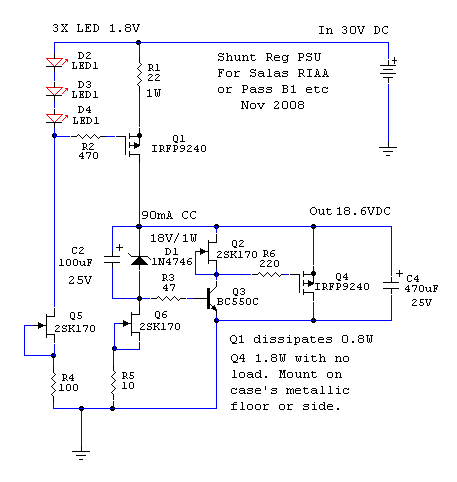

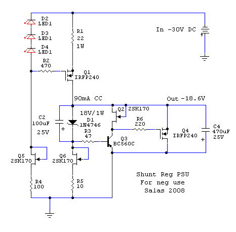

Hi salas,
After having built your HV shunt succesfully, I would like to replace a "dying" battery supply feeding a OPA627s line stage with your low voltage proposal.
I need +-18V but going through the thread I cannot understand which schematics should I use. For the - ve I think the one at post 309 is the right one but with the positive one I am at a loss.
Could you please help me on this ?
Yes, haven't had any further news from you for the HV shunt more than it was working. Is it in service yet? Having made the HV, you probably have some proper green Leds around.
So here is a LED CCS shunt symmetric pair for your low voltage needs. Those I have made in 2008's fall for someone wanting to power a symmetric supply capacitor-less B1 like the test one I have done in the Pass B1 thread, but with 317 regs. Since B1 does not care for little over 18V, but I guess OPA627 will not like 18.6V, I suggest you use D1=16V Zener 1W like 1N4745. That will give +/- 16.7V so to stay safe with your OPA.
