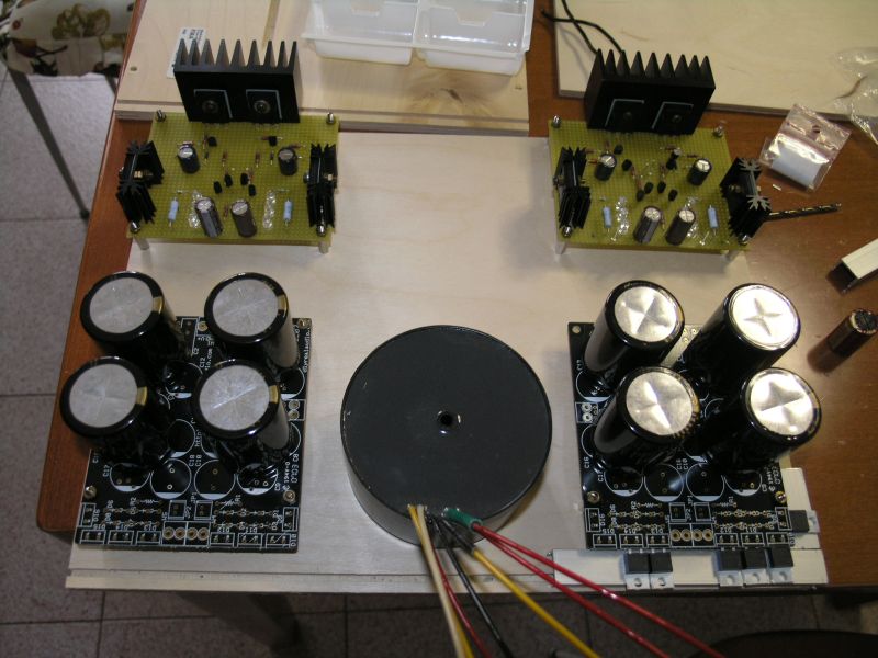

I'm finishing the layout for the quadraple shunts and because experimenting with zeners on the live circuit will be PIA, I'm wondering if there is a simple test circuit that could put together for that purpose. Any suggestions ?
Hello to you too.
You can simply use a 20V-24V voltage source (your psu plus side will do), and just with a protection resistor you can check the exact Zener voltage of each one you have.
P.S. Hey, you have promised pics when ready. Don't forget. 😀

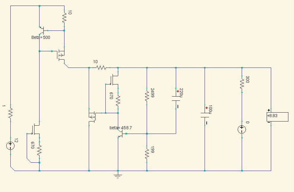

I do not have a sk170 model so resistor values will be different on CCS to give 3mA.
The mosfets are zvp3306a but I will probably build with zvp3310a.
Output impedance is about 7m ohms to about 1meg hz ( without the 10ohm resistor )
Stability is mostly governed by value of o/p capacitor and I will aim to avoid any ringing even on fastest transient.
The 10 ohm resistor is optional ( at least in spice ) but is a neat way to reduce open loop gain and increase stability if that is needed.
replacing the zener / LED with a resistor was just an idea that I will test - not sure yet how this will impact noise so I will experiment in this area.
I will also experiment to see how many of the upstream noise reducing measures I list above are needed with this design.
cheers
mike

I made a veroboard p2p version of the circuit from posting #67
I made the input CCS without cascode, though.
On my 2mV/div scope I can hardly tell if the channel is open at all. But I do get all from small to very hefty oscillations when placing the cap across R5 depending on its value and the chosen opamps. Slower ones like the op27 might put out a wrong voltage in this case. Apart from the cap issue the thing seems pretty stable, and a fast opamp like an OPA637 or a LT1028 works fine.
Rüdiger
