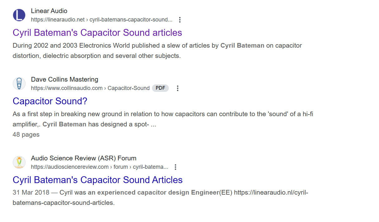

Google Cyril Bateman, he did a lot of work on that, documented in Linear Audio.
Or as Chris mentioned, work by Douglas Self in several of his books.
Sometimes you need to spend time to read and/or money to buy a book to really understand it.
You can also ask here but there's no guarantee that any of the answers make any sense.
Some do, but how do you know which is which?
Good info has a price, in time and $$.
The attached is the first page when Googling Cyril Bateman
Jan

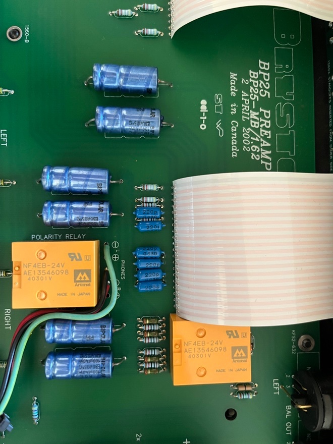

How can anybody give a sensible advice without knowing their function??What would you suggest for replacing these blue elco's? 100uF 40v axial bipolar.
Jan
